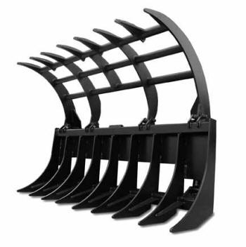

After doing allot of research and sending out some PM's, I've decided that what I want is called a Rake Grapple. They are not as common as the standard Root Grapples, Grapple Bucket or the Grapple attachements that you can add to your loader bucket, but they seem more specifically designed for picking up debri, branches and trees.
The big obsticle to overcome is dealing with the bucket that's already on my tractor. It's held in place with pins and the Rake Grapple will be on a Universal Skid Steer Quick Attach System. I spoke to guys at about a dozen differen manufactures and found that some really don't want to deal with anything other then what they sell already. But there are a few out there that don't see this as a very complicated issue and offered some options.
Skid Steer Root Grapples at ExcavatorThumb.Com was very helpful and real good at getting back to me with questions. They don't have the Rake Grapple on their website, but they do have them and he emailed me a picture of one that they make.
I didnt want the full sized grapple on the rake, but instead, the double grapples. Rob mentioned that it would be allot better at holding uneven loads if one side could close more then the other side. This made allot of sense to me, so that is what I ordered.
Total price with shipping for a 72 inch rake grapple with two grapples, quick attach hoses, pins to change my loader to a quick attach and a fork lift attachement with forks came to $3,600
While talking to him, I decicided that forks would come in handy and they probably are never going to be any cheaper then right now.
The order went in today. He said it will take about ten days to build it and get it in shipped off.

When I was at the auction the other day and played around on some tractors with 4in1 buckets, they all had the twisty type loader control handles. Twist the handle with your wrist to open the bucket. It's a little awkward, but I'd probably get the hang of it after awhile. Mine doesn't have anything like that.
My plan is to install the Universal Quick Attach plate to the end of my loader arms. Then I can add and remove attachments in just a few minutes. The grapple will already have the quick attach fittings, so it will be good to go as soon as I get the plate onto my loader arms. The pallet forks are just like on a regular forklift. They also attach onto the quick attach plate the same as the grapple.
My bucket will have to be modified to accept the quick attachment system. When it gets here, I'll probably just copy how it's done on the other attachments and then start cutting and welding onto my bucket.

The current thought from both the mechanics at New Holland and the owner of they hydraulic repair shop that I go to, is to have the grapple function replace one of the loader functions. In this case, for the grapple to close, the rake will not be able to tilt. One or the other will work, but not both at the same time.
The way I understand it, due to the large volume that this hydraulic system has, it's very expensive to install all the componts that can handle this. If I go too small, I create massive amounts of heat, which is bad. They said that by doing it this way, I just have to have a button that I hold down and the joystick contol will switch from tilting the bucket/rake to closing the grapples.
At first, I fought this idea, but after talking to each place twice, I see that this won't be that big a deal and it makes it a very simple install. I already have a button on the side of my joystick right where my thumb rests.
They said that the hydraulic preasure would keep the grapples closed when the button is released and the tilt function of the bucket/rake would return. So while I'm carrying the load to the burn pile, I'm not having to hold down the button.
I really don't see this as being all that bad, but it's also not my first choice in how to do this.
Eddie
