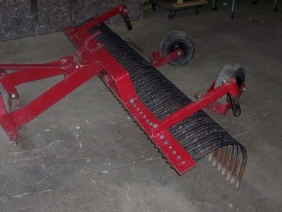

I said "probably" because yesterday I purchased this landscape rake. I is 7". Cat I, but pretty rugged. It is 3- 4 years old and has been used only twice.
Has guage wheels. I gave $300 for it. I guess from what I read in this forum, the wheels alone can cost this much, so I consider it a good buy.

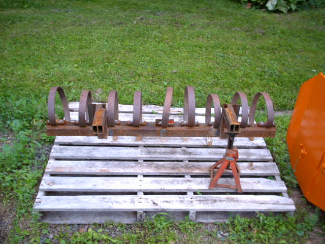

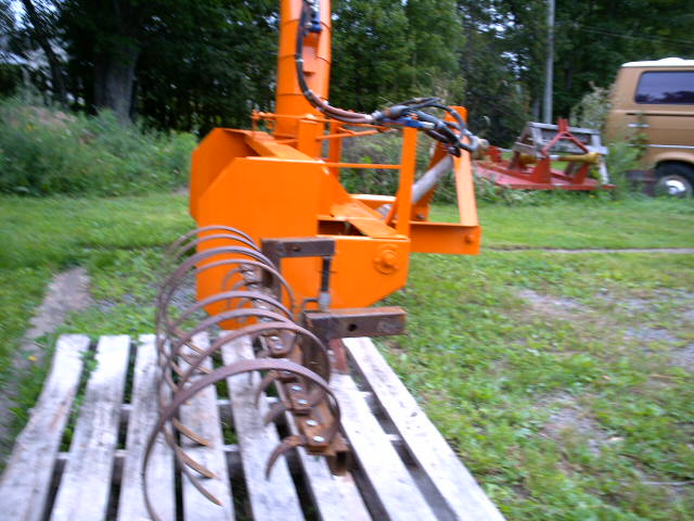

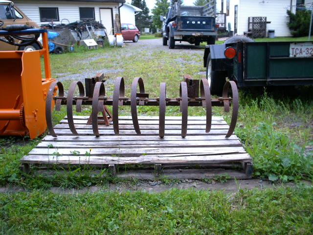

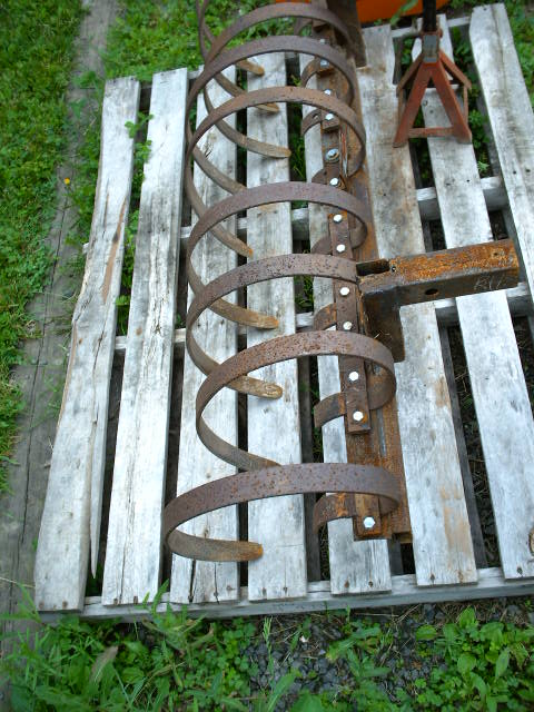

I think Schmism has the right idea re the angle of the teeth for what you want to do. The springtooth harrow was for ground tillage and it does a great job at that with the teeth at that angle. I haven't used mine a whole lot, and I haven't broken any teeth yet. I cobbled this up on a Saturday morning from an old horse drawn harrow that's been in the family for at least 60 years and it did have a few broken teeth. As Ron says, welding the spring teeth is probably a no -no.
Attached are 4 pics of my setup (nice paint job, eh?).
Your new landscape rake should do the job for you.
