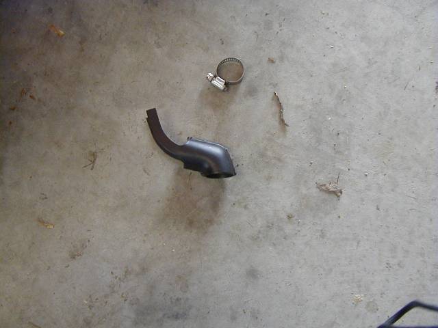

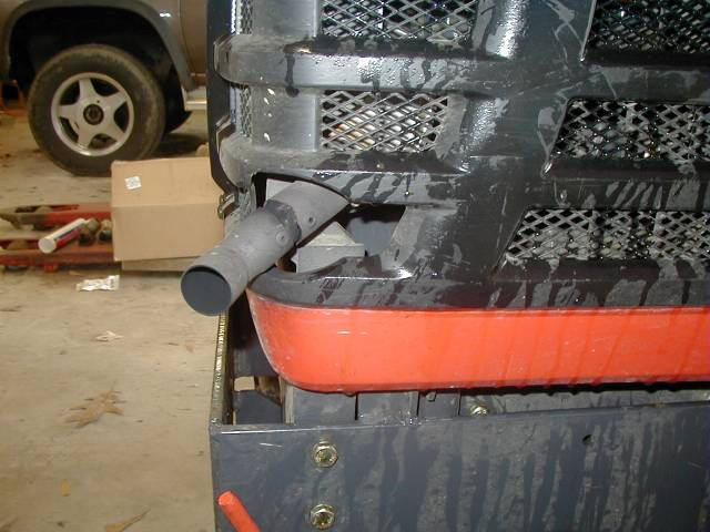

I copied this from another post on TBN, solution for soot on loader arms. It worked but the poprivets that hold it on would vibrate loose, so I fixed it.

   / Rainy day fix
#2

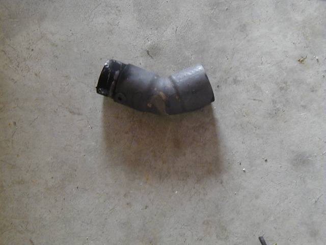

This is the old part after I removed it, just a short length of 3/4" copper tubing and a 45 degree fitting and steel poprivets

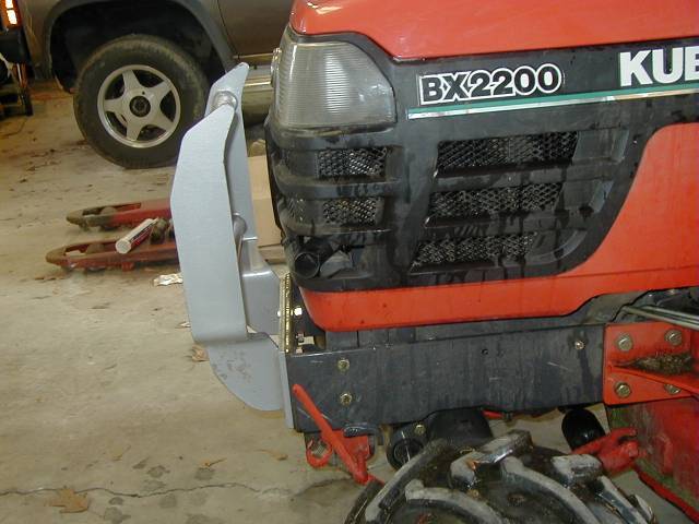

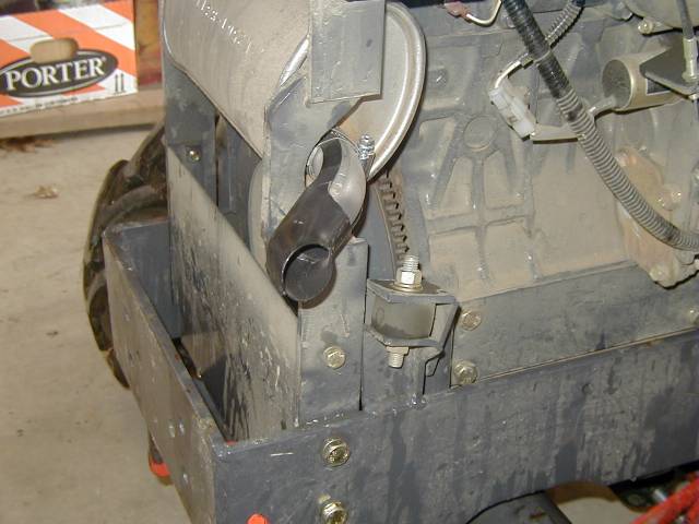

   / Rainy day fix
Here's the new part, these are on the BX22 Kubota, don't know why they weren't on the 2200.
Priced that part at my local dealer, (are you setting down) $48.00. I came by it as part of a deal for the BX grill guard at another dealer.
