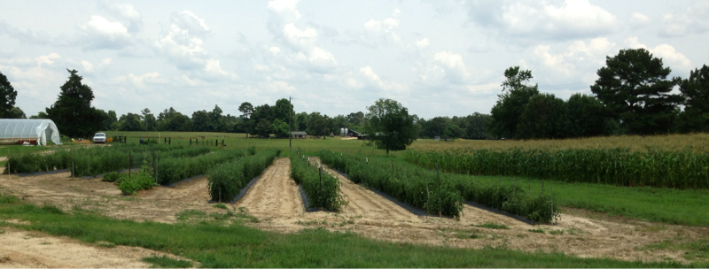

Yes disease is lessened with plastic. Pest can be too , silver mulch is supposed to deter aphids. I use black and ipm. I also like to skip a row with tomatoes. I till the tractor width skip and it lets air circulate better and helps keep plants drier and I feel helps lessen problems.
Moisture management- plants seem to be the most dehydrated in the morning, bed moisture is highest in middle of day. When heat is high moisture starts to come up and evaporate. Plastic stops this. We used an tensiometer or irrometer our first year. It's pretty neat.
There is no way I would want to go back and plant tomatoes on bare ground.
