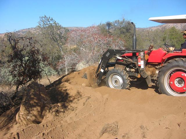

Just got back from my ranch and was able to make the adjustments as recommended. In incremental turns, I ended up one full turn in on the screw and it made a lot of noticeable difference.
I got a puff of black smoke when hitting the throttle and way more power when running in high gears. Under no load the exhaust was clean...no smoke. I was afraid to go any further since warned against doing so, but I ran the tractor under heavy loads for about 40 hours last week.
I was rebuilding a road and used the front loader and box blade constanly filled up with dirt. I have a Koyker 195 FEL that will pick up about 3000lbs (I think) and the boxblade is a 7 foot Howse, so when I had them filled up, you know that's a lot of dirt. The tractor never came close to overheating. Weather out here in CA is mid 60's during the day now. Colder in the mornings. But nevertheless, had no problems whatsoever with the adjustment so it should be OK.
The attachment is the road work I was doing. Notice the piles of dirt dug up and moved to this location. There was a steep incline in each direction and the extra power really helped.
Thanks for all the help and input.

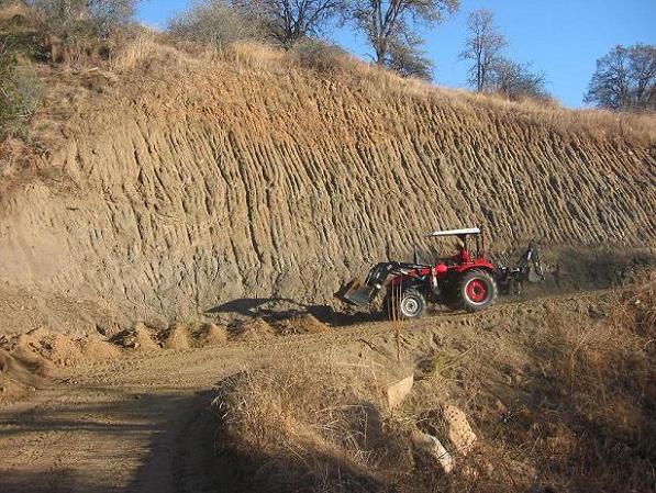

This is another picture while cuting and grading out a pad. I could have used one of those toothbars for the FEL to make things easier. But with the extra power, the tractor was able to cut and move a lot of dirt.

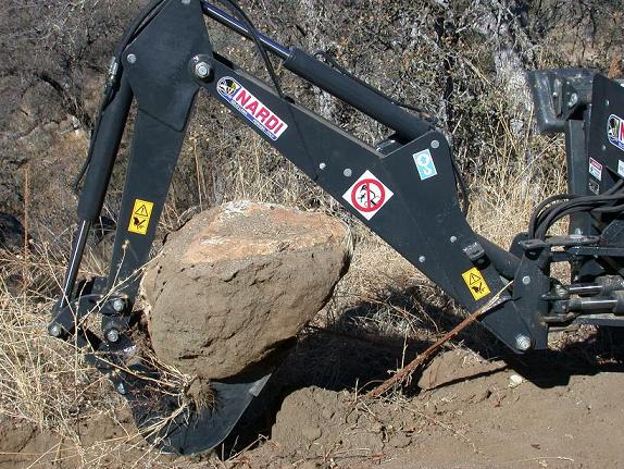

Even with the adjustment, my 554 does the same thing. It still bogs down in 4th on a slight grade but I have dirt roads so I only cruise around in 2nd Hi mostly, and cruise it in 3rd on flat stretches. Once I start working I'm in low gear range. 1st or second for loaded work and 3rd or 4th for backing up and in between. Interestingly enough, I can manage most all chores around 1200 rpm, very seldom have to get to 1800rpm and have never tried it wide open at the rated 2300 rpm....don't need to as yet. The only time I had to kick up the r's to 1800 is when backhoeing some pretty big rocks (for my hoe) and had to get the pump on th backhoe spinning faster for it to pick up the heavier loads. See the picture attached.
