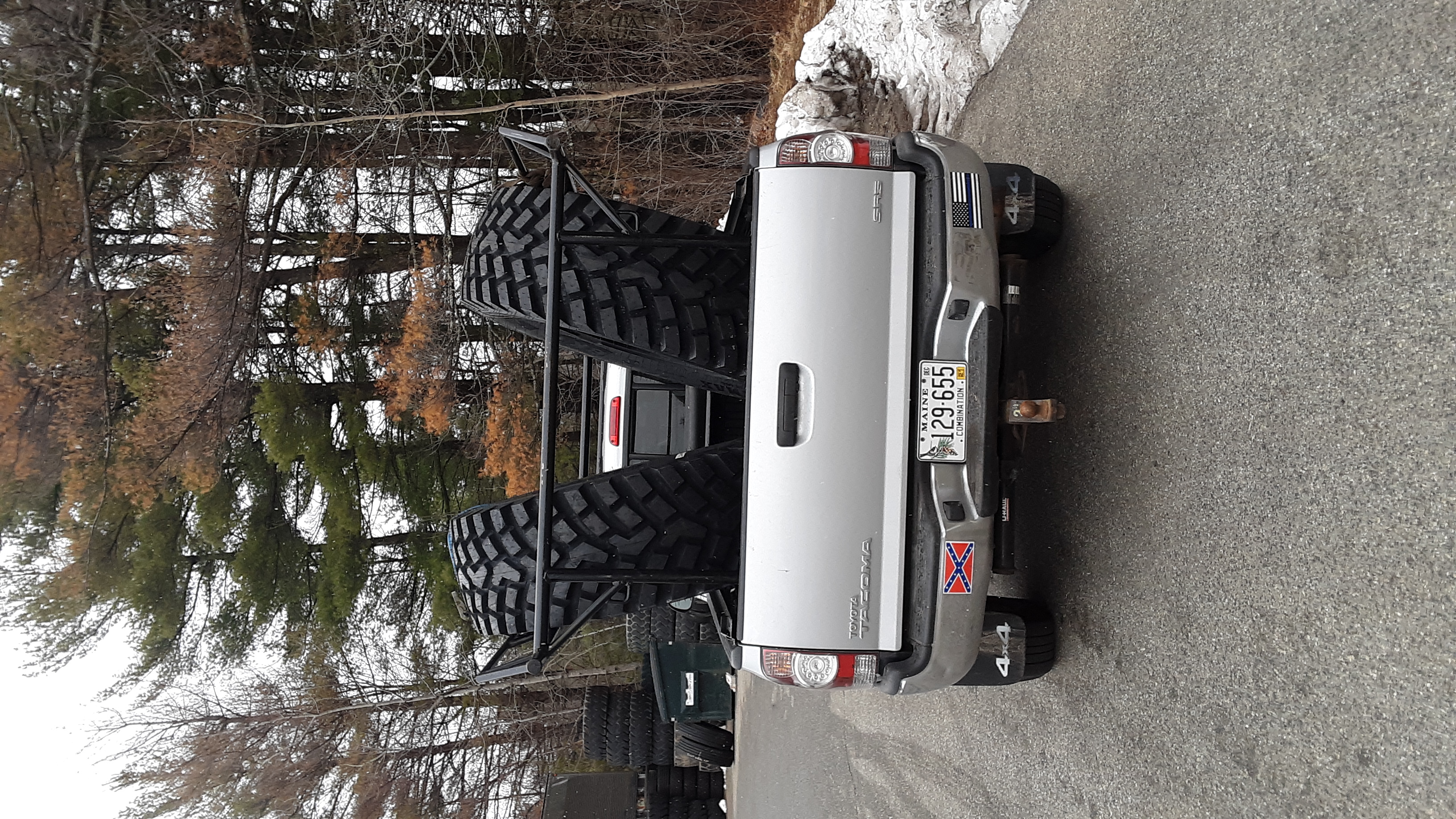

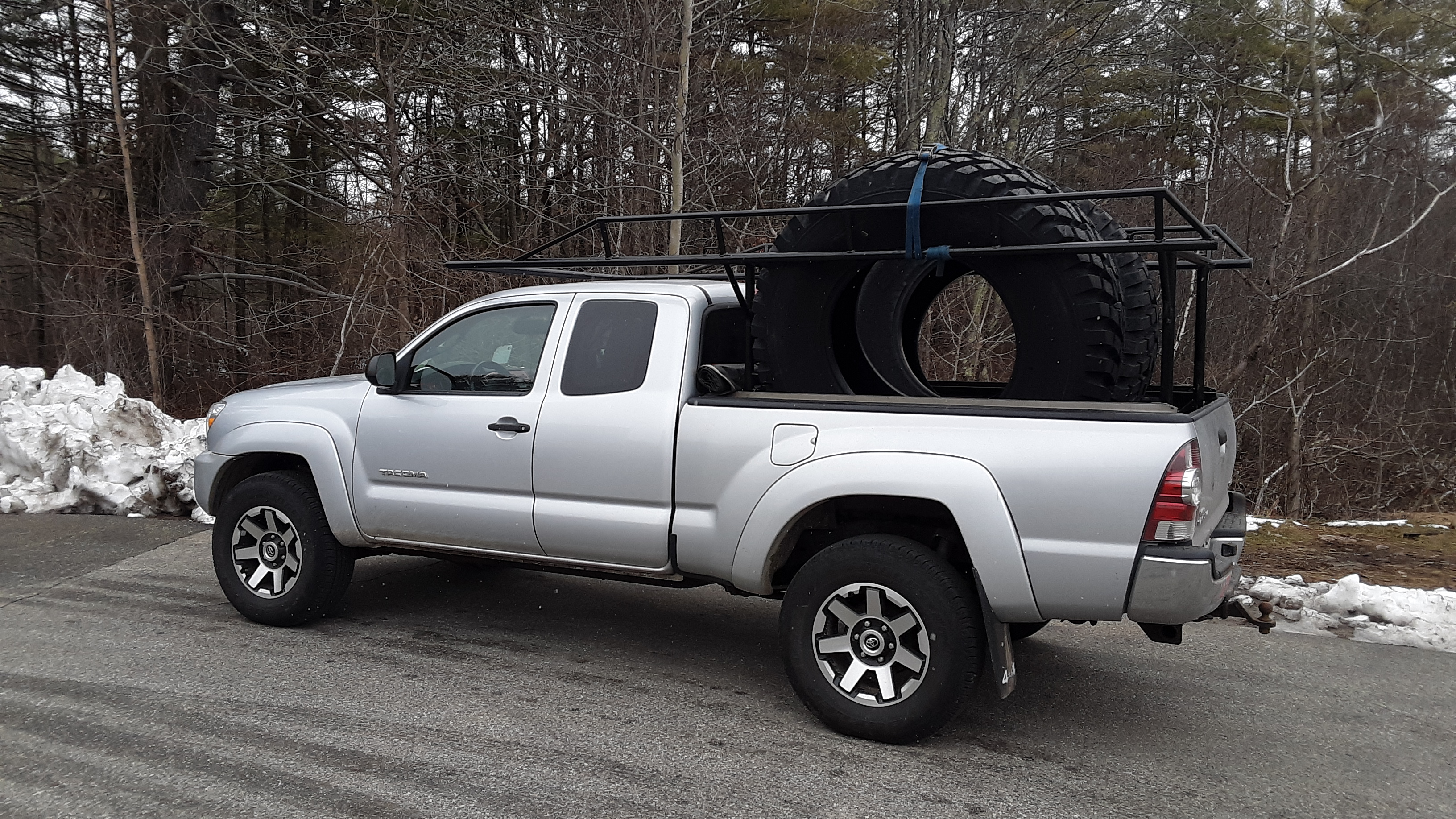

I just got these Monday, I don't know if they have a "r xx" designation but they are similar to the Nokian. I opted out of the actual Nokian as from what little information is out there, the Nokia seems to have a softer rubber and a narrow target of snow use. I've had a pair of this style on the front for over a year and I'm very happy with them for our soils (gravelly) and winter plowing along with the road ride and expected increased tread life.

Thank you. The Nokian Hakkapeliitta TRI, which seems to be the tractor tire that Nokian is known for, is a very snow oriented tire. They have recently come out with all season contractor tires, I think theyre called, but there is better priced, just as good options closer to home. If I had to guess, I would say that your tires are a R4 designation, like mine. Which brand are they?

They are BKT, a little over $1500 per copy:eek: for my size (18.4r30) The tractor came with radials and I'll never go back.

Duh me. I completely forgot that BKT had entered that market, even though, if my memory serves me correctly, they were one of the initial manufactures to that market. And, yeah, radials are the way to go. I have no clue why they only became factory on compacts within the last few years:confused3:, but there is a reason why all of the larger tractors come with them stock nowadays.
