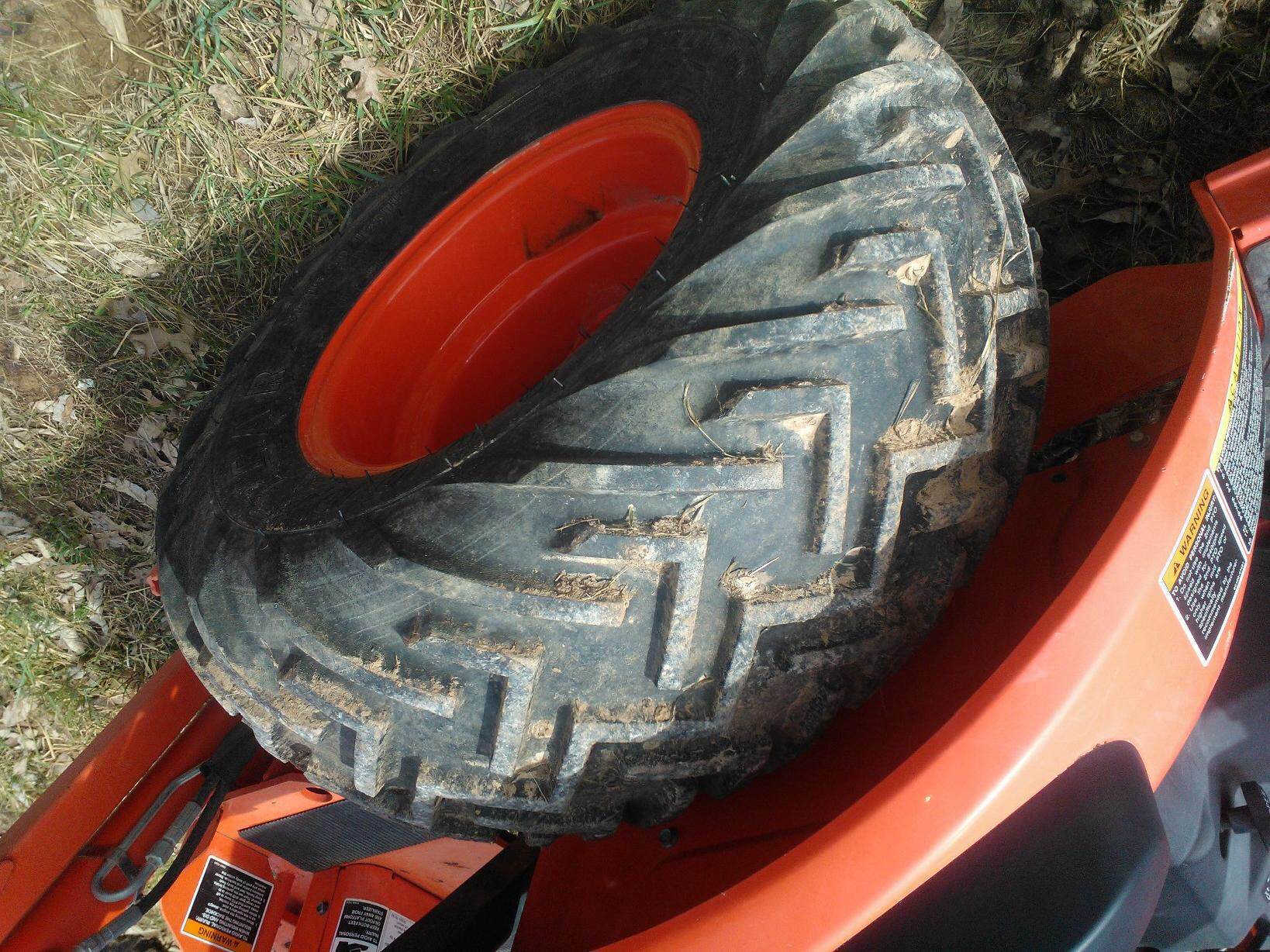

The "Bar Turf" I am referring to is the same tires I have seen on this site when others have discussed bar turf so I am inclined to think it is a proper example of bar turf...here are pics below. Weird pattern on the rear with a zigzag tread down the middle, and perhaps most importantly for better behavior when mowing a lawn, a much less aggressive tread for the fronts..it is a bit more aggressive than the turf but much less so compared to the R4.
Definitely interested in Varmint responding to confirm these are what he was thinking of when he said they are great in snow?

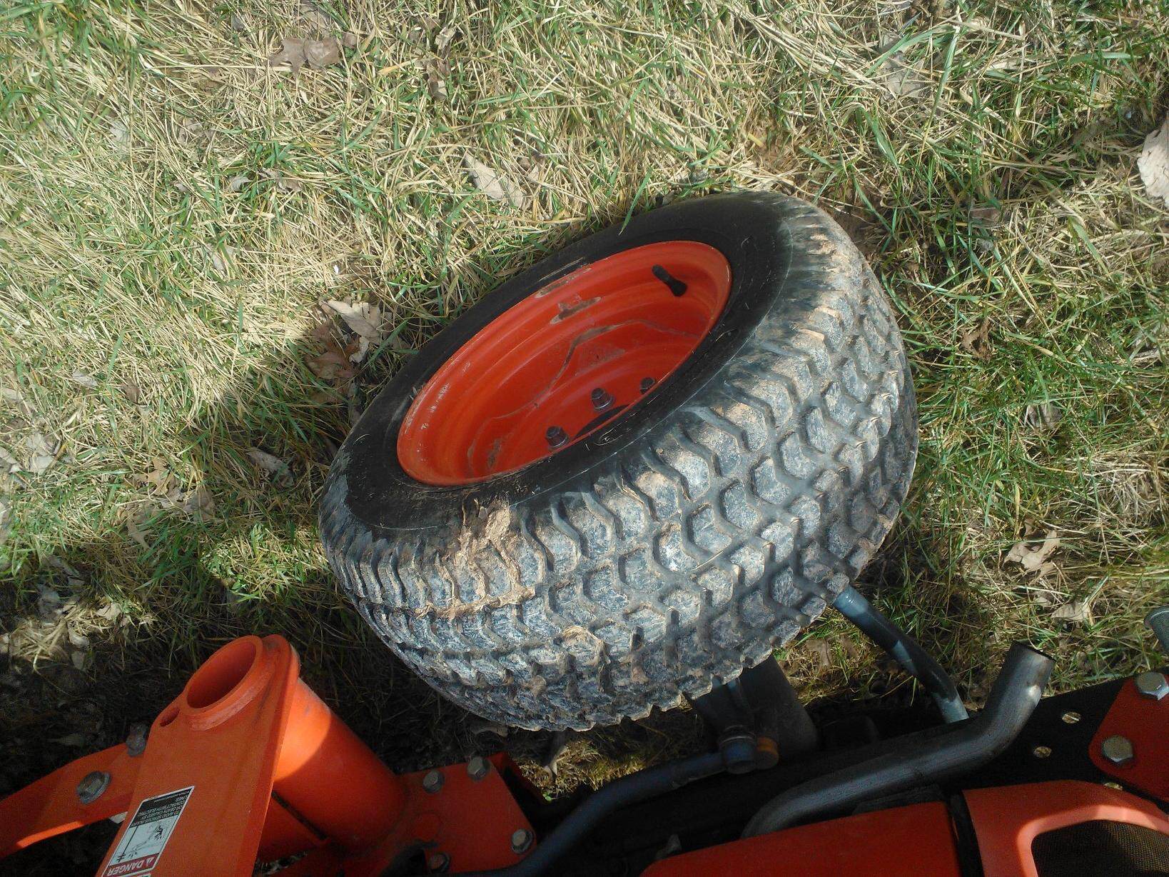

I was thinking of the center photo tires, "turf tires" which is more or less what I had on my B8200 and now on my L3400. Like threepoint said, great for grass, snow and rough ice. Your front tires are similar to my present turfs, front and rear. Not that it would help, but I can add a photo- sorry it isn't more clear on the tread. The photo of the chained tire is from the old B8200. I find I need chains when the packed snow turns into ice, especially partially melted, wet ice.
