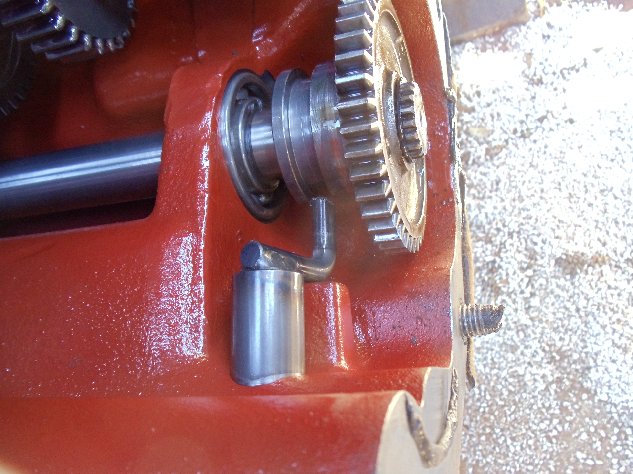

Has anyone had to go into the tranny on their 3644 to fix the 4wd gear fork or replace a broken selector shaft?
   / R3644HST broken 4wd #2

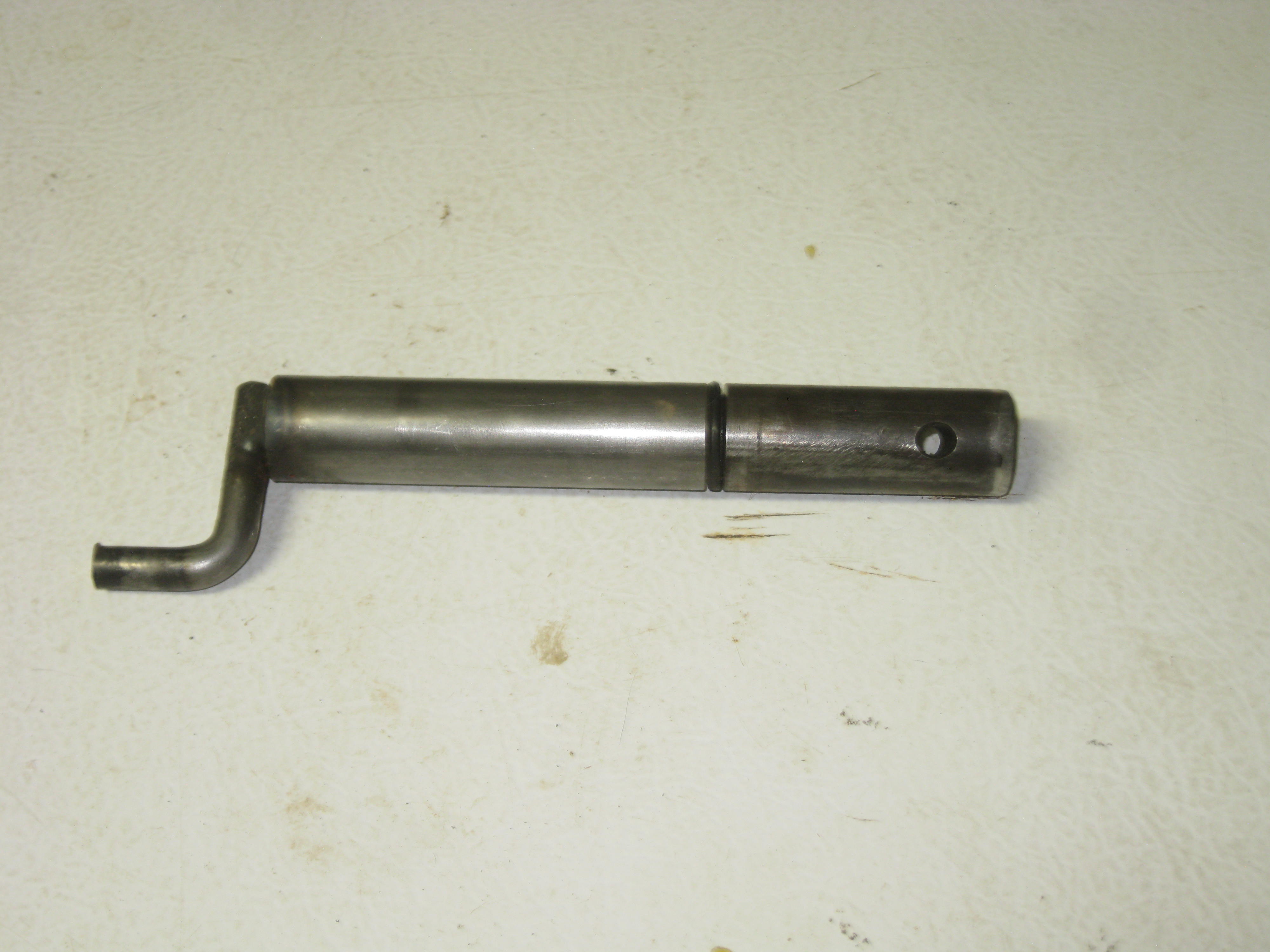

yes. the lever that slides the 4WD gear in and out wears off so that the 2/4WD lever just flops around and doesn't do anything.
in this photo the part has not been replaced yet and you can see that it doesn't extend into the groove. IMG_3637.JPG
Second photo shows the offending part removed.
