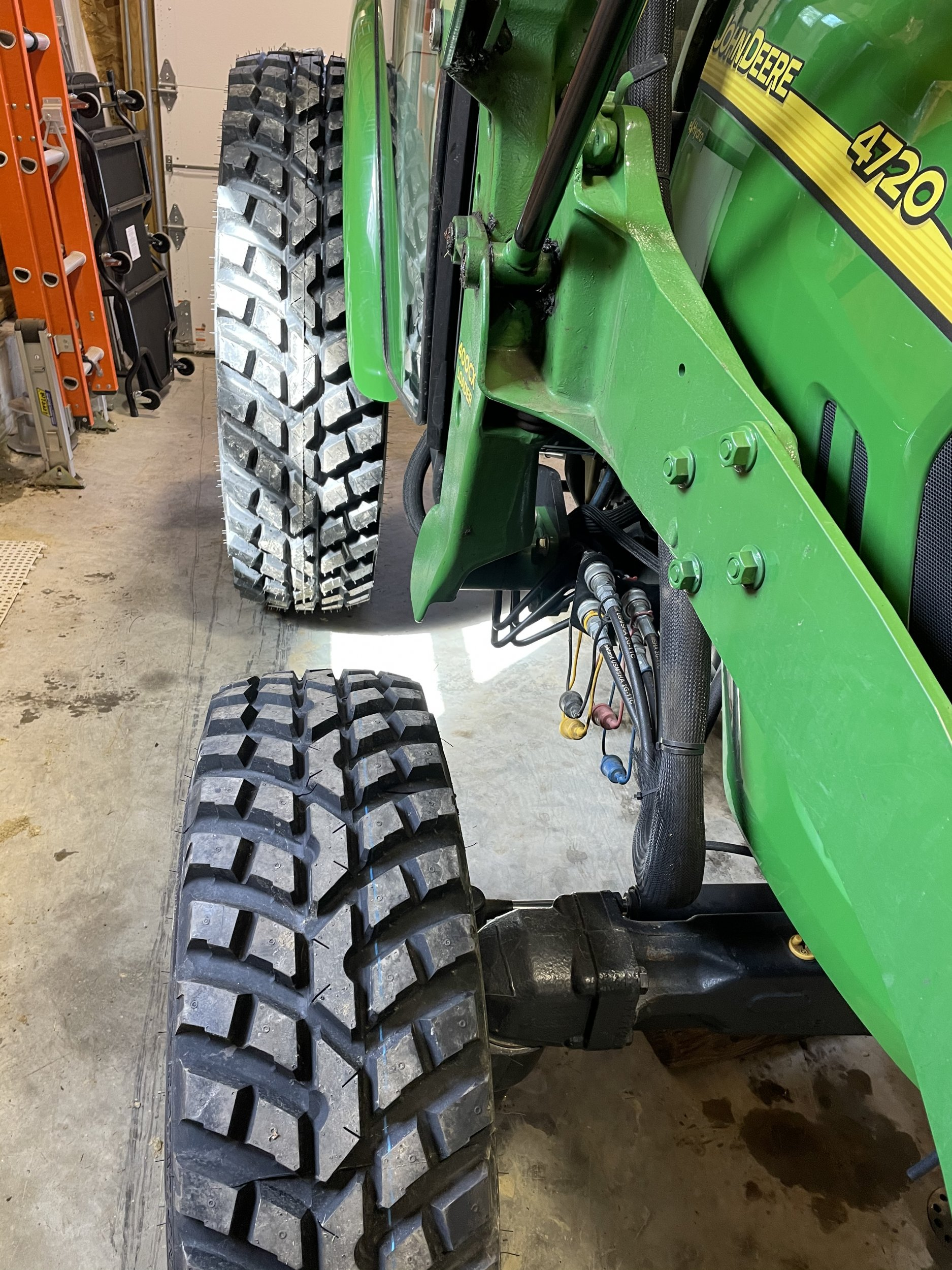

Still rather new but much better for my use than the R1’s it came with and it doesn’t rip the hell out of everything it drives over. Win win for me.
Cheap?? Hardly.
   / R14 ag tires #28
^^^^^^ nice looking tire
