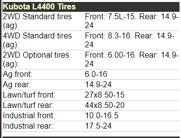

Ok, Here's what I found for the size industrials that would have come on it:
Where can I find info on the loaded radiuseseses of different tires?

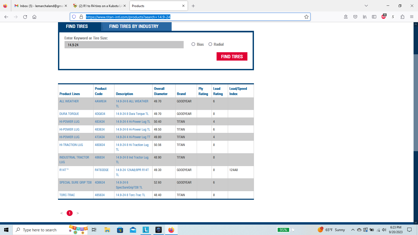

Most tire manufactures have a very good data table for there tires;
this link is to a Titan tire web page that has all of there 14.9-24 tires, R1, R4's and even R14's;
Products
a screen shot of the page, clicking on an item in the left column will take you to a detail of that tire,

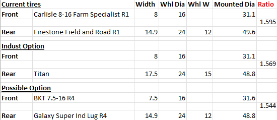

To match existing 4wd internal gearing you want to match the existing distance traveled by the front and rear tires. To do that, the spec you want is" loaded diameter", not loaded radius. For oval shapes - not circular - these loaded diameter & radius are entirely different types of measurements, not related, & used for different reasons.
Most of the online tire catalogues will list loaded diameter.

So, keeping the ratios of mounted diameter the same won't keep me out of trouble?
   / R1 to R4 tires on a Kubota L4400? #9
Well, that's yet another spec.
My guess is that "mounted diameter" would be measured with no weight on the tires.
We are just guessing now, and nothing wrong with that... but my guess is that keeping the front to rear "mounted diameter" ratio the same for the new R4 as it was for the old R1s would be better than not paying attention to the ratios at all.
I assume you are going to do fronts and rears both... and that you already have figured whether the swap will require different wheel rims on both ends as well as tires. I've done a couple of swaps now.
Easiest thing would be to swap with another owner wanting to go the other way. I really like the tougher R4s. Also, R4s run higher pressures than R1s. So it is a stiffer sidewall running more pressure and with a larger wider footprint. More stable on hills, with noticibly less traction in snow and mud but more traction on hard pack dirt and in the rough.

I'm thinking with the following choices, I could maybe do front and back at separate times and be ok...especially if I use 4x4 sparingly on loose surfaces. The rocks where I live take chunks out of the tires, so I'm thinking more rubber contacting the ground, lowering contact pressure, might be a good thing.
