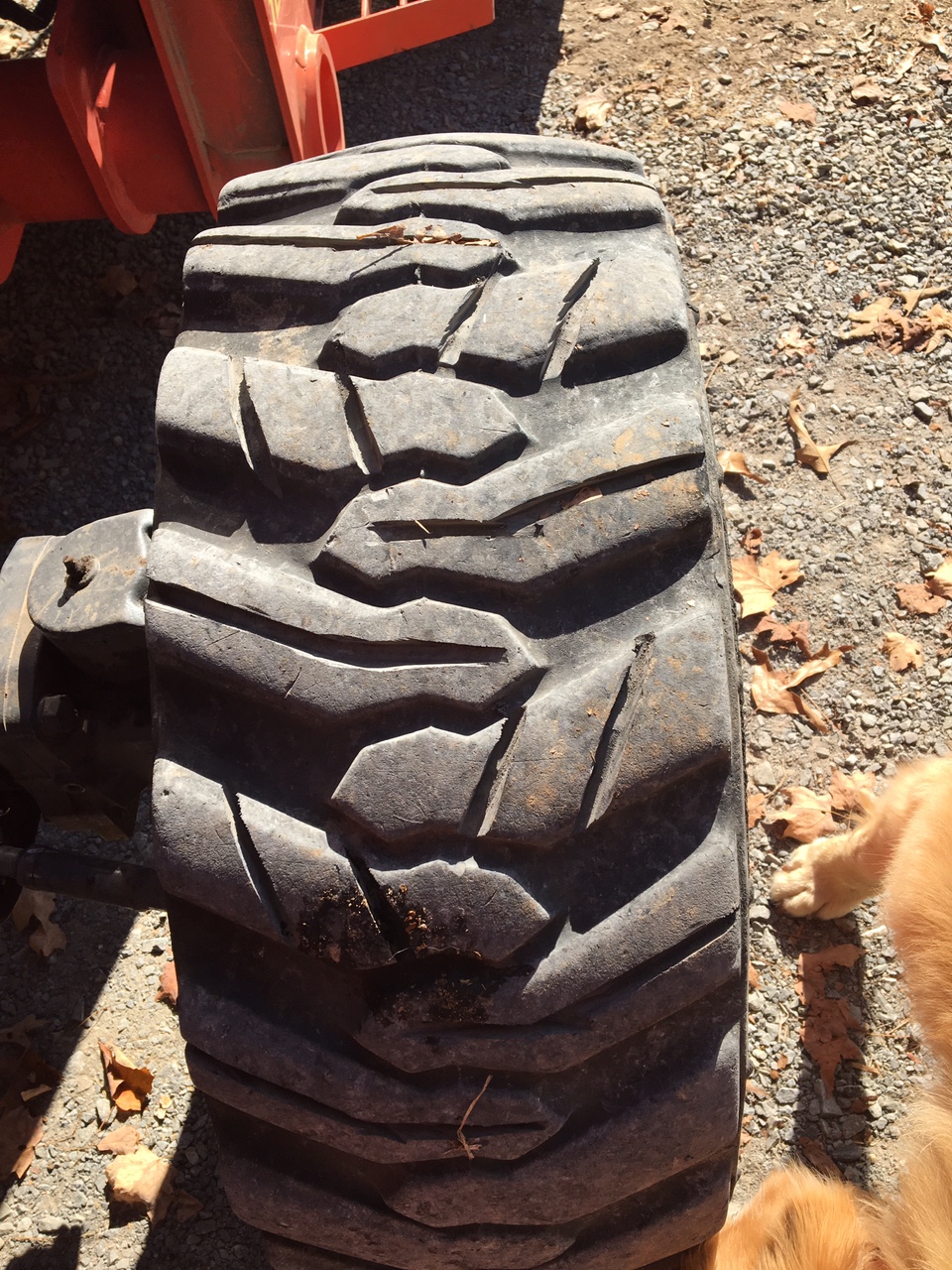

Playing around with grooving R4 tires to improve traction. Better in snow, lawn and pasture. DIY R14.

View attachment 592316View attachment 592317
Great job Smokey!! Those grooved fronts look a lot more useful than the R14's to me.
Seems "hybrid" tires are all the rage lately. I see a lot of pickup truck tire manufacturers over using the "hybrid" term and coming out with all types of interesting if not useful tread designs.
The UTV tire market is always coming out with some new super design that looks more like splitting hairs than anything really different. There is a UTV tire that looks very close to that R14 tread pattern.
The first true "hybrid" tire I saw was the Super Swamper Thornbirds, maybe 30 years ago, so the idea isn't new. I ran a set of the 35's on a 71 Ford 4x4. They were great tires on and off road.
Oddly enough over the years a lot of people have scoffed at the Thornbirds multi pattern tread. Now everyone seems to be looking for a dual tread pattern tire.
If I was looking for something like that I would groove my R4's and be done with it.
