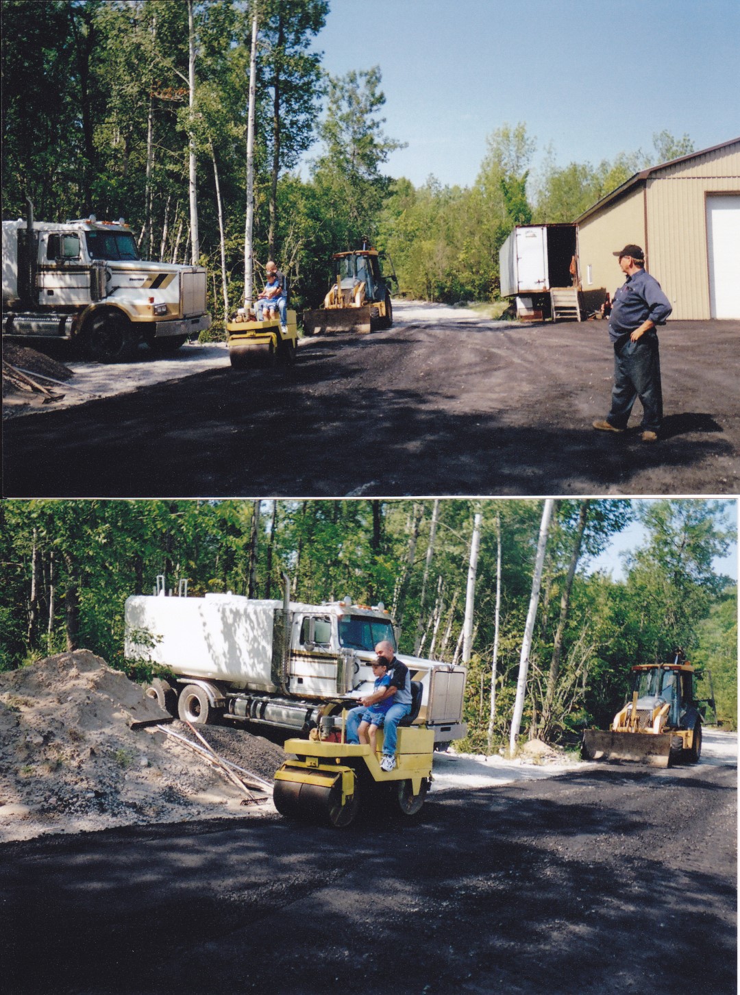

Found a pic with the water truck and roller.

I have a equipment lot of sorts at my place. Maybe 100’ x 200’ just guessing. It has been used as this for many years and the ground is packed solid. No real pothole or rut issues. I put a 3” layer of crushed material on it originally and it worked fine for a long time but was wearing thin in places. I added 3” of asphalt millings in the dead of summer, leveled it with a laser machine controlled grader and rolled it three times in 100 degree sun. It originally set up like a street. You could bounce a basketball on it and not tell the difference from a street. I was so happy. This was last summer. Our semi, trailers turning, and worst of all our rubber tracked machines have destroyed it. It was falling apart in so many places I just grade it out like gravel now. It has zero cohesion anymore. Maybe on a straight road that no one turns sharp on it would work better. I will say there is very little dust and it supports things fine but it looks just like gravel.
1/2 mile of road can be graded in no time especially if you do it frequently before it gets bad. That expense of the paving would sure cover a lot of grading. I have pretty much given up on making my area robust. I instead made a drag with a chain harrow and some pipes that I can pull behind my UTV. I try smooth it out weekly if we are driving a lot of things on it. It takes maybe 15 minutes to do.

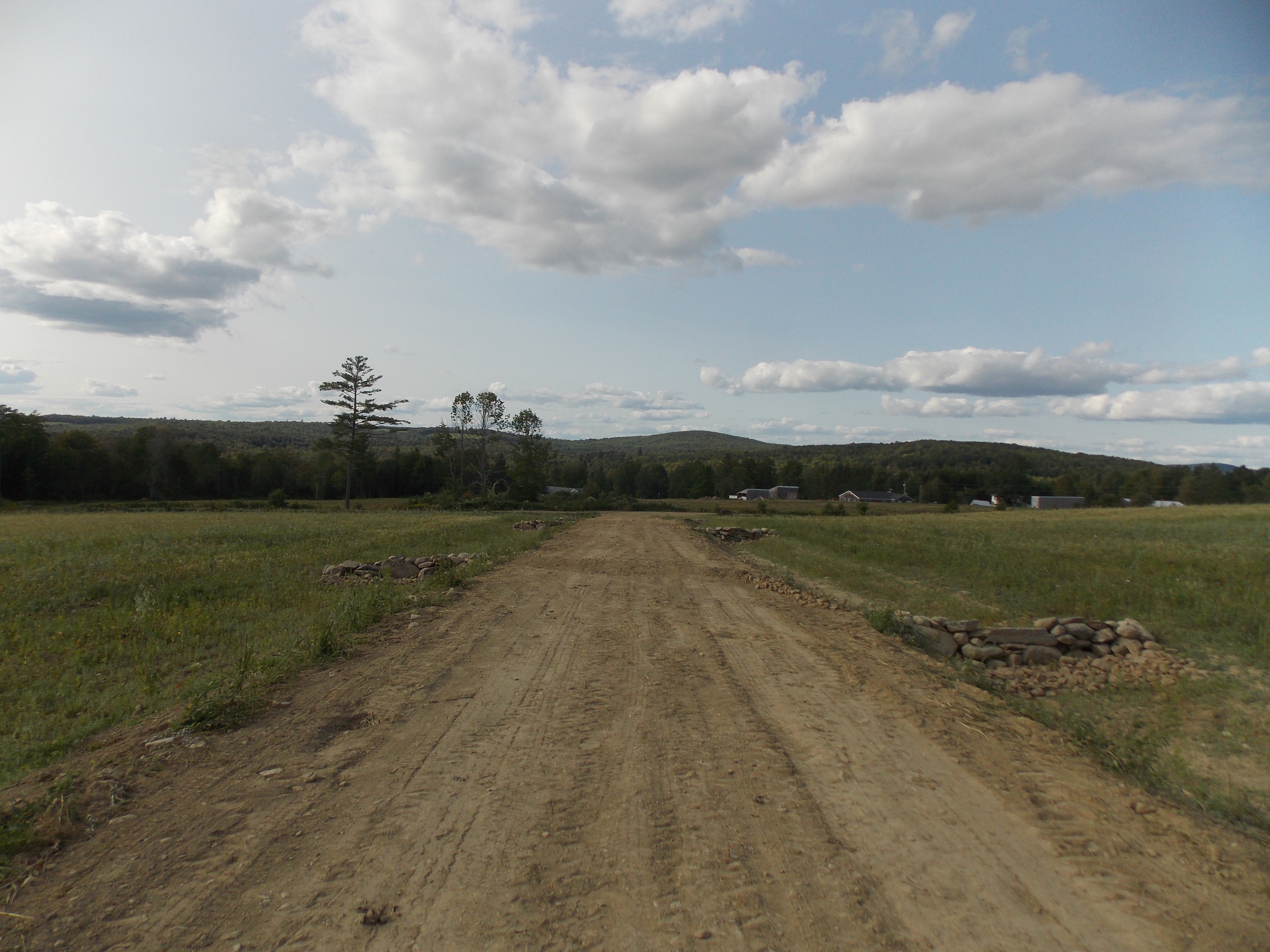

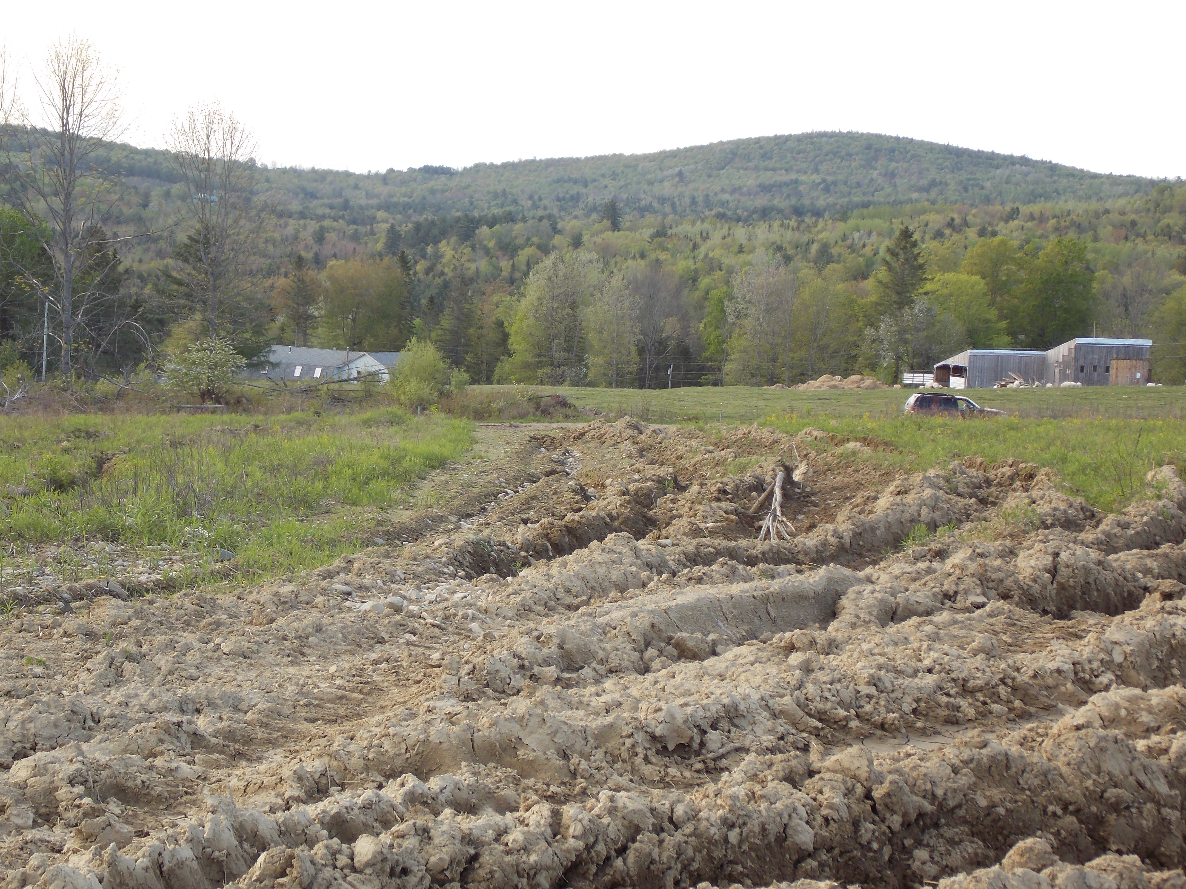

Pot holes form when water is sitting on a gravel roadway, and in wet weather, traffic pounds into these pockets of standing water. That tells me you have more issues than just a sandy gravel base, it tells me you lack a crown/inslope/outslope to your roadway. That has to be established first, just putting down hot-top grindings is not going to be the silver bullet, and paving it means the pavement will break up in very short order because the base is messed up.
Always start with drainage. Do culverts need to be placed in the worst locations to keep the water moving from one side of the road to the other? Ditches made? Ditches cleaned out?
Once that is addressed it may be time to think about geotextile fabric. I hate the stuff, but I do not have sand so I can fortify my heavy haul roads with rock. With sand geotextile fabric will do wonders because it will keep your gravel from mixing into your sand. Again, you probably will not need to use it along the entire roadway, but just in the problem areas.
Once those problems areas have been dealt with, it is time to take a long hard look at the roadway. Most likely, years of maintenance have meant the crown of the road has been taken out, or there is crown where inslope and outslope should be and it is not there. There is no one size fits all for road surfaces, they can change from crowned, to inslope, to crowned, and then outsloped and back, or any combination thereof. Just be wary of outsloped roads if you live where there is snow and ice a lot, and the road is 4 season. Still, getting that water to shed off the road surface will go a long ways to preventing potholes in the first place.
Written down, this probably seems overwhelming, but I am sure you only have a few problem areas. Most of the time pot holes come about the entire length of a road because people have a box scraper and drag the living crap out of their roadway. Sure it fills in the pot holes, but takes the crown out of the road too, making pot holes form quicker, so they scrape it again, and soon they have pot holes all the time. It is a vicious cycle. Getting the water off the roadway as soon as possible is what stops that, so crown or slope is critical in a road.
Here is a after and before picture of one of my Heavy Haul Roads, showing proper crown. This was done with a 2500 Kubota Tractor and a dumptrailer, so it does not take a lot of specialized equipment.
