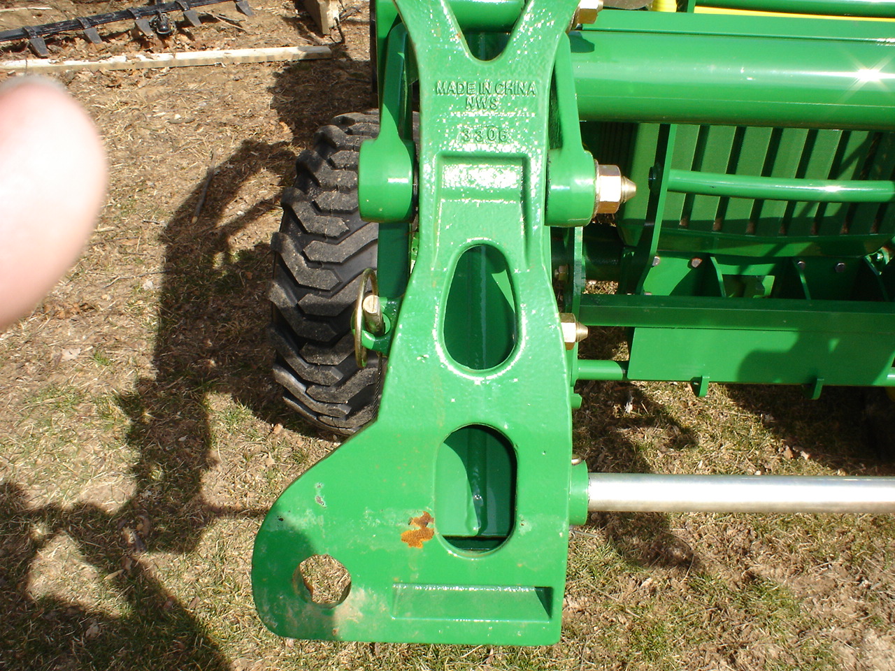

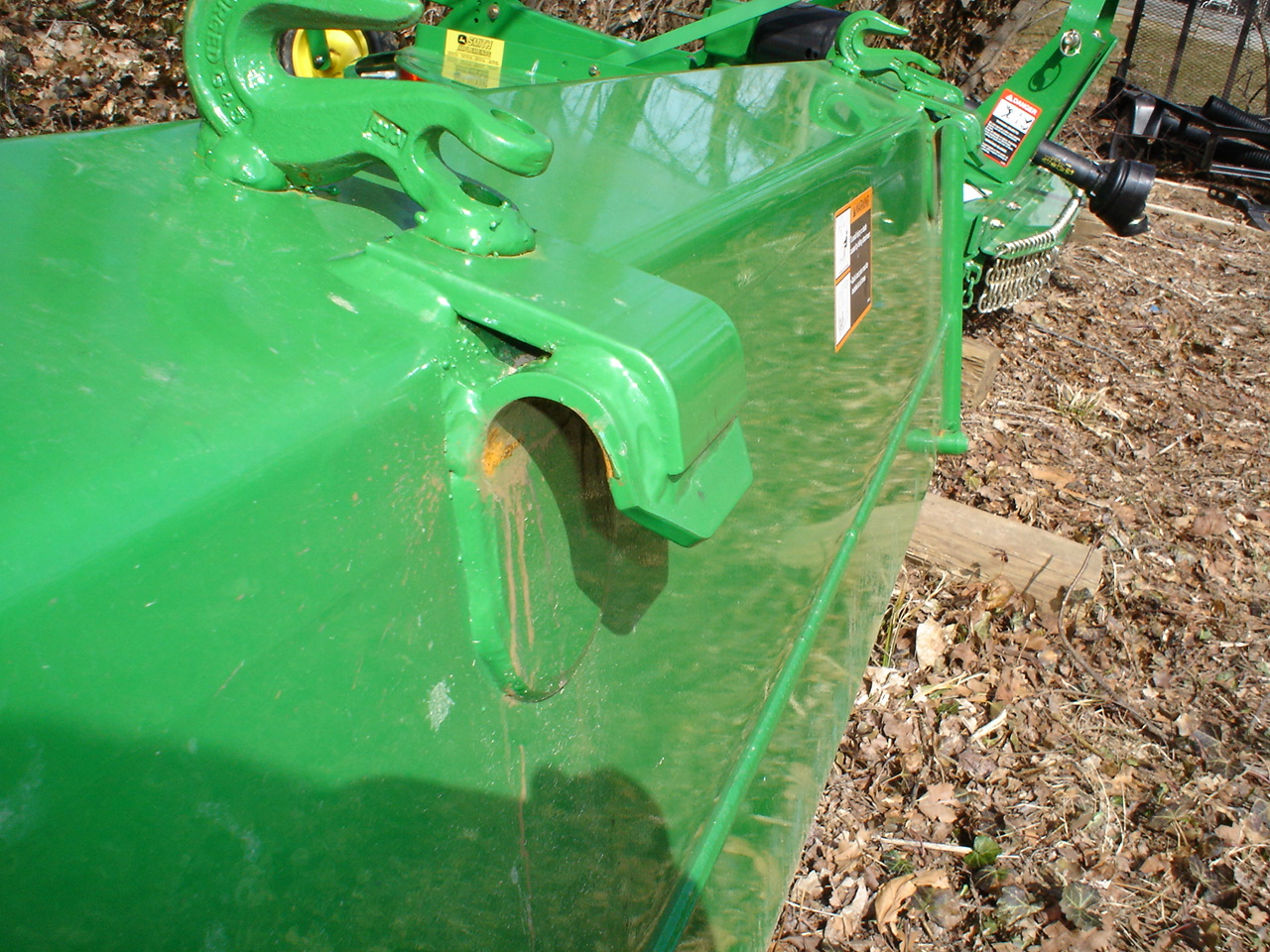

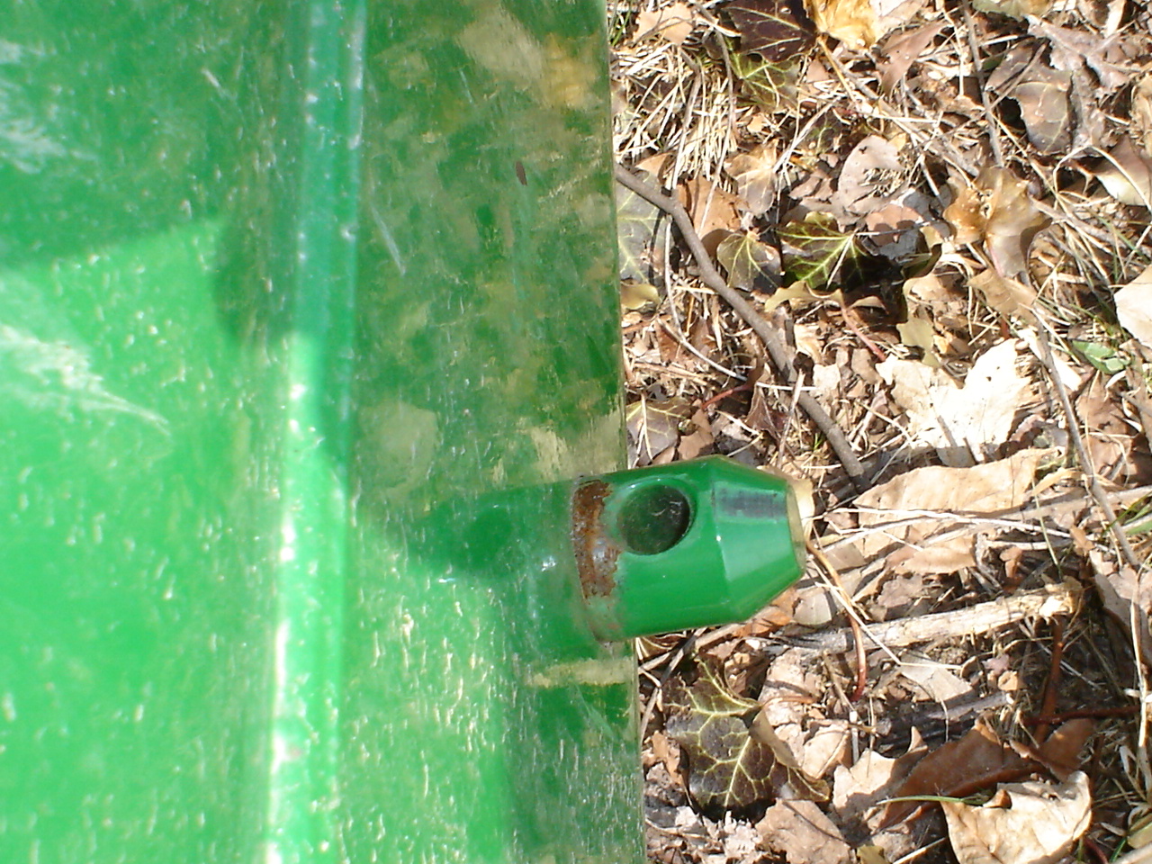

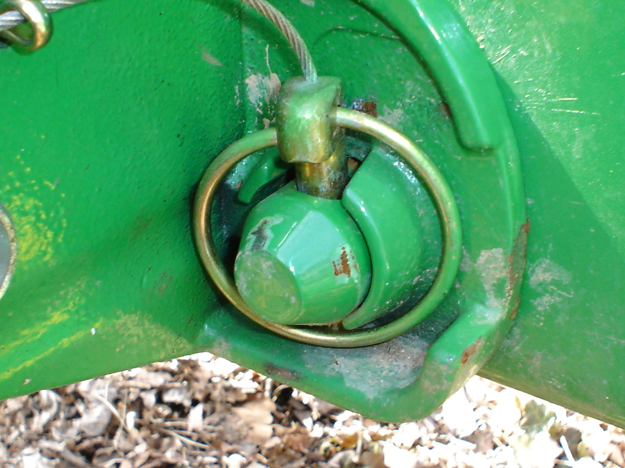

Here are 4 pictures of my 300CX FEL. First 2 cover the bucket's upper holder and lower locating pin. The second 2 show the FEL lifting bracket that mates with the upper holder, and a shot of the locating pin fully locked into position. Hope this helps you out.
Please - no snotty comments on the poort chain hook welding job.....I've already been down that path with a number of experts.
