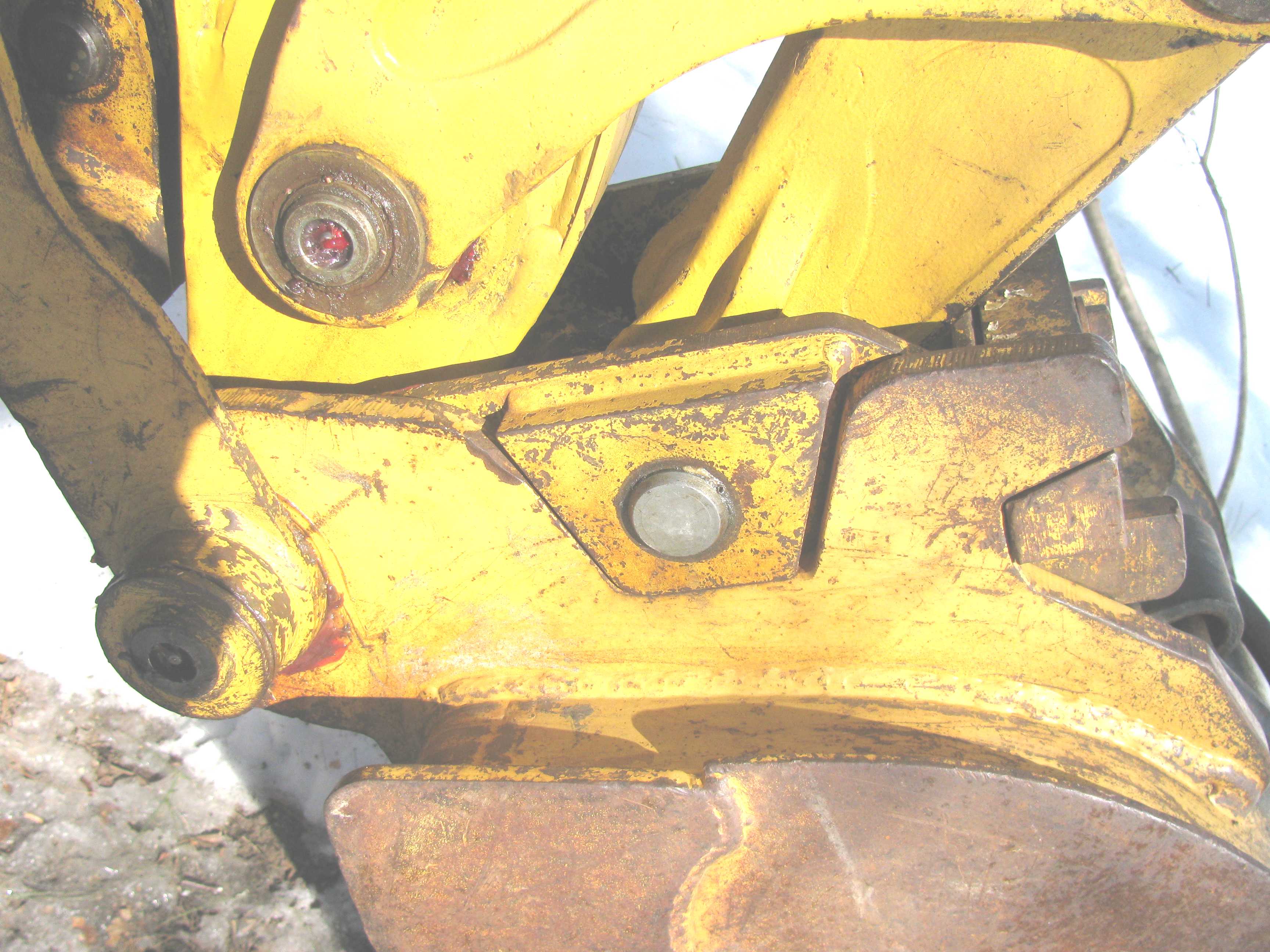

I built a quick coupler plate for Curly Dave to use with his hydraulic auger at the time and it was made for the new style plate. All of this was long enough ago that used buckets should be available to fit your machine. Can you post a pic of your quick attach plate from the side view? Measurements would help too.

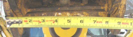

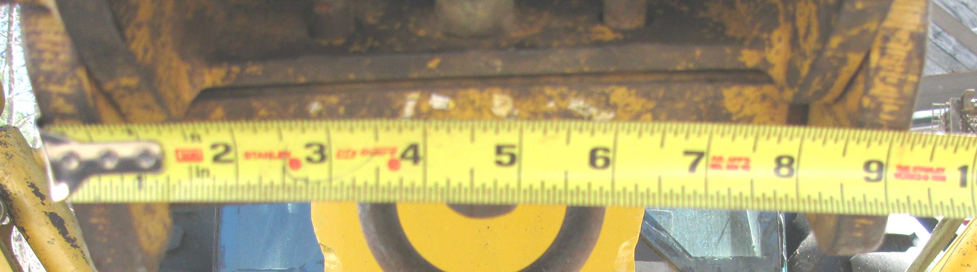

The width between the plates was the issue. The width between, respectively, of my coupler and existing bucket varied by approx. 1/4" from the 35D. The 35D was wider. Thus, the "U" shaped ears would not fit between the washers of the pin holding the adapter and the thumb. The party I sold it to had another brand Excavator that he was retrofitting a JD quick tach coupler to. He purchased it from Hunt Tractor in Oregon. His coupler measured likewise 1/4" wider than than mine. Thus, the bucket worked perfectly for him.

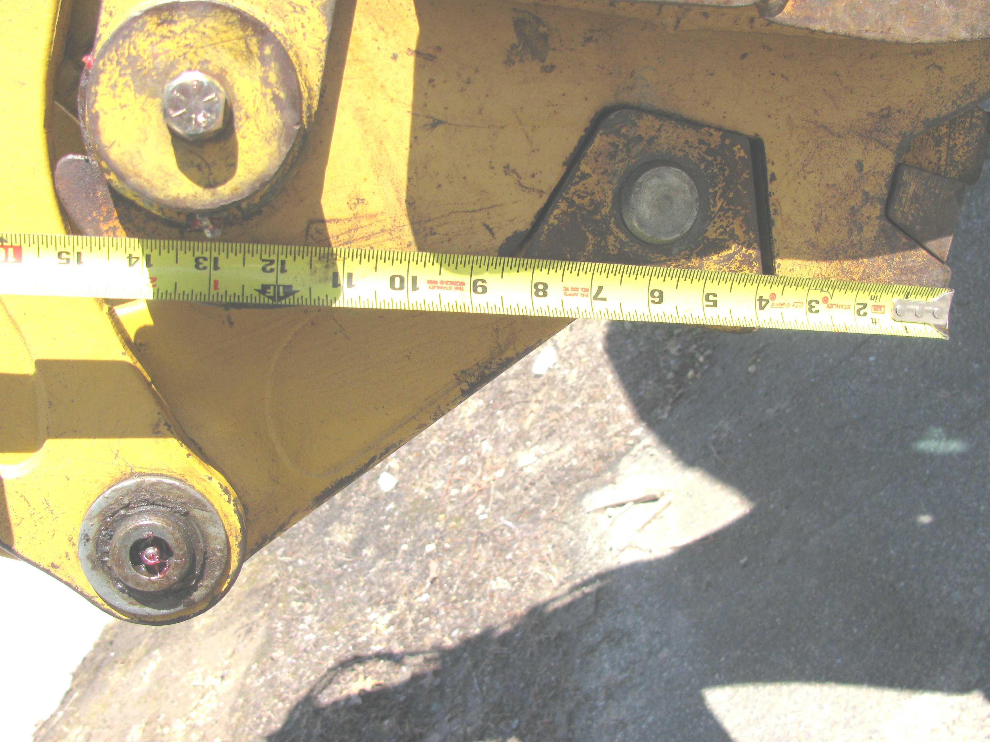

Images with reference tape measure.
