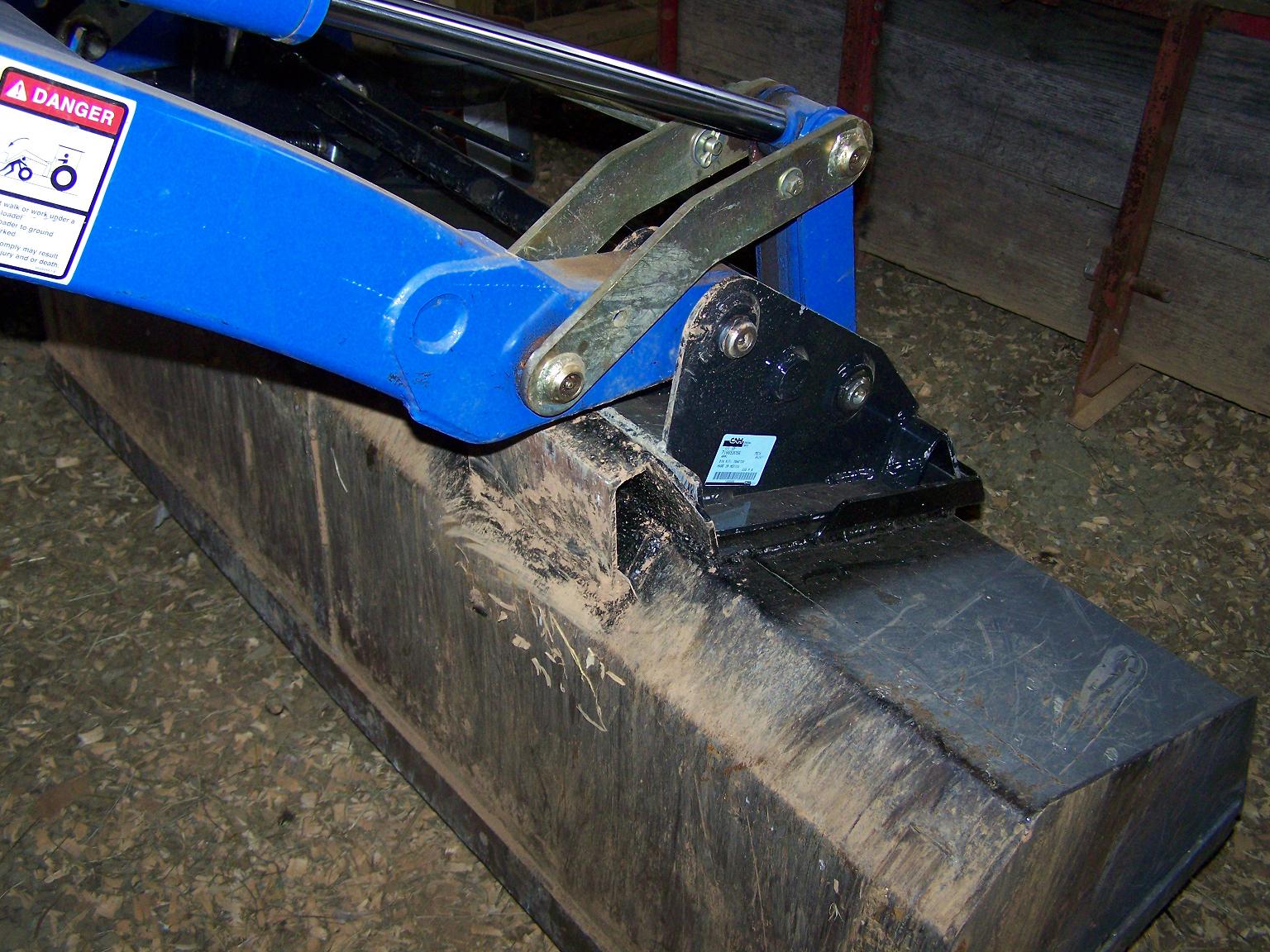

I looked up the part number on NH parts page. They only list one QA kit for a 16LA loader. Nothing about light or heavy duty. The part number given to you by our member is correct, as far as I can tell.
I would guess that they may have been refering to the plate that you need to weld on the bucket. They come in different styles and weights. As I stated earler I paid $133.10 for my plate (1/4 in. thick). I don't think that you could ever damage it with a 16LA loader. You can get heaver plates 3/8 thick if you want, and still not reach the $1100 total cost they quoted you.
I may be missing something, but I can't find anything that supports what you were told.:confused2:

I took another look at the parts listing and found this:
Part Description Mount
Part Number 86605906
Price $799.85
Maybe this is a heavy duty unit???:ashamed:
I checked the part number on my QA (the sticker is still on it) It reads #716653056.
I don't think you would ever have problems with this unit. It appears to be plenty strong for the capacity of the loader.
You could call your Dealer Parts Dept and ask about
Part Number 86605906 and see what he says.
Bill
