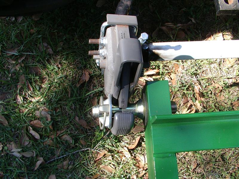

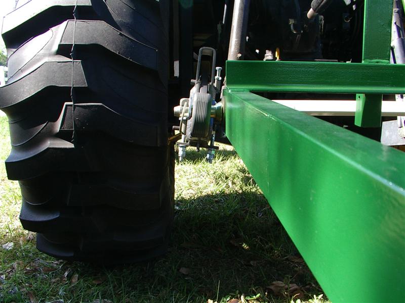

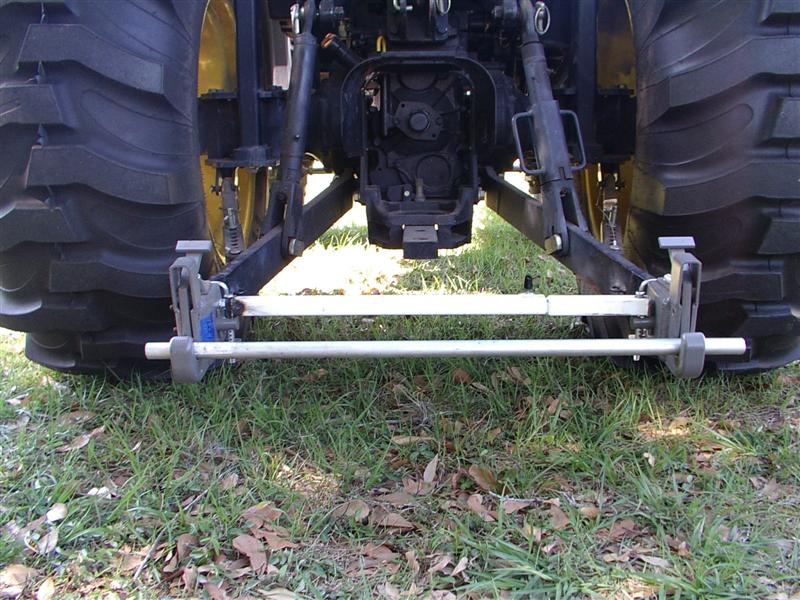

I have a QH and a set of the PEC. People here seem to be loyal to the system that they own (if they do own one). I definately prefer the QH. I did a post on how I was able to make my QH overcome the problems that I encountered and believe are universal to the majority of other owners. http://www.tractorbynet.com/forums/attachments/146379-3-pt-quick-hitch-solution.html The PEC is a very well built system and a design that has made many people happy. I just changed the outer nuts to nylon locknuts after them continually coming loose and losing them and the allen rod set screw inserts. As you can see from the pictures, I set the arms on the EC as told in the directions and the implement is squarely on the hooks. Notice when the implement changes position, less and less of the implement pin is supported on the EC hooks. The balls are unable to swivel in the arms as the implements change position. I don't know if this should be a concern or not. I know I can set the hooks level for the raised position, but then we have the same issue when they are lowered. I just am concerned that this may put an inward torque on the 3Pt. arms that they are not designed to be subjected to. Now you can debate with each other on the physics of this, but it just doesn't look right to me. This is only what I feel and many people swear by the PEC system. It is a very good option for the folks who can't or dont want to alter their non ASME implements. But I will continue to use my QH as I don't have to even hook up the top link with it and I believe it is structurally the better option.
