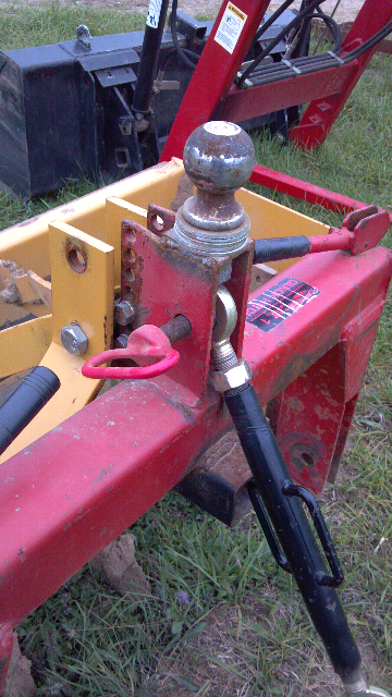

yes I welded a plate to the top of the top link adjustment brackets with a hole for the ball. then screwed ball in. used some washers to space ball out to where the ball shank does not interfere with my top link. I can get picture tonight if I remember. I also welded receiver hitch to mine. no need for one of those trailer mover things. just take the hitch out and clip into your attachment. I can even leave a hitch in when using my box blade.

looks bad in the pic. I need to get it cleaned up and painted now that the testing phase is over. will replace washer stack with 1 big 1" thick washer, I need those back for my snow blade shoes, lol. I should also note that I have not had any pto shaft interference with the receiver hitch placed in the center or the quick hitch. the only way to get it to come close is to shorten the top link past where it should be for the implement in use while the implement travels over a dip or hill crest causing it to be lower than the rear tires. this would vary depending on the pto output shaft location on your tractor. I use a 6" drop hitch and it easily gets low enough to move all my trailers.

looks bad in the pic. I need to get it cleaned up and painted now that the testing phase is over. will replace washer stack with 1 big 1" thick washer, I need those back for my snow blade shoes, lol. I should also note that I have not had any pto shaft interference with the receiver hitch placed in the center or the quick hitch. the only way to get it to come close is to shorten the top link past where it should be for the implement in use while the implement travels over a dip or hill crest causing it to be lower than the rear tires. this would vary depending on the pto output shaft location on your tractor. I use a 6" drop hitch and it easily gets low enough to move all my trailers. I also have a hay spear to stick in there or the receiver on my loader bucked to move bales.
