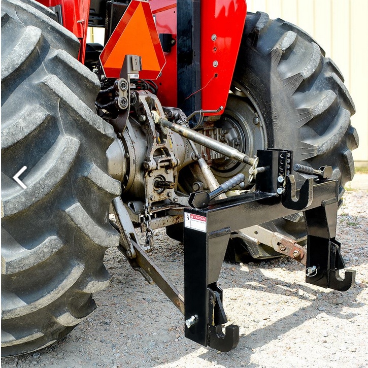

I am looking at the HF Quick Hitch. (yes, I have searched the many threads) I have a 2538 with the Mahindra Box Blade and Mahindra Shredder I got in the package deal. What all do I need to adjust it to fit both of those implements? Do I need the top link adapter and do I need adapters for the bushings on the implements?
   / Quick Hitch Questions #2
If they're new then they are probably quick-hitch ready so you shouldn't need top link adapters. If you don't put adapters on the bottom pins of the implements they will still fit but will be sloppy. The HF quick hitch has an inherent problem with the top hook being too close to the bolts that hold it. Some implements will fit and others hit the bolts. No way to know without trying.
I bought one of these hooks for mine but many other people have just modified the HF hook (see youtube).

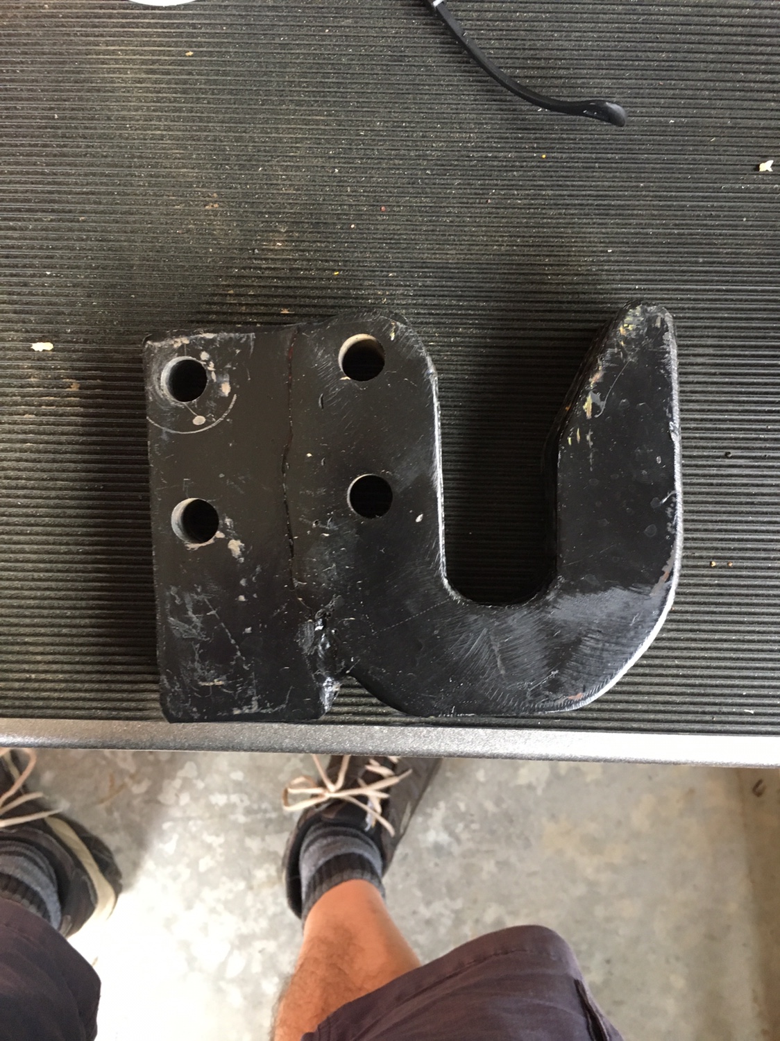

I also. After two years I have modified my hook but I notice that I end up having to raise and lower it enough times that I could just stay with using the adaptor. IMG_2619.JPG
By the way, can anyone tell me what that 2nd hole in the adaptor is used for? Inquiring minds want to know!
The outer hole on the "U" is self explanatory. The inner one I haven't figured out what it's supposed to be for yet after 2 years.
