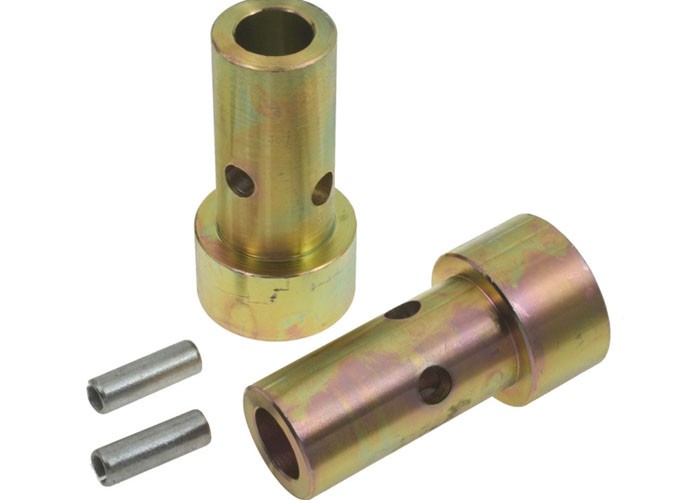

Well in case anyone has money to spare, and wants the correct Cat 1 to Cat 2 Speedco adapters, I found some while perusing online at EBay. They are at about the same pricepoint as the TSC ones, but with free shipping, so they at least would be good for anyone without a nearby TSC...
$105 for 5 sets with free shipping....
Here's the link to the site:
5 pair Speeco Zinc Cat One Quick Hitch Adapter Bushings | eBay
These zinc chromate bushings will convert your standard category one 7/8" lower link pins to the size needed for Speeco and most other brand Category One Quick Hitches. They come in pairs that will be needed for each implement you are adapting.
Dimensions are:
Inside Diameter: 7/8"
Outside Diameter 1 7/16"
Overall Width 4"
Collar width 1 1/8"
You are buying 5 pair of the pictured bushings.

My Land pride QH-15 Quick Hitch was delivered today - along with a new Land Pride RB1560 rear blade. My first adventure with a Quick Hitch. I was anxious to install it on my 2720. What a disaster! The QH15 married up to the tractor just fine but I cannot get it to grab the RB1560 to save my sole! Normally, mounting the blade to the 3PT takes about 5-10 mins. Using the Quick Hitch was a two-man 30-min job with a lot of fowl language being thrown around. First, the lift arm bushings that Land Pride sends with the QH15 are worthless for regular implements. They are straight walled bushings and only 1.5" long so they just float around on the 3PT pins. The second problem is I had a terrible time getting the top hook to fit between the blade housing and grab the top pin. It keeps getting snagged on the sides and that just throws off the lower connections. It's almost as if the top part had insufficient clearance. It WILL fit but only when carefully guided by hand. Oh, and then when you do get it inserted it comes into contact with the hairpin clips that holds the hook in place and sends the hairpin shooting across the driveway.
I intend to stop by TSC and pick up a pair of "normal" lift arm bushings but what about the top link bushing? Is one required? It looks like the hook expects a larger diameter than the normal top-link pin. The manual really doesn't mention it. All the places that sell Quick Hitch bushings normally only show the two lift arm bushings. Rarely any mention of a top-link bushing.

That rb1560 looks almost identical to the woods rbc60 I have. I just got the bushings for the top link pin 2 days ago. i have not got it setup for the qh yet. When you have a qh you go from cat 1 to cat 3. Where you using the top hole or lower hole for the toplink on the blade? You will need to use the lower hole toplink hole for the quick hitch. That hole is cat 0-5/8''. I was asking jenkinsph where he got his bushings for the toplink and he had the idea of drilling it out to a cat 1 hole. Then you will only need 2 bushings.
I don't not recommend going to tsc for those bushings. They are a rip off. Northern tool was the cheapest place I could find them.

Thank you for the reply. I was using the lower hole for the top link. The hole accepted my normal 3/4" top-link pin.
I know the TSC bushings are a bit more than some on-line sources but I have some time this weekend to tinker and there's no time to mail order. Once I get the blade figured out I will buy my other bushings on-line.
