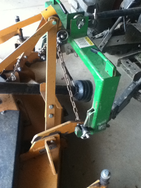

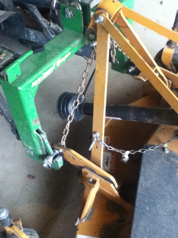

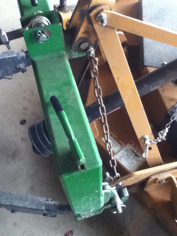

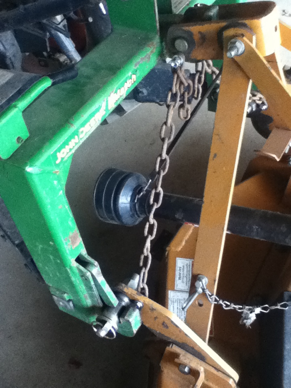

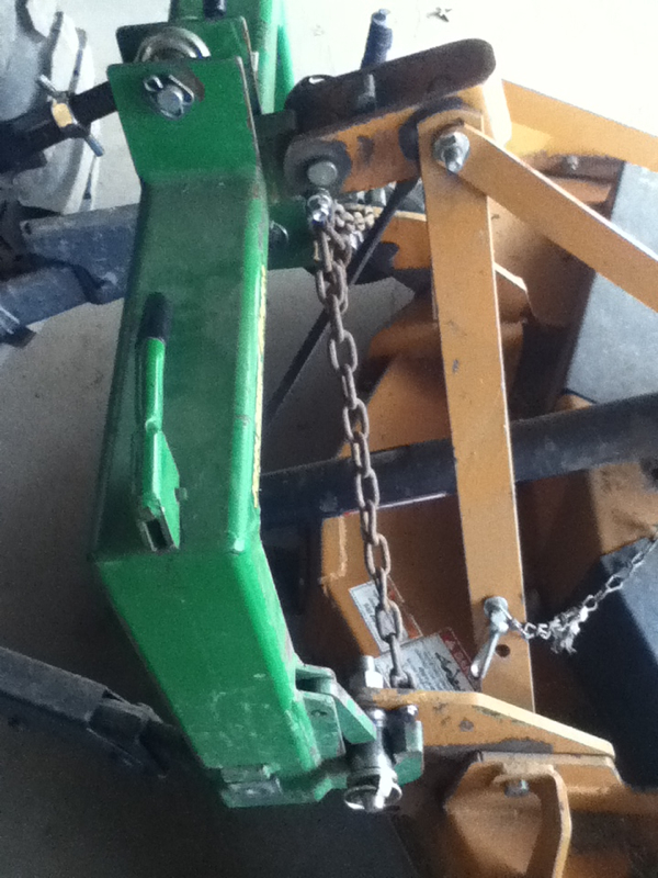

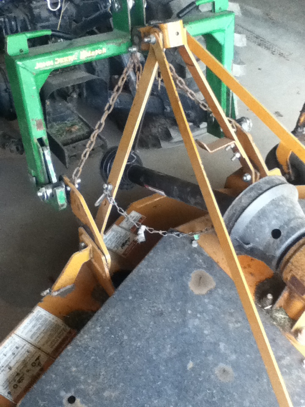

I do use it with the imatch hitch. This was my best way to get it to float for for me.
How do you prevent the QH from flopping about the lower links (if the mower or other implement isn't attached)?
   / Quick Hitch kit for Frontier or Woods Finish Mower #25
Here is the pictures, I put the chain toplink on once the mower is hooked up
