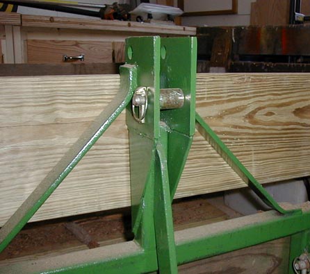

I found that the modifications I have had to make are primarily for the top hook, as one has to come in under the top "bolt" or "pin" with the hook. Usually there isn't room on the attachments to do that (mine requires about 5-6 inches), and some re-fabrication is needed to make room for the top hook. See attachment also showing position for conventional top arm pin holes.
I'm not sure what is meant by the "useless" comment, as I find the top hook very useful. I can hook a tow chain on it (pulled the UPS truck out of the ditch, as well as off the ice), throw my logging tongs on that hook, and use it to pull out fence posts.

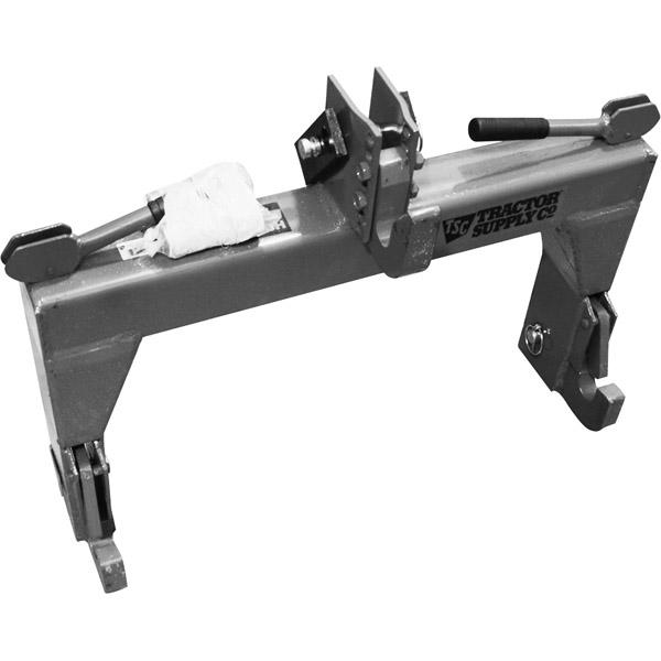

From the picture (see attached picture I copied from the TSC Blue Book web page) I can see where that top hook would be a problem on my grader blade. There just isn't room for that hook under the pin. So, I'd have to modify the grader blade by extending the bracket up a few inches. The boom pole and the pallet mover look like there would be no interference. I haven't looked close yet, but I think the rest of my implements would be OK for that top hook also. The problem is going to be that the lower pins and the top bracket are spaced differently on everything.
PS: After looking closer at the picture, I see that the top hook is adjustable. It seems like the bolts could be replaced with pins to make that easier to do. I plan to go to TSC this weekend and do some measuring.

See the bag on top of the TSC quick tach, it contains the bushings.
The previous poster didn't want to pay $18.00 a set for many
(12 sets like me) of the bushings or else u switch all the time.
The bottom hooks ARE over size,a little larger than cat.II,
Spee-co are flame cut (like mine).
The cat.I and cat II size refers to the tractor pin size and spacing.
