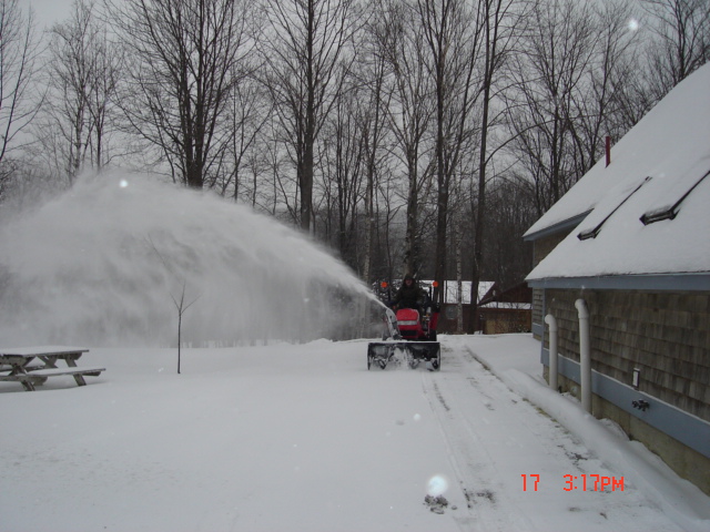

Haven't found that I need one, the blower takes care of it all. I also have a steep uphill drive, and the tractor (with BH on for traction) does get real light on the front going uphill. Sloution: go uphill once, in the center (I may have to stop back up a foot, and re-center on the way up) then do the rest downhill. I just back up to get back to the top of the drive. Only takes 2-3 passes on my driveway, 10-14' wide. This thing will easily throw snow 50-70', though it will drop to about 35' with wet snow...:D:D

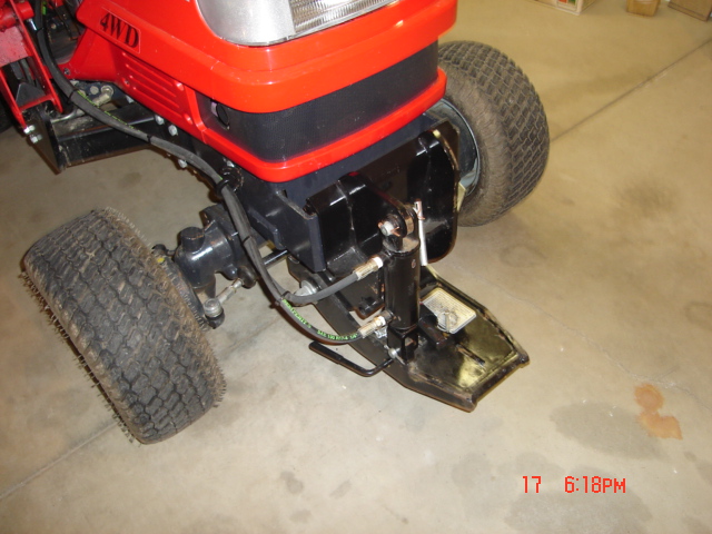

Quick-hitch assembly: Yes, you need to remove the grille guard when putting it on- at least on the 2310. The 2410's grille guard is a bit different, so I'm not sure how that works. However, removing the quick hitch is easy; that's what I do in the summer, and then put the grille guard back on. In the winter, if I should need the FEL (not often) I just remove the blower and leave the quick hitch on, but am careful not to drive over rocks or other stuff that would hit it. You're right, if you intend to go over rough ground, you're better removing the quick hitch- it does hang low. I had seen your --was it you?-- earlier post about making your own quick hitch, but I'd recommend factory, even though it's expensive; there's a lot of stress on those parts.
Hope this is of some help. First pic is 6" of very wet snow!

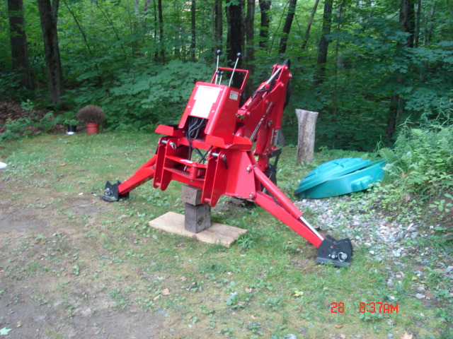

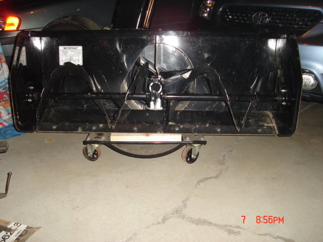

There are a number of posts on this forum concerning dollies (try a search!); I just use car tire dollies for the FEL and the blower-- a piece of 2x4 is all that I've needed to get the blower at the right height and angle to quickly slide it on the tractor. The backhoe I drop outside onto some wooden blocks, since the stabilizer arms will slowly bleed down and retract after a while, with the result being that the BH is becomes too low to engage without some finagling. Hope this helps.

Here's a better shot of the MMM axles/wheels; you can see where they go into the hole where the original wheels were. Also a pic of the BH on blocks and the blower on the automotive dolly.
