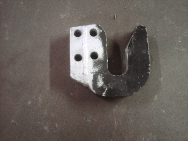

I am also getting up there in age and I need a back operation so I feel your pain. When I bought my quick hitch I looked at several different ones. I ended up with the harbor freight unit, it was way less money and I only had to make one change to it but I knew that before I bought it. That was this hook, it really wasn't much of a problem but I have all of the equipment and materials already.
But my equipment is mostly all old so I had to modify the equipment to fit the quick hitch. My brush cutter is brand new, so all I had to do was to turn the lower pins to the inside in-lieu to the outside as shown on the directions and then I cut a piece of 1" black pipe to replace the top spacer because I wanted it larger for a tighter fit. On my box blade even though it is new it wasn't quick hitch compatible so it was a PITA but not impossible. I have also done my carryall and am working on the tiller, but I may just get a new tiller if tractor supply has any good sales this spring I want a little wider one anyways.
Even though I had to do this work to get everything to work it has been well worth it. Not fighting with a piece of equipment in order to hook it up is great. There will always be items that the quick hitch just won't work on like my pig pole (well maybe), or the post hole digger but the majority of the heaviest ones is what I am aiming for anyways.
I think once you get the bugs worked out or have the adaptations made you will really like the quick hitch and the ease of connection. One thing that really helps even with the quick hitch is a hydraulic center link because the vertical plain from the lower to the upper connection points are not usually the same from one piece of equipment to another, and it can be way different if the equipment is sitting on uneven ground. The hydraulic center link removes this obstacle, and the only time you really need to get off of the tractor is to connect the PTO.
