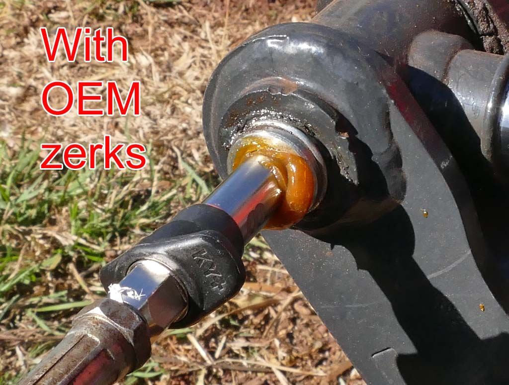

OK - road test!
While it fitted nicely into the recess, initially I was very disappointed with the KY+. It didn't seem to lock on to the zerk, and spewed grease:

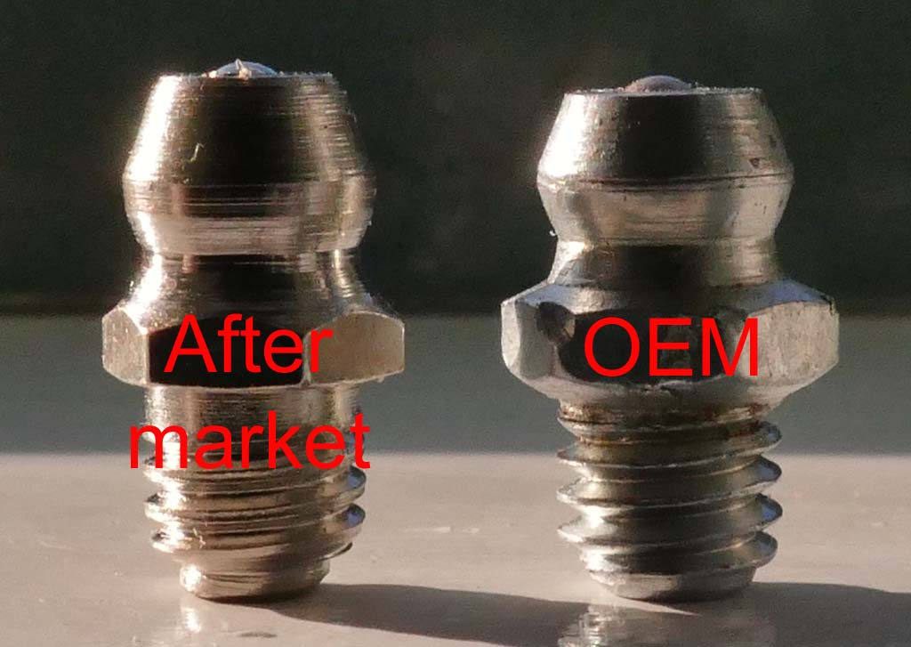

So, investigated the zerks. Fitted half a dozen from my zerks box, and problem solved:
Note the quite different profile. Also the profile of the thread - the after market thread has flattened peaks, but they screwed in nicely. Just remembered, the box of assorted zerks stated they were "metric", so that probably accounts for the different thread profile. The thread pitch looks identical. But that's all I had on hand and needed to get the pins greased.
The take home? The Macnaught KY+ does a great job if paired with a compatible zerk. And yep, 14.7mm diameter. :)

The Macnaught KY+ coupler "sort of" sealed on one of the FEL zerks for a couple of pumps, before oozing out between the zerk and the coupler as the pressure built up.
So for me, it'll be the KY+ for the 4-in-1, and the Alemlube coupler for the rest.
Here's a better photo of the zerks. The KY+ seals fine on the taller one on the left:
