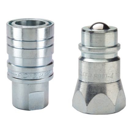

I am installing a Greens Machine Thumb on my bucket,and using my rear remotes. I want to know if I can remove one of the rear quick couplers without oil spewing all over the place. I want to take one to the hydraulic hose place to make sure I get the right fittings,as I understand there are several different kinds.

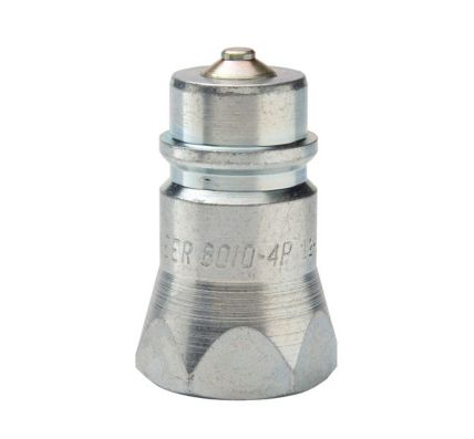

As far as the couplers that you need, ISO 5675 1/2" male. 99 out of 100 times this is what rear remote outlets are. Most people get NPTF (1/2" pipe thread) for connecting to the hose. I would get the poppet style.

I installed the Greens Machine Thumb on my bucket and forks. I bought 2 base plates (one for bucket, one for forks). Then I can switch the thumb between the bucket or forks. I bought these Pioneer fittings at TSC store. They have ball or poppet type. I went with ball but either will work. I bought the combo pack which has the male and female coupler. Two right angle swivel fittings. I also bought ready made 12'ers of 1/2" hose from them too to run to the front and two 4' hoses for the thumb. The 12'ers were long enough to reach the loader.
Here's a link to my post.
http://www.tractorbynet.com/forums/attachments/313144-added-thumb.html
