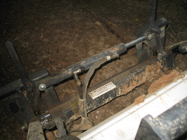

Remote (hydraulic) operated from the seat can be done, just a matter of how you set up the locking levers and cylinder or cylinders. I went the manufacture route and bought the SSQA, and all of Bobcat's current QAs are designed with ability to add the hydraulic function.
The lock levers have holes in them for the cylinder mount. Nice part of this design is if the hydraulic mal-functions you and pull a pin and unlock the normal manual way.

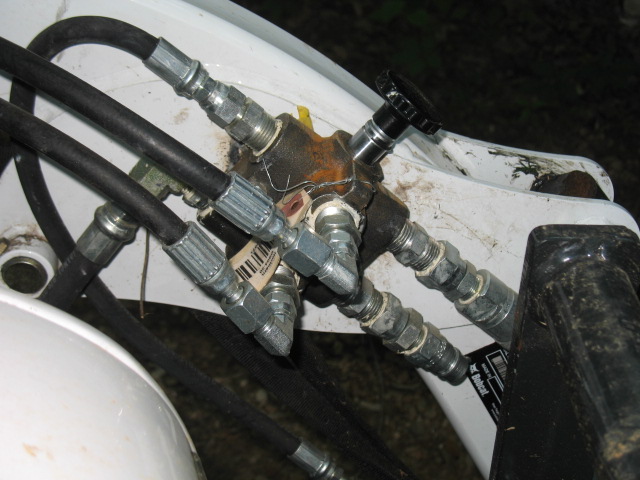

I have a grapple bucket so I run both QA and grapple from the same control using a diverter valve at front of the loader. Lock on the bucket and close the levers, then get off the tractor, push the button on the diverter and hook up the grapple.

There quite a few threads on here about building SSQA and wouldn't take too much to hydraulic cylinder function.
What's the part number for that valve? Might be the ticket for what I've got planned
/ Quick Connect for FEL Bucket #19
I got it at Northern Tool - (Metro Machine Selector Valve, 1/2in. Port, 20 GPM Flow
Item# 2071
Northern lists it at $100. Didn't need the 20 GPM or 1/2" ports but that is simplist & cheapest they had.
