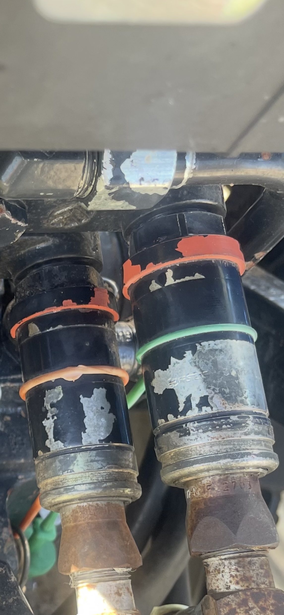

New Holland TN75
How do you disconnect the hydraulic Quick Connectors on the back of a New Holland TN75? I don’t see a kind of a collar that slides back. They say Pioneer on them.

How do you disconnect the hydraulic Quick Connectors on the back of a TN75? I don’t see a kind of a collar that slides back. They say Pioneer on them.
Probably, just pull firmly while the connector is not under hydraulic pressure.
/ Quick Connect Couplers Question… #4
Try pushing in and then pulling out all in one quick motion. This is typical of breakaway couplers.

Already drained the fluid to flush out the hydraulic system. Yanking on them does nothing. Pushing in and pulling out in one continuous motion does nothing. Gonna soak them in penetrating fluid to see if that does any good.
I still can’t see any type of collar to try and tap loose and slide back.

The collar is inside the housing, you will not find it from the outside, because it is inside the outer housing. I am assuming that the male end does not push in at all? If that is the case, then lots of penetrating fluid and time.

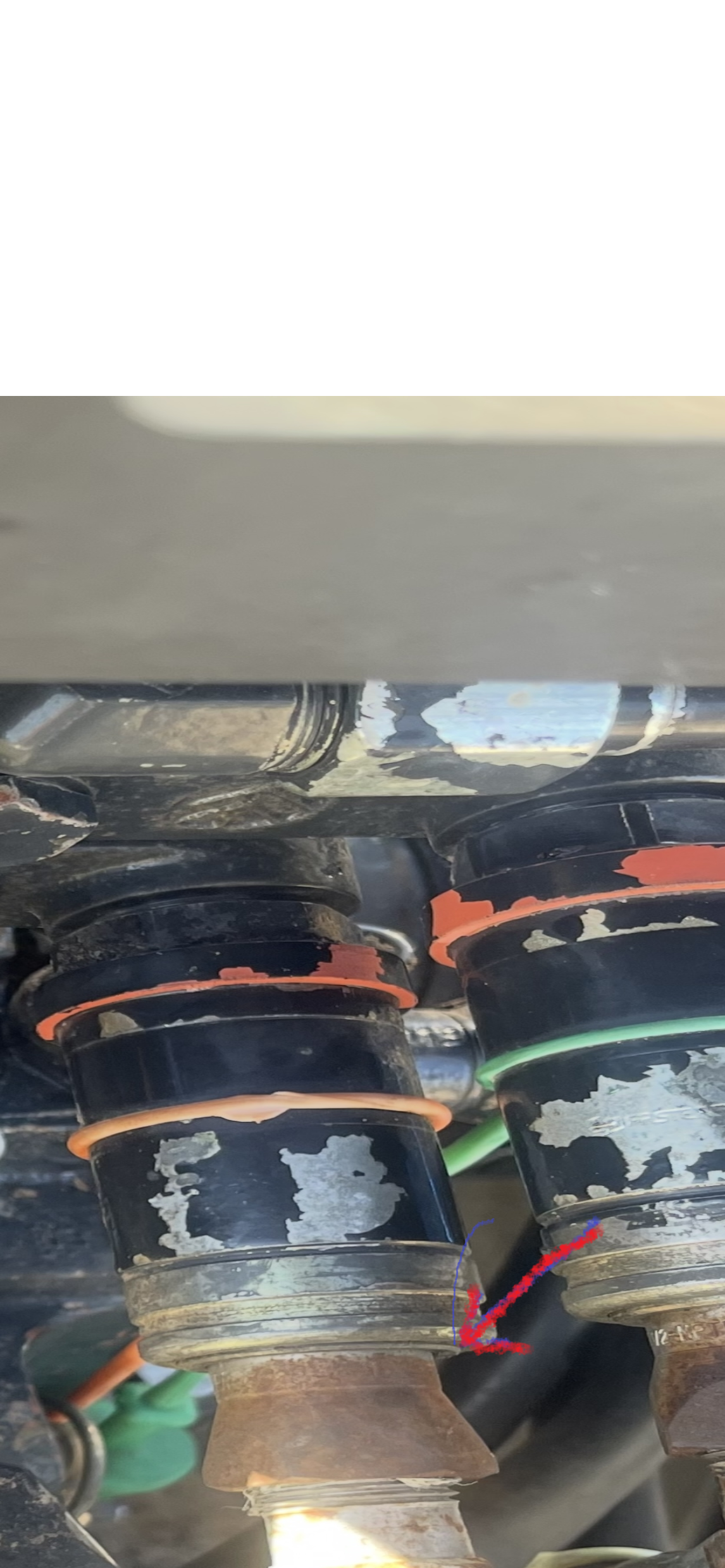

The Pioneer part is the male portion of the quick connect. Using a good penetrating oil soak the seam of the female section,
My arrow just barely shows up, soak that seam good and push and pull till it starts to move repeating the spray and soak till the male portion starts moving, eventually it will disconnect.
Also twist the plug side back and forth a bit to help mobilize sticking components. A little warmth should help too. Try a hair dryer for a couple hours.
