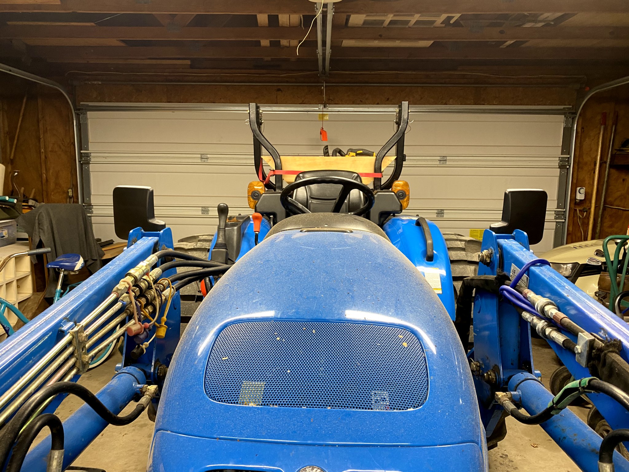

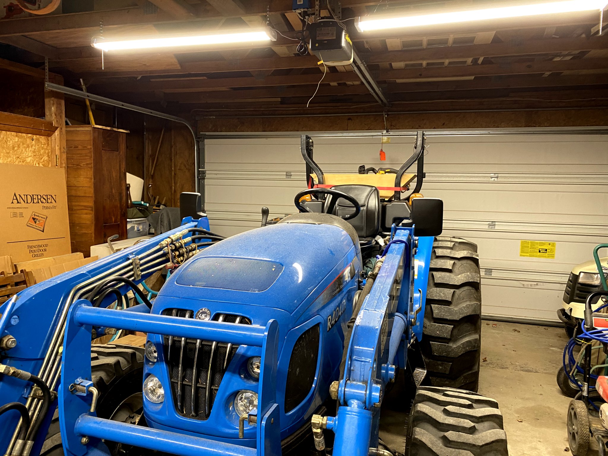

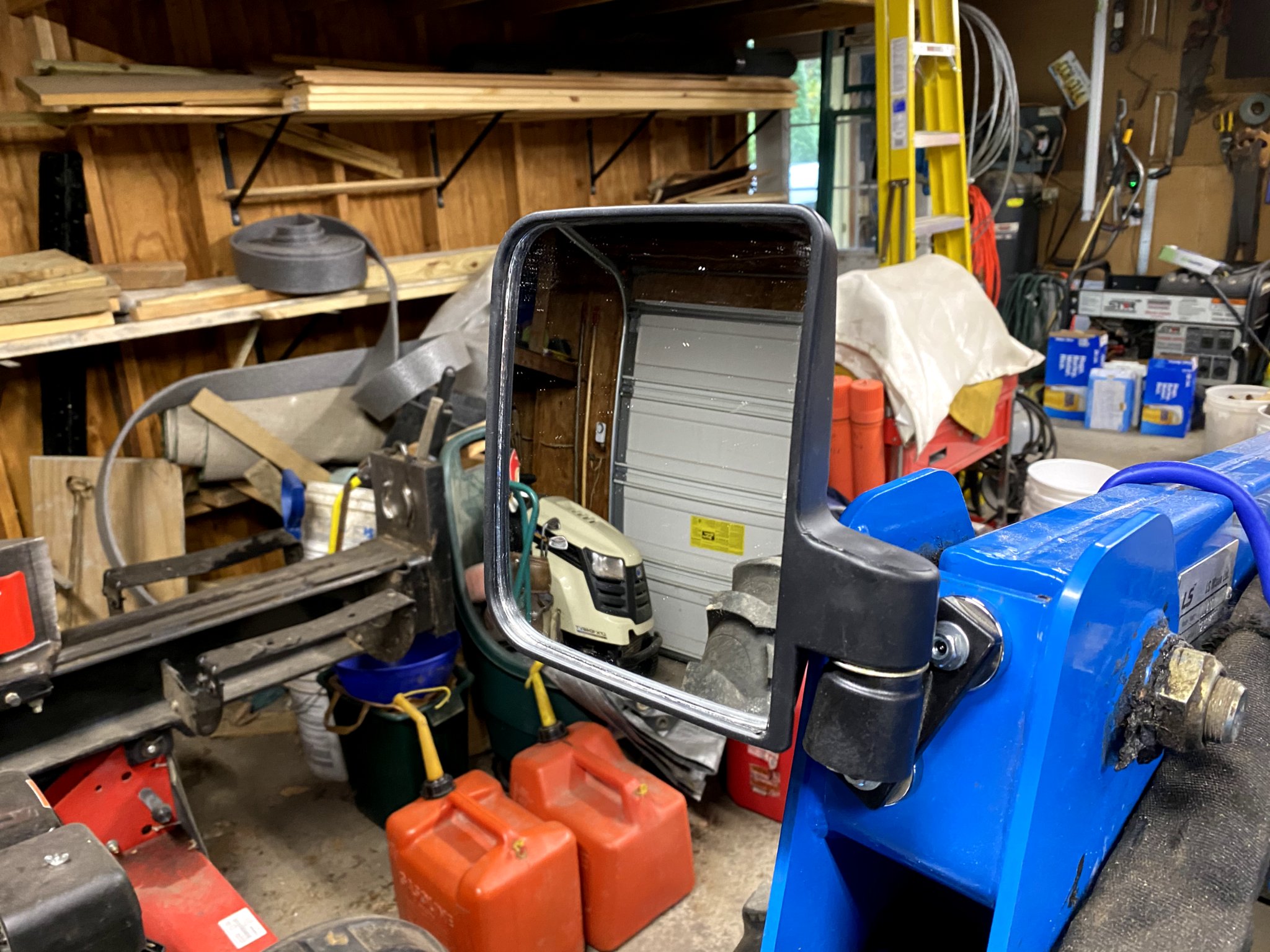

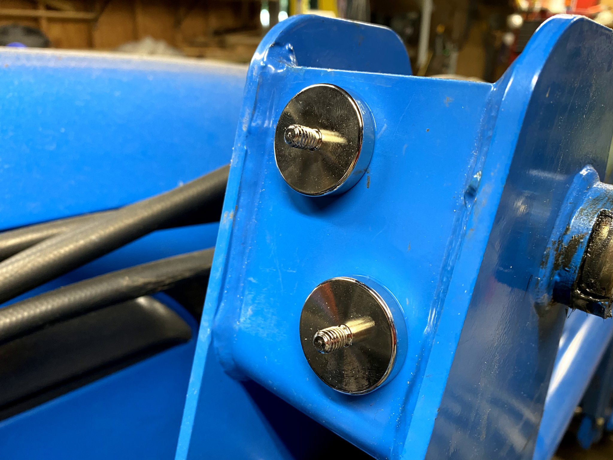

Bought some relatively cheap golf cart mirrors and some magnets from CMS magnetics. I didn't want something sticking out too far or too high.
2020-10-01_17-47-31_909.jpg 2020-10-01_17-48-46_137.jpg 2020-10-01_17-49-12_909.jpg

Looks good. Are you relying solely on the magnets or have you used an adhesive?
I ask because simple diesel engine vibration would cause the magnets to shift over time.

If the mirrors vibrate they will be worse than useless! Found that out with my Mule!
   / Quick, Cheap, & Easy Mirror Install #5
I wholly agree. When attaching anything to my tractor (mirror/fire extinguisher/light bar) I've always included a rubber gasket to eliminate overt vibration.
They are pretty strong magnets (88 lb. Holding power each) I also bought some stronger ones (112 lb. Holding power each) if the smaller ones don't work. I'll let you know!

I bought RARE earth magnest off E-Bay, Rubber Coated, threaded fastener, to hold a strobe light on a roof. They got the old large regular magnets beat all to heck for holding and a smaller size too.
