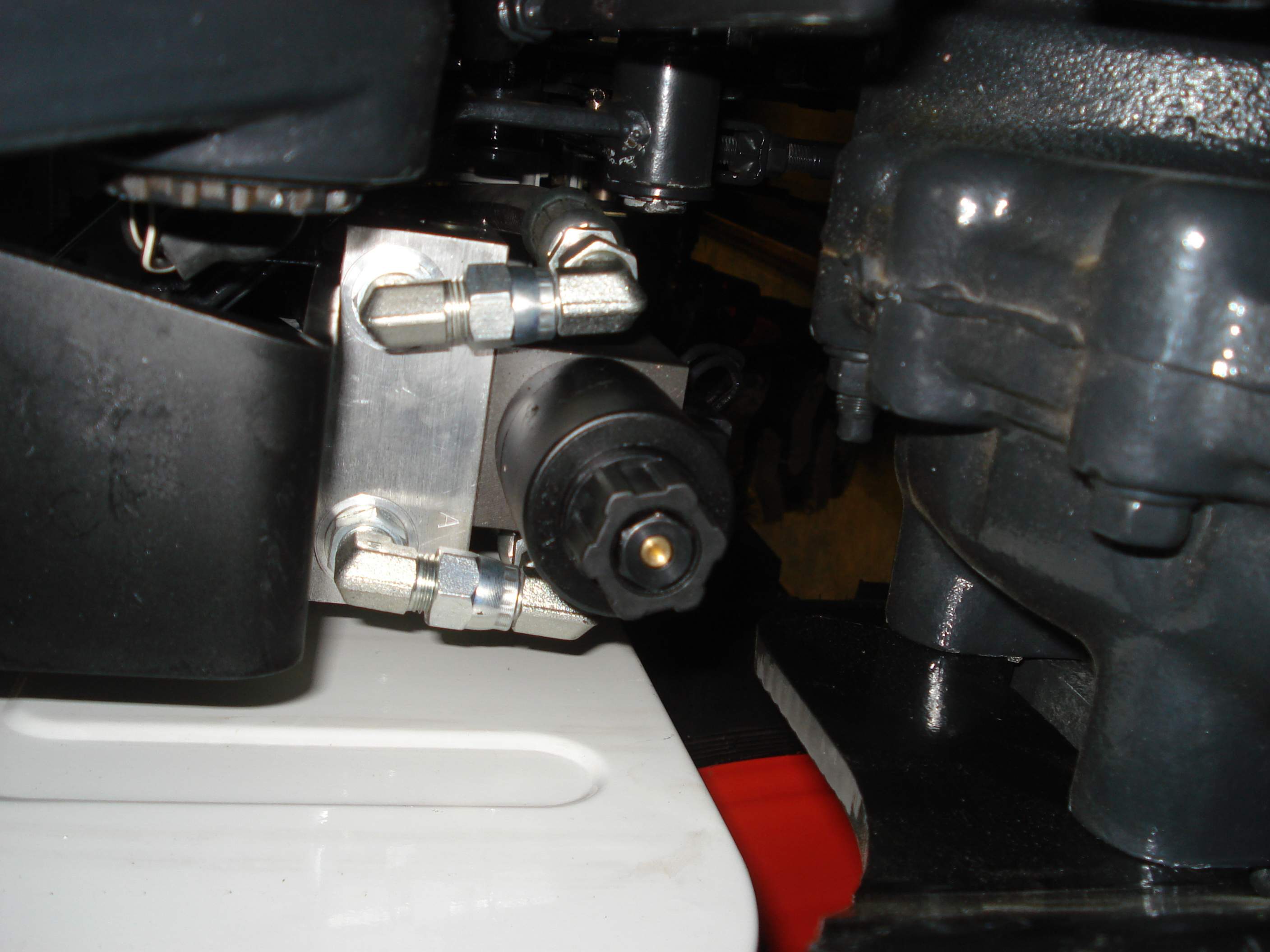

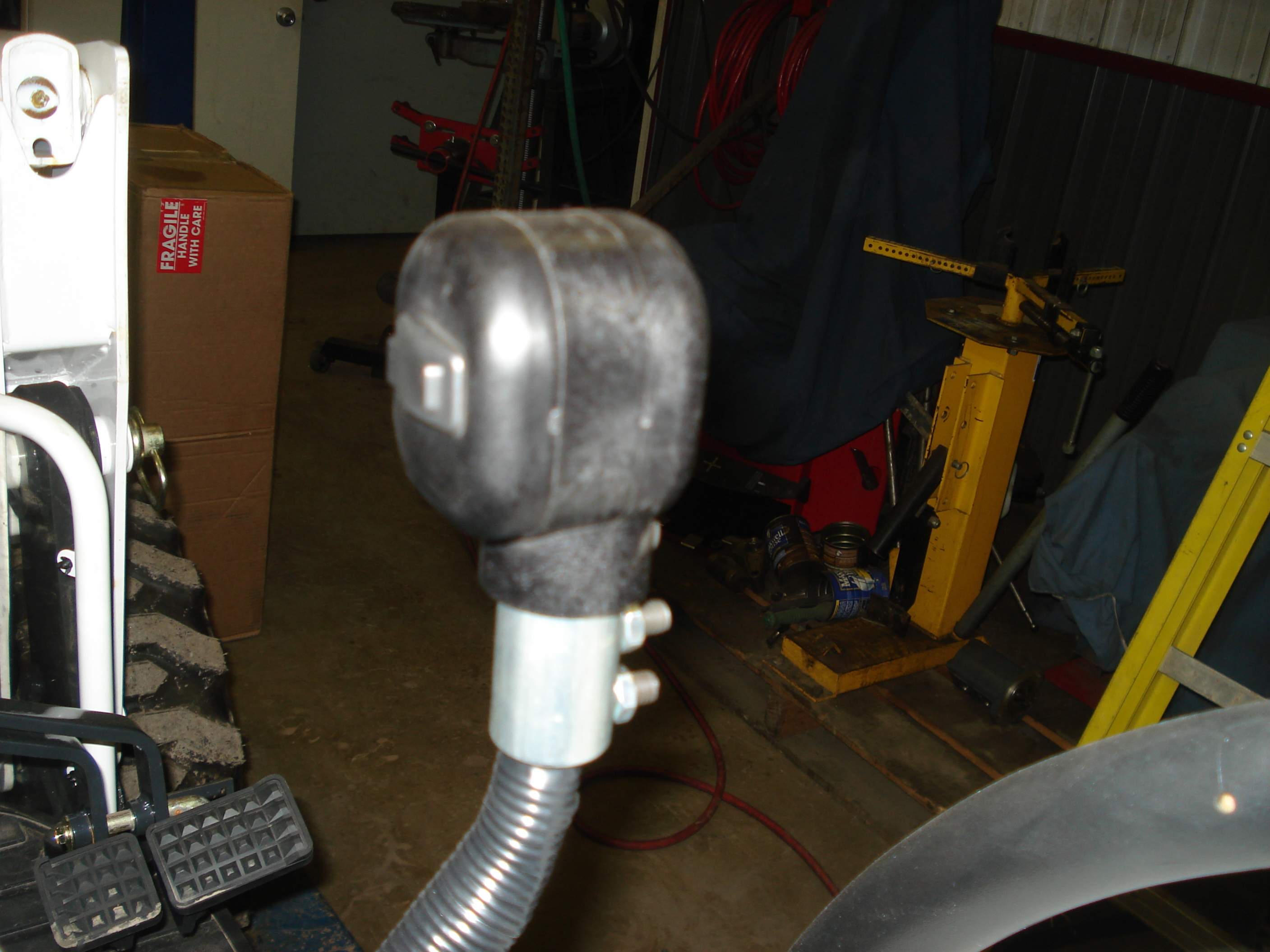

Not exactely...This is a self centering rocker switch that will allow you to do all 3 function at one time if your that tallanted!:laughing:
So is the toggle controlling a diverter valve or electric over hydraulic in the system you put together? I don't see how a diverter like I have can allow simultaneous curl/dump and open/close.
The red push button is a diverter. The rocker switch is a electric valve allowing flow to be open or closed in either direction. which will allow all functions to work if you can get your joystick in the right position.
Island we only use the red push button system for the customers that we don't like!:p;)
Actually the rocker switch one is the newer system and yes it is from WR
