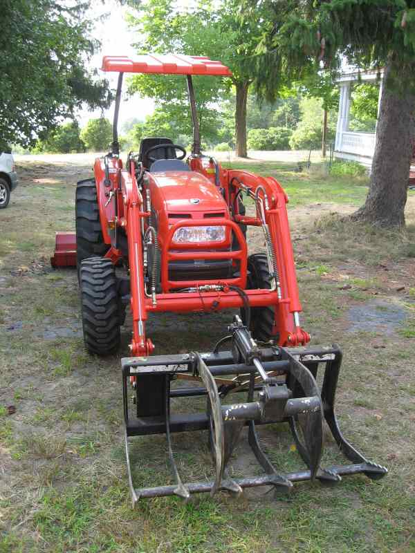

I have a DK40se with KL401, the QA works with any standard skidsteer (Bobcat) style attachment. That said, the width of the Kioti adapter is narrower than the typical SS implement so there is about three inches of slop on either side. It mounts securely however with lateral pressure on the grapple it can slide to one side. No biggie and it could easily be fixed by putting in a spacer if it bothers you. Photo shows gap on outside of the Kioti adapter shoe through the grapple. No effect on function. Never popped off.
Bottom line: Kioti QA works with any universal skidsteer attachment
