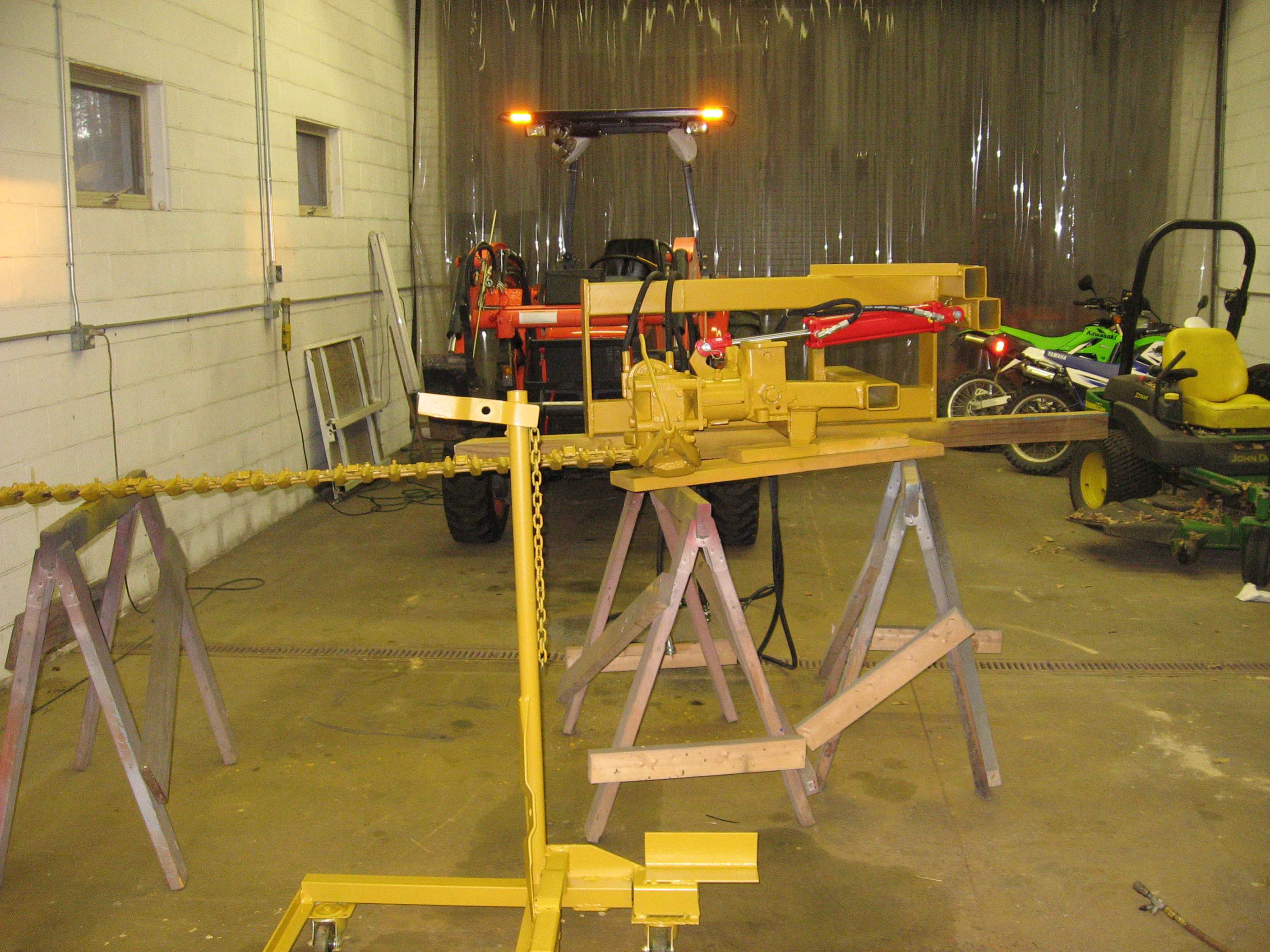

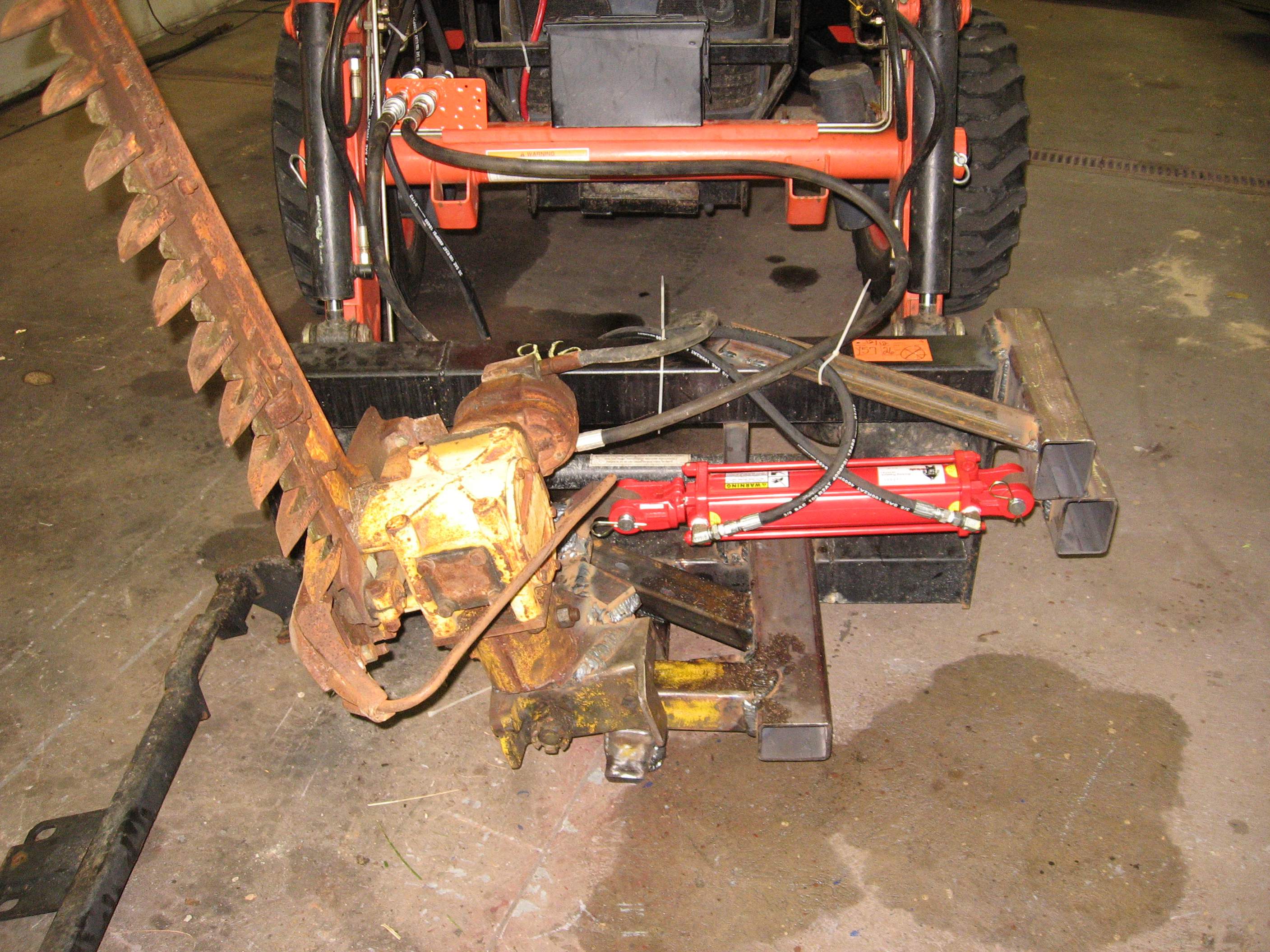

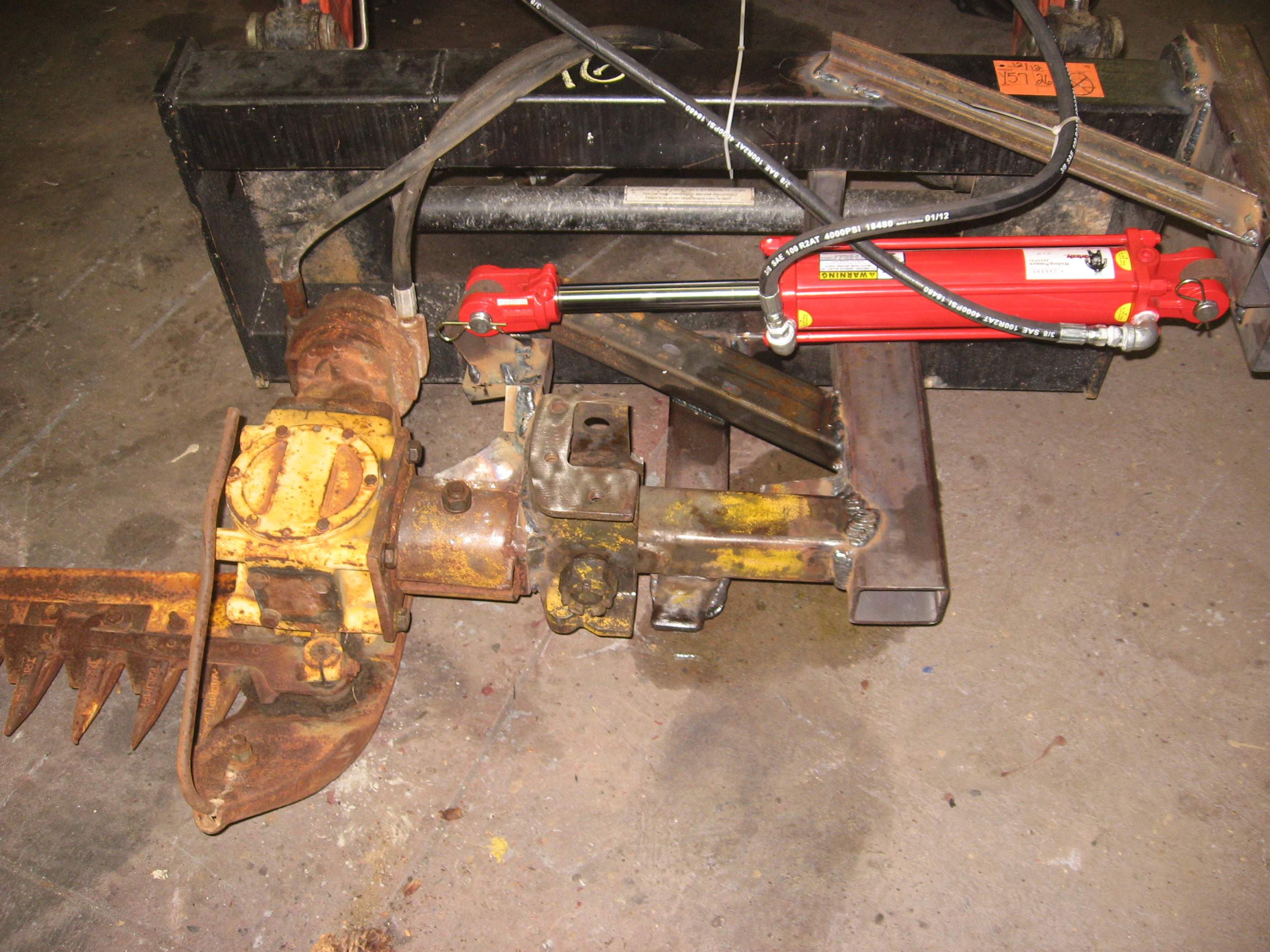

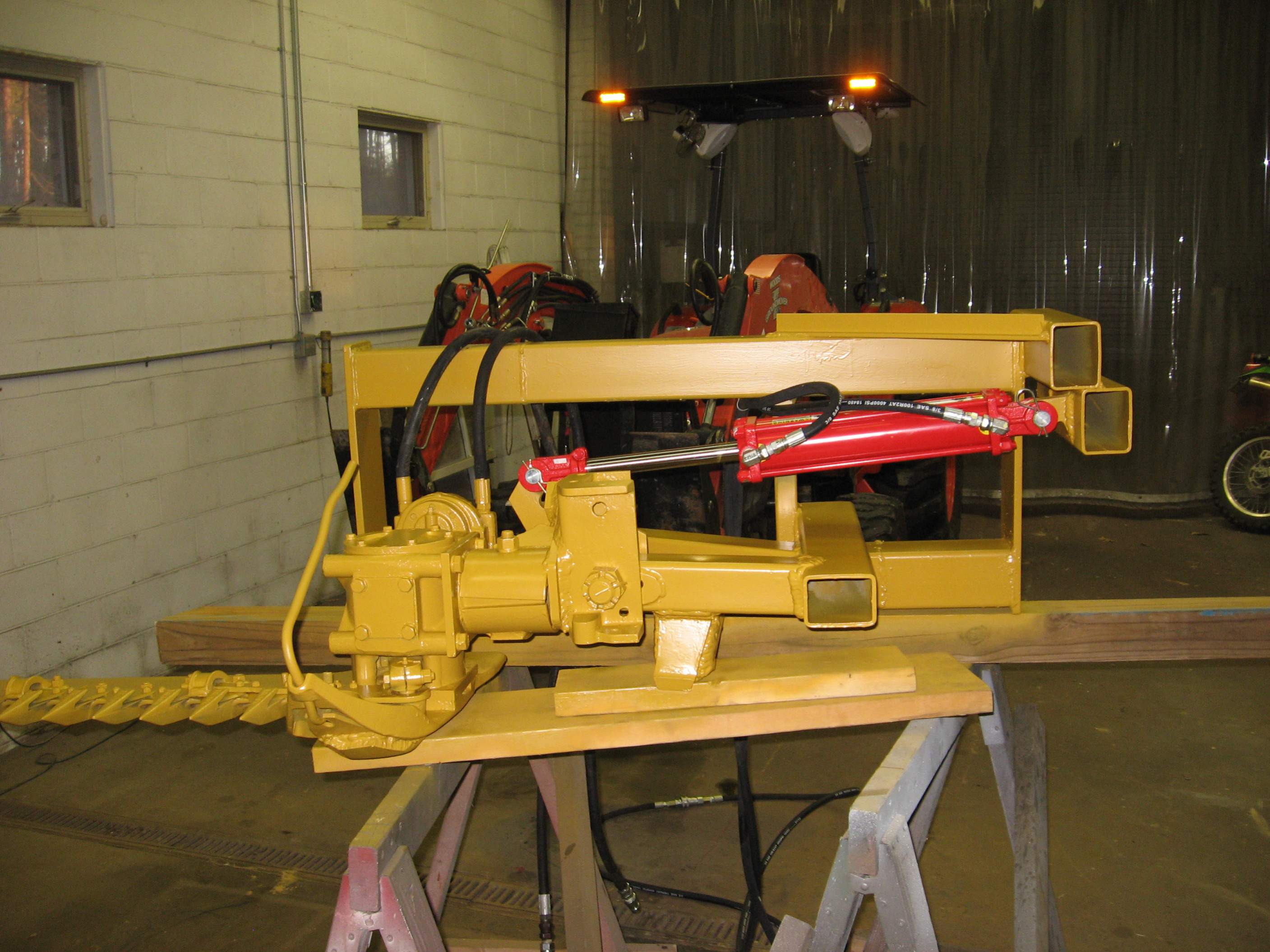

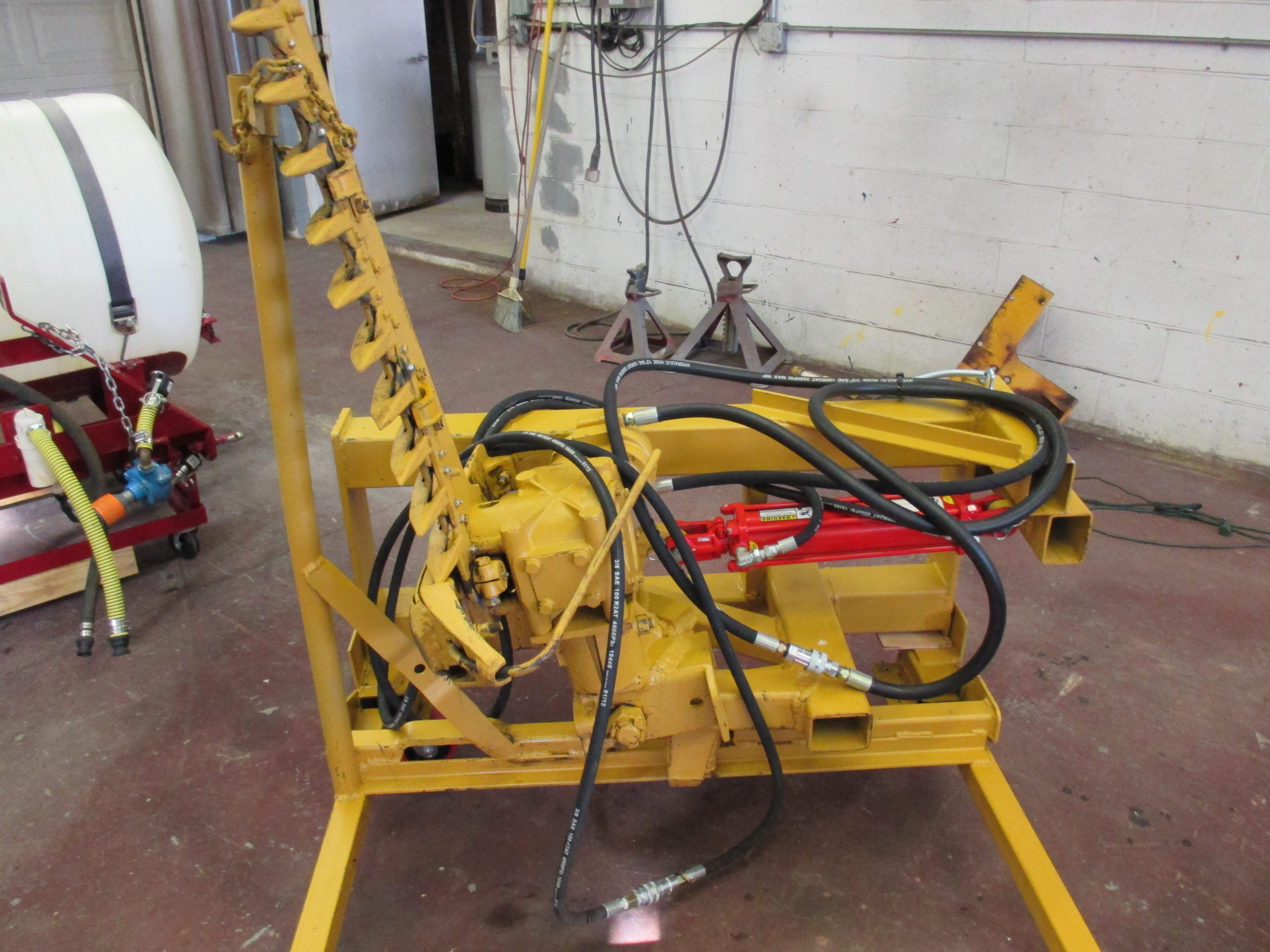

I have been reading and learning from this sight for years. I just finished this build and thought it may help other members who may be thinking of building the same thing. I have about $ 350.00 in it and more time than I care to think about. I built it for some property I own that has a 1 ac. pond with dam and other areas that require weed eating on a regular basis. sickle mower paint 003.jpgsickle mower paint 006.jpgsickle mower paint 007.jpgsickle mower paint 008.jpg

Any idea what kind of flow volume the hydraulic motor will need? Just curious.
/ Quick Attach Front End Hydraulic Sickle Mower
I am not sure Kioti says 16.8 GPM. Just a touch above idle seems to be the sweet spot for it. I tested it before paint and new teeth just to see if it was worth finishing. It worked so well that I put all new teeth and repaired hold down clamps. I took it to a neighbors field yesterday and was very happy with it. Anything under 1 1/4 it goes right through. I cut a larger tree but had to ease into it. One disadvantage is anytime you move joy stick the sickle motor slows in response. So there is a learning curb with running it. Also I tested on some trees at my house works great goes up about 15 feet. Sure beats a pole saw.

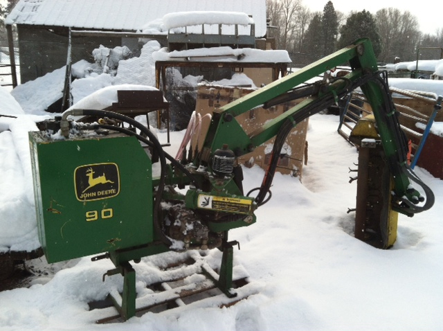

Very nice. Who made (or still makes) that hydraulic sickle bar? I just picked up a used boom hydraulic flail mower that I would like to have the ability to swap out the flail head with a sickle head for careful under fence mowing. I think I would put a bar above and slightly in front of the sickle in case I hit a fence post. Also, how much does the sickle with motor weigh?

Awesome project and exactly what I'm trying to figure out. I have 10 acres of grapevines that we hedge several times a year and I can't see spending the small fortune they want for a commercial hedger. I would love to know what kind of hydraulic sickle bar you started with. If anyone else on this site has any ideas/plans for a hydraulic x and y axis carriage I would love to hear about that too. I'm probably looking to mount the rig on the front of a tractor verses the back.

Naplen Yes it does work vertically and way down also. Part of why I made was trimming 100s of feet of treeline around pasture. Also the down position will work for driving across the top of pond **** and cutting low side.
Tom, It was made by Triumph Machinery in N.J. They got bought out by another company cant remember there name. I spent a cold day in the rain to get it for $ 100.00 at auction. Had no idea if it worked or not. When doing research on it after getting it home I saw one on Ebay with bid of one dollar. Never followed up on what it sold for did not want to know. Triumph made commercial mowers and a lot were sold to State Governments I think. Try a e bay search for Triumph. The original design looked completely different. It was a mid point hook up and 2 hydro cylinders for cutting adjustment. Weight was a concern for me it would have been easier to use more of the original mower but I was trying to keep it as light as possible. The 45 seems to handle it fine.

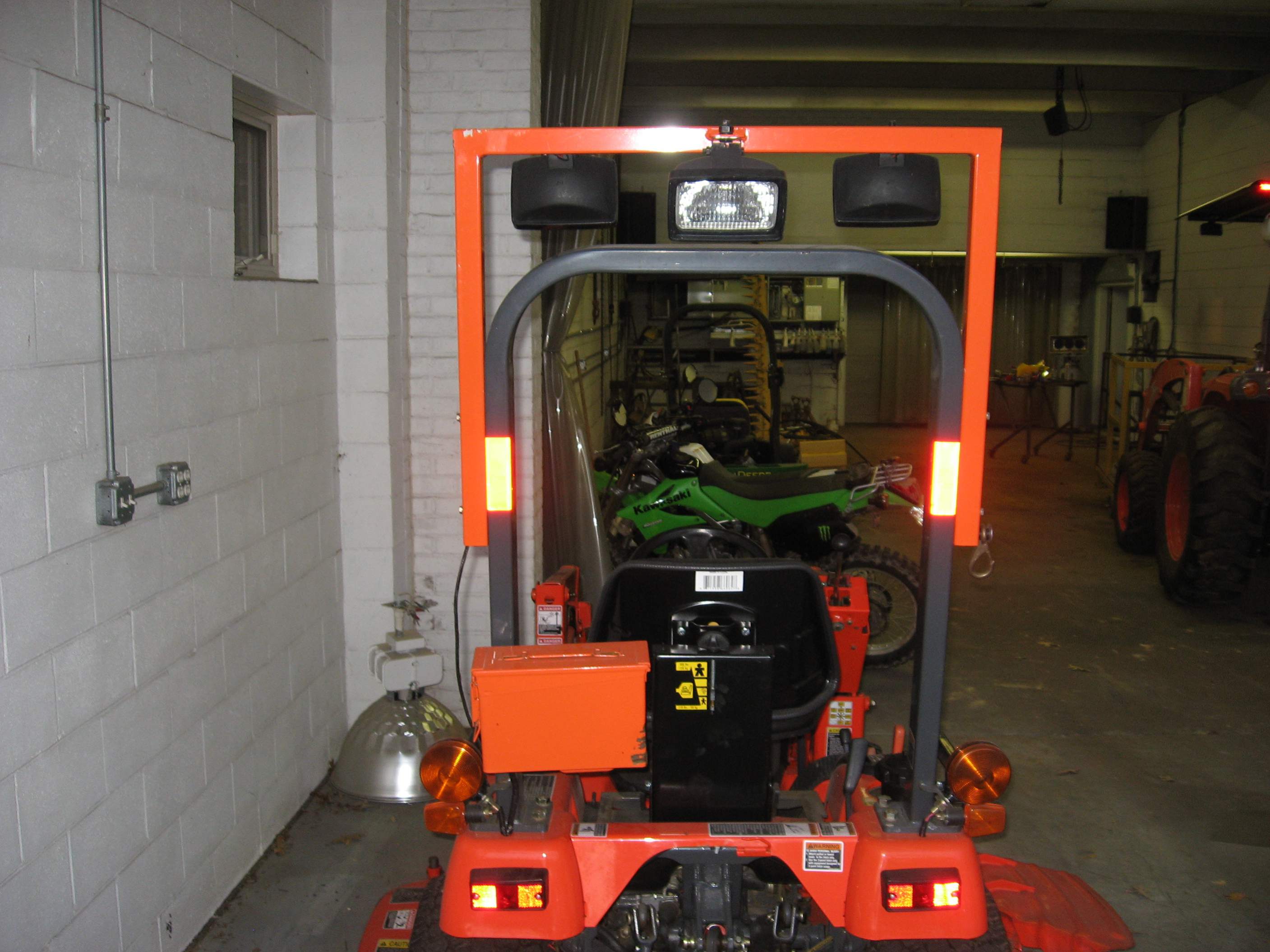

I wanted to add pictures of dolly to move it. And a few other projects I have done
1 Man cage with removable front that also works as storage for pallet forks.
2 Aluminum canopy for Kioti 45 with Radio and fan
3 Light bar for my Kubota. Best thing about it is brass hook for Lowes/ Target bag to pick up trashtractor att 014.jpgtractor att 015.jpgtractor att 009.jpgtractor att 010.jpgtractor att 017.jpg wile mowing

It was made by Alamo who bought out Triumph. They still have most parts for it I bought several from them. The don't have the sickle hold downs anymore so I bought 20 of each on ebay just in case. Everything else can be bought and is stocked by Agri Supply. I have the original owners and parts manual also. I took some pictures of it on tractor showing full up and down motion plus height and length when I brought it back from farm. It seems that my computer ate them. I will post them when found or hook up again and take more and post them.
