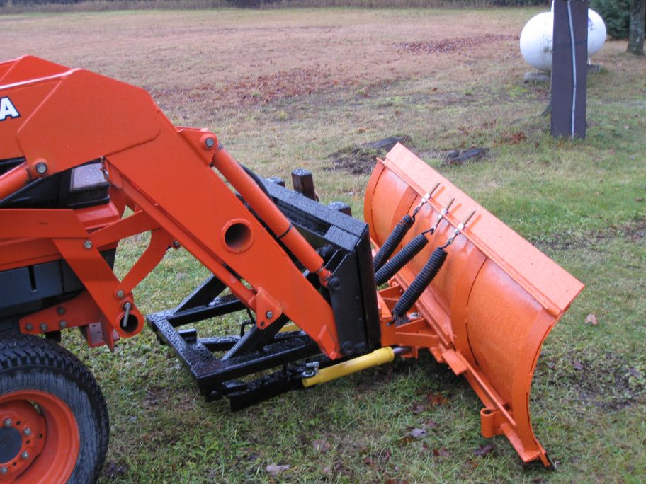

I have a MX5100 with the quick attach bucket. My friend is hooking my up wth a 7ft. snowplow but I need to weld it to a quick attach plate for use on onmy tractor.
I am assuming all quick attach plates are the same and will fit my tractor. But, just to be sure, I thought I'd ask the experts here...

Is Your Quick Attach a Skid Steer adapter?? OR is it something else... Most have the universal Skid Steer, because there are Many attachments that are available for Skid Steer... But a Few tractor supplied adapters are proprietary, so you Have to buy their buckets, blades and adapter plates ONLY... if your lucky, you got an actual Skid Steer... if not, well then you have no choice... KennyV

Ha ! that is my question.
/ Quick Attach for my Tractor? #4

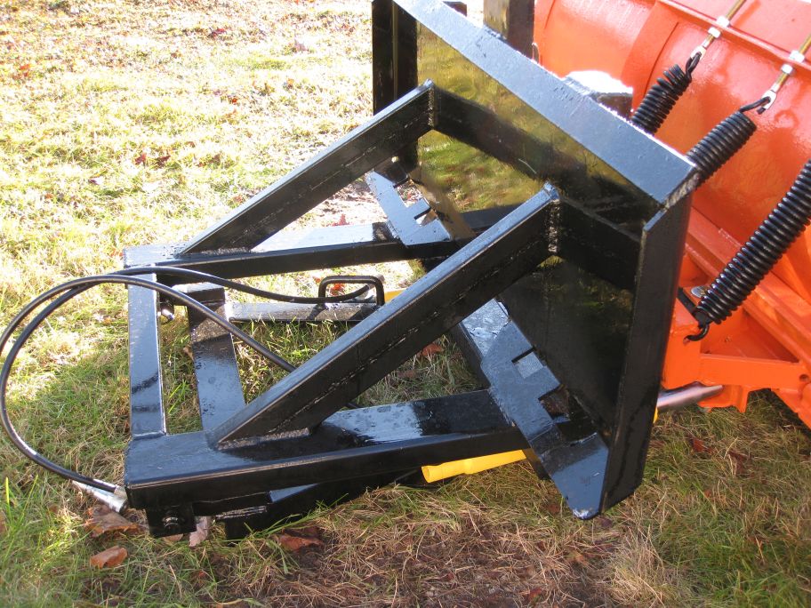

this is my s s attachment. ray

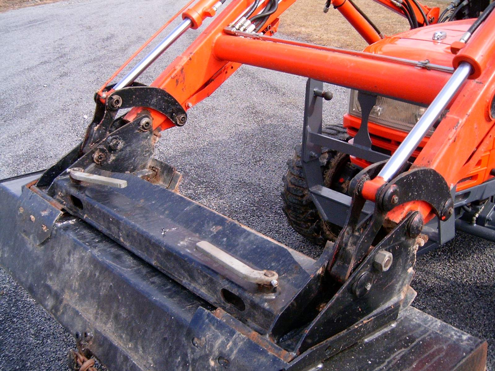

This is a skid steer style QA on my tractor.
Most have 2 levers to lock the attachment on. Some can have one lever in the center.

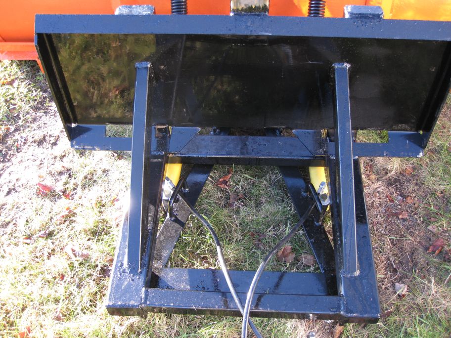

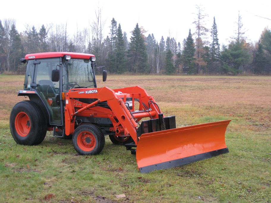

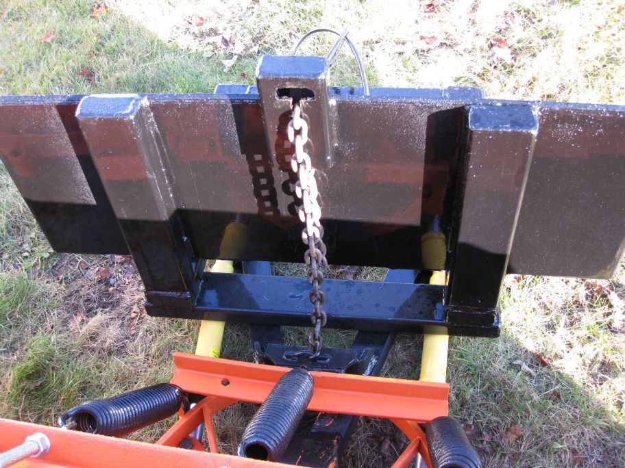

Ray, are you using your bucket curl function to angle your plow? If so I would love to hear more about how you plumbed it up. Would also like to her more about how you mounted the QA plate. It looks like you put it on top of the plow mount to cut down on the distance it sticks out from the tractor.

If you have the Kubota LA844QA loader, you will be able to attach anything that would fit the old Bobcat coupler because that is what Kubota copied when the patent ran out.

scesnick, i use the rear hydralic remote to angle the plow (run hoses to front of loader and quick disconnects), i use the curl to get the amount of cut i need. Here are a few more pics, ray.
