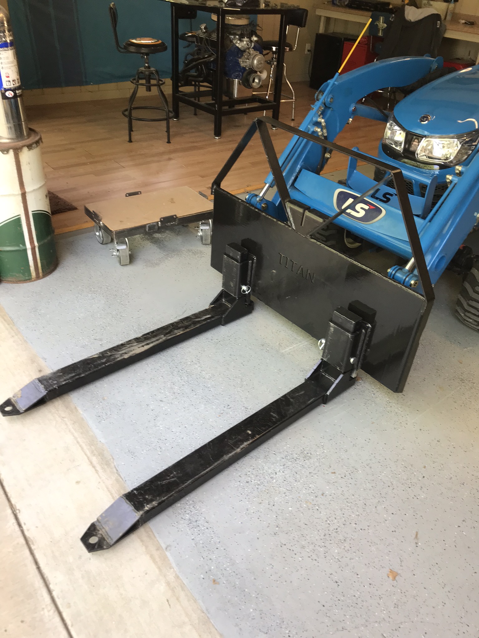

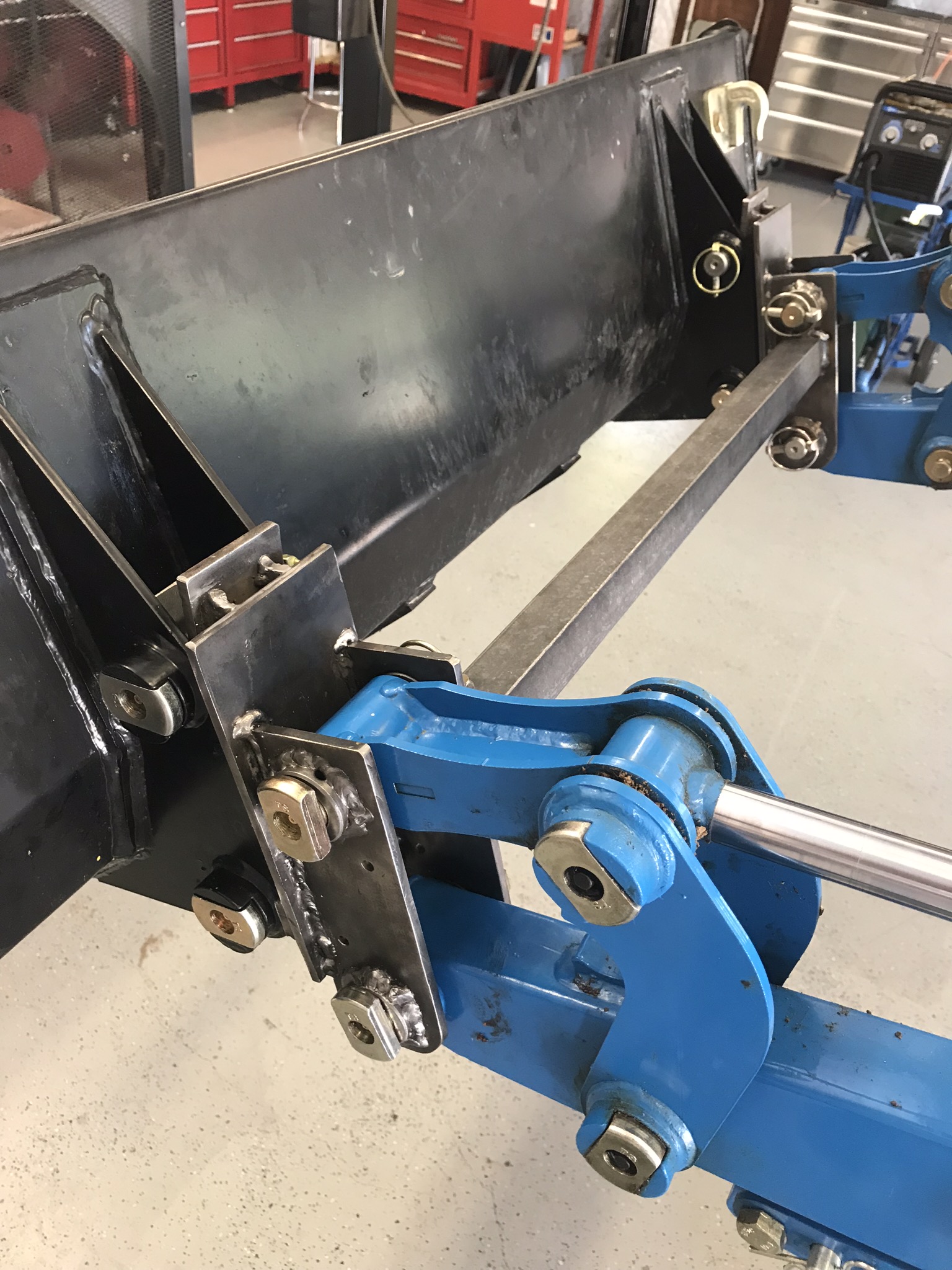

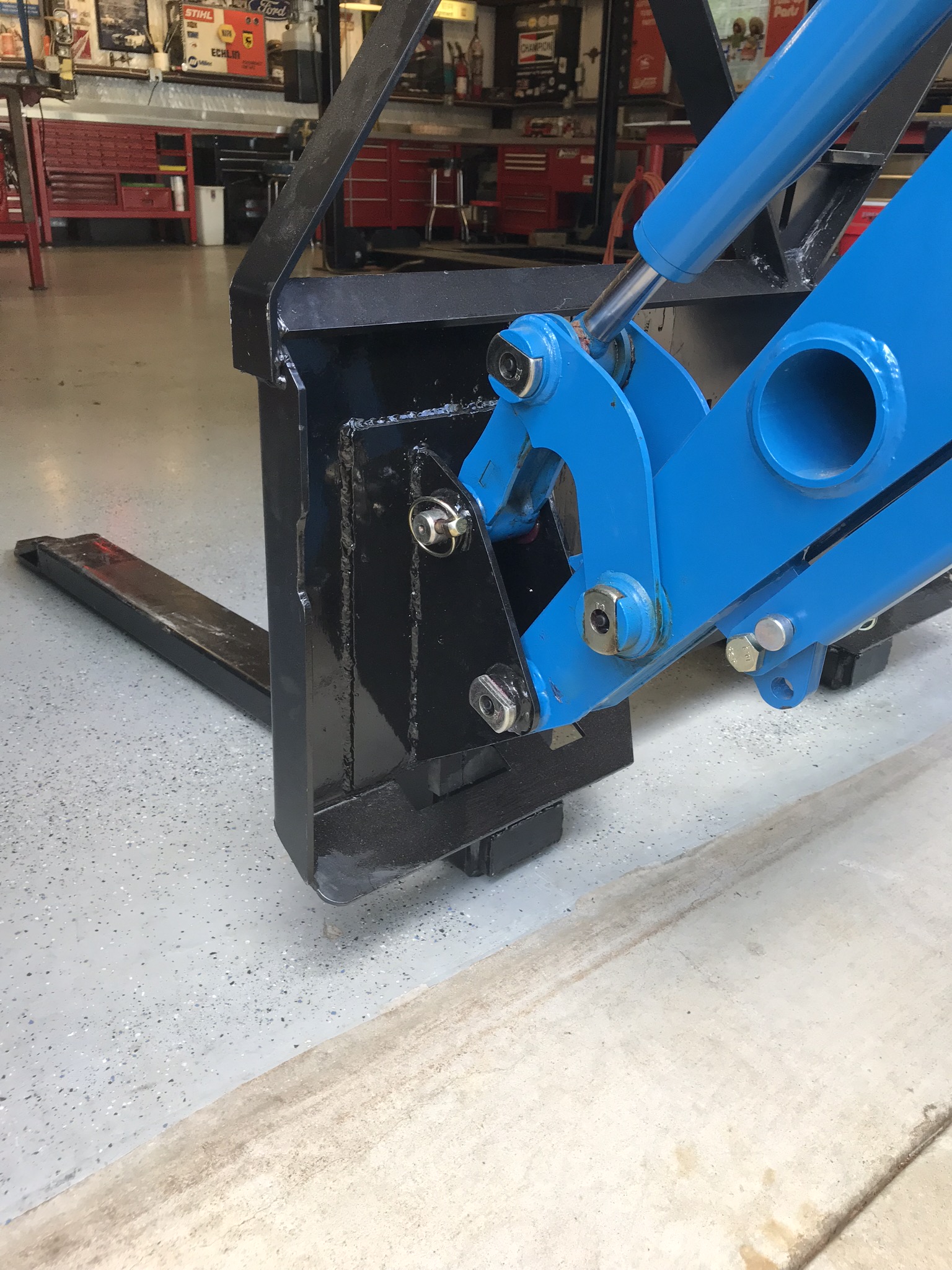

I have one ... but the geometry is off a little bit as it will not allow buckets attached to completely dump. It also will not work with the stock bucket. (edited to add last sentance)
/ Quick Attach for MT125 #22
Nope.....
So I copied the bracket setup off the bucket and made a couple of sets. So far I’ve just modified a set of Titan forks. Here they are ‘pinned on’ before the Quick attach.
View attachment 679724View attachment 679723
Hello MustangJames. I am told that my quick attach LS MT125 will require fork mods when I buy them. It appears that you have already dealt with this. Any detailed info would be great appreciate.
