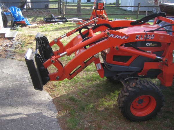

I think the original poster thought he could cut and weld it to fit the B7800. I also presume Horst makes a QA adapter that would fit the B series. They make one that fit the Kioti CK20.
