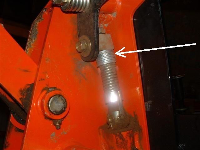

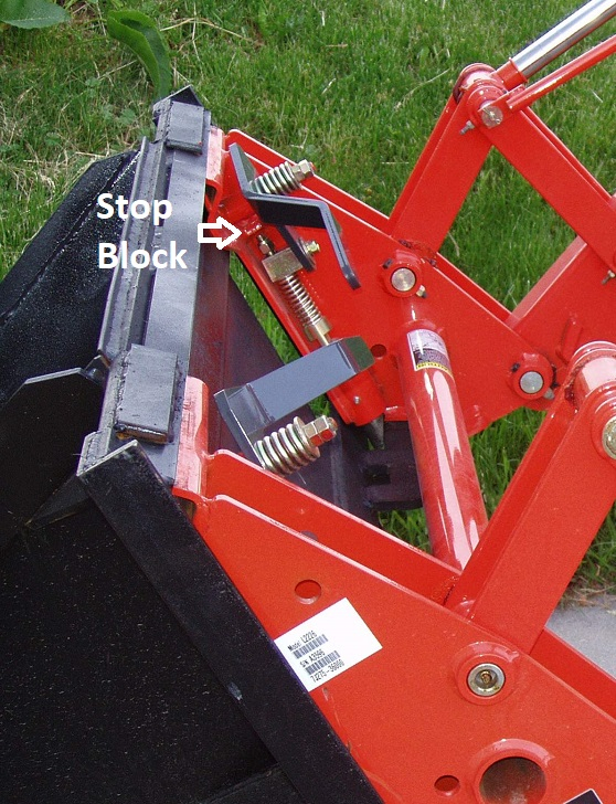

Some guys have added stop blocks so the pins can't be forced up with the levers down:

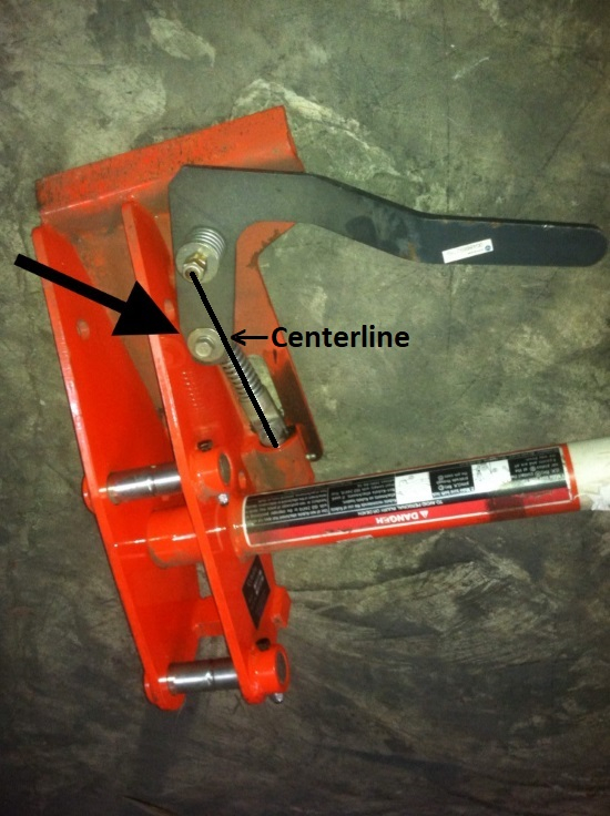

Also check that the lever is taking the top of the spring over center:
This prevents the pin from pushing up on the spring and raising the lever, unlatching the attachment and bending the tube.

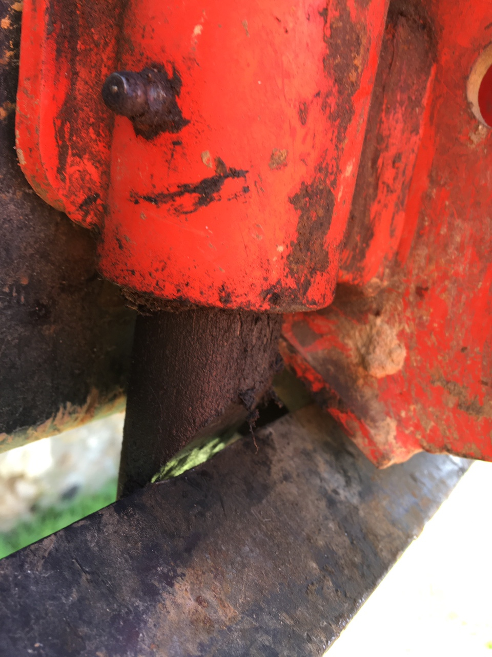

The other problem area is too big of a gap at the bottom, this is the main cause of bent tubes:
View attachment 733611View attachment 733612

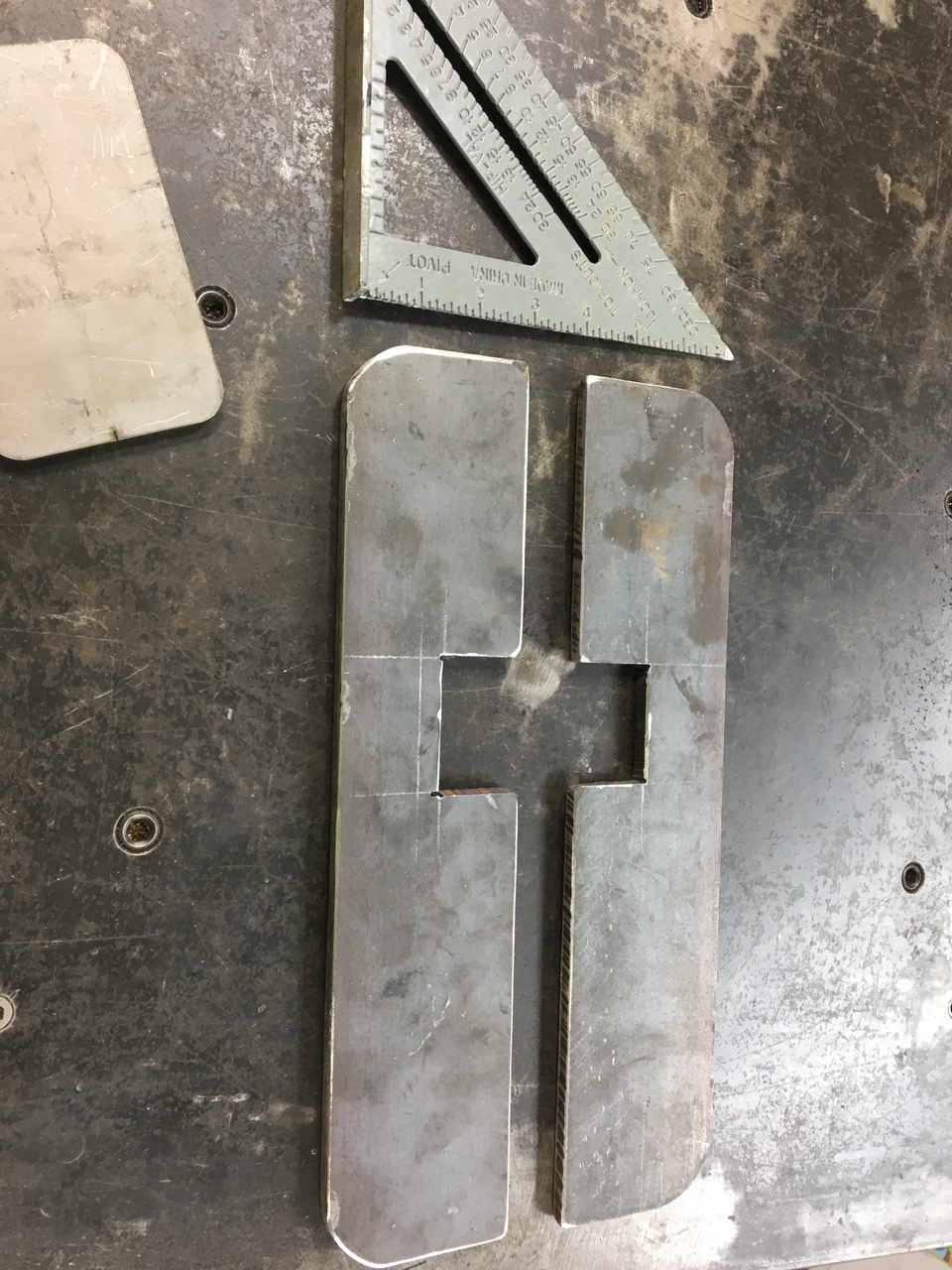

It can be corrected by adding a shim plate:
View attachment 733613View attachment 733614
That stop block is great! I will be adding those! That usually isn't my concern but having seen the pins bounce on hard shakes and having caught some limbs with the grapple on handles this will be useful.
Can you elaborate on the "Also check that the lever is taking the top of the spring over center:" how would you adjust this?
My lever does bottom out\touch the side of the bucket as pictured, and no gap on bottom of my kubota bucket I'm testing with and the pin still hops if I'm shaking it like I'm trying to unload sticky mud or clay.
Adjust by grinding the lever where it touches the frame so it can move farther over:
Washers can be added to increase spring tension if needed:
