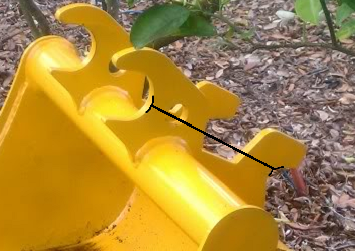

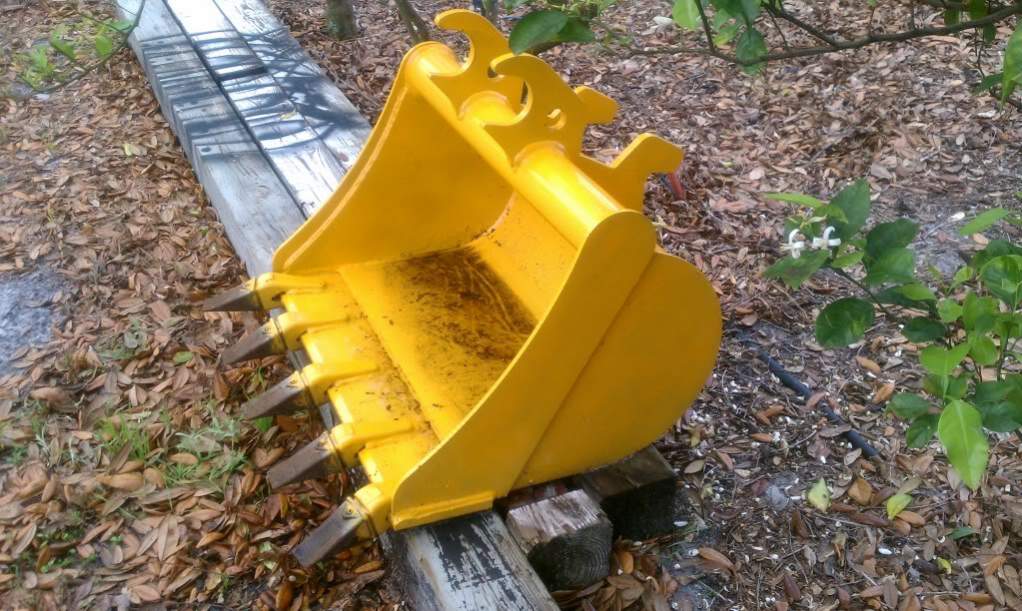

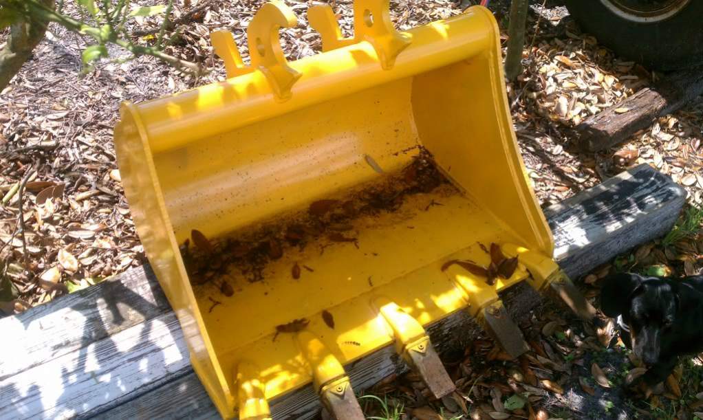

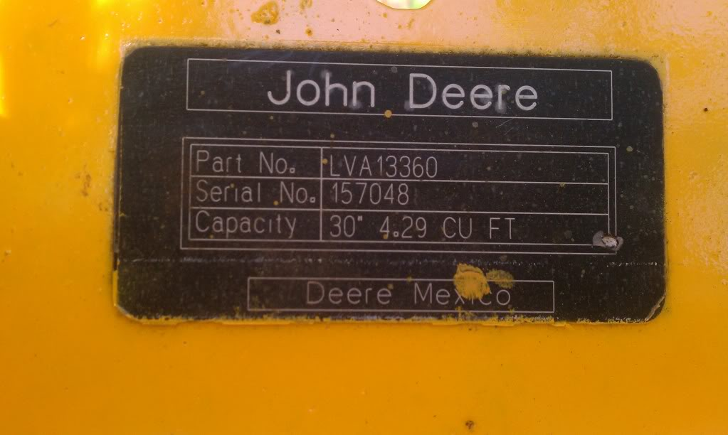

hello. I am looking to buy a 110 tlb, and came across this 30" bucket, whick looks like it would fit the 110, but the part # and cubic ft cap. does not match. Its a really good price, but if its not for a 110 with the quick coupler, then it would be nothing but a several hundred pound paper weight (that I would have to move by hand at this point) could any current owners give me measurements as to the outer (or inner width) of the two hook up 'rails' and also maybe the distance from the center of the round notch (up front) to the center of the beveled notch at the back. I would have to assume if the hook up width and lenght are the same then it should work. thanks to all who read and or reply. bucket1.jpgbucket2.pngbucket3.jpg

I just went out to the tractor and made a quick measurement in the dark. I got 9 7/16 on the outside and 8 3/16 on the inside of the mount. The bucket is on the tractor, but a quick(not exact) tip to center of the radius of the round mating section is about 2". I hope these measurement will help you. I did not measure from the center to the beveled notch. That bucket sure does look like the same design. hope it fits.

May I ask what you mean by there are two different models of adapters for the 110? Is it production date specific? Would they both look the same? Also I got a reply, but not really an answer from someone at johndeere.com/ parts help. They stated that they can not find that part # anywhere, so they feel it must be part of a 'package' or bundle, then proceeded to tell me they they (in the parts dept) can not look up packages/ bundles. I would like to thank you for the measurements you did get.

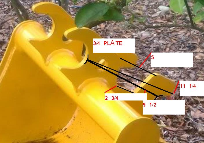

I would like to thank you (all) again very much for everything you have done. I have added a picture with a line illustrating the last measurement I would like. this should be the deciding factor. I guess I will just take my chances if there are more than one q/c styles. I am just concerned that this could be from a larger piece of equipment like maybe a med size excavator, and not be able to use it. I would not do any heavy digging with it, just some light scraping and shapeing, along with some other outside the box uses with it. please have a wonderful weekend everybody.

I hope this helps, if you want any other number just ask its no problem. I was looking closer at the mount and I think it would be very easy to make the two plates if you had to change the bucket. I would buy that bucket, you Can make it work if need be.

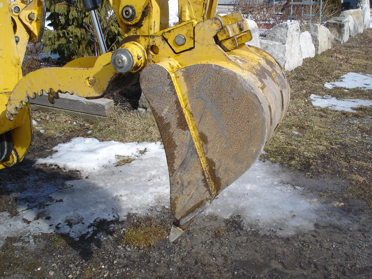

This is picture of my bucket for your reference.

thanks to all that helped. I picked it up today, and had just a slight amount of fun unloading and moving it by myself with no power equipment other than a little lawn cart. I cant wait till I can get the rest of a 110 to go with it.... here are the pictures to prove it, because as some have said "no pictures= didnt happen"
