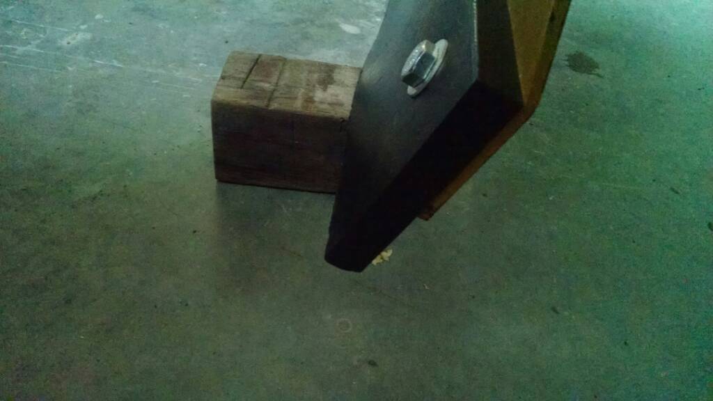

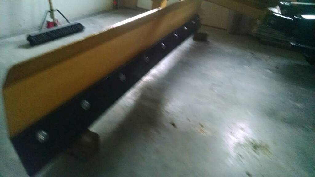

I bolted on a 1x6 piece of poly to the bottom of my back blade. I removed the steel edge and put the polyurethane in its place. IMG_20180226_172521300.jpgIMG_20180226_172540299.jpg

This works for me on gravel drives and on asphalt I can see blacktop when I'm finished.
