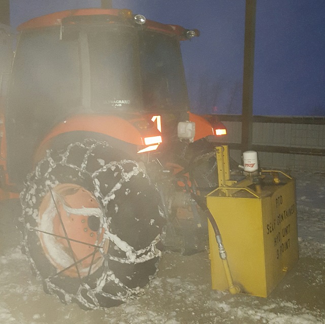

The tractor is bogging down as well when I get into heavy stuff. Everything is working freely when not under the load. I have 22 GPM from a 50T033-LTASB Cross Gear Pump. Specs on the pump are: Flow @540 rpm - 20.8 gpm * Flow @ 1000 rpm - 38.6 gpm * Rotation - Left Hand (from 50T033-LTASB Cross Gear Pump - Northern Hydraulics.).
I am not sure on the hose size (will get pics up in a few).

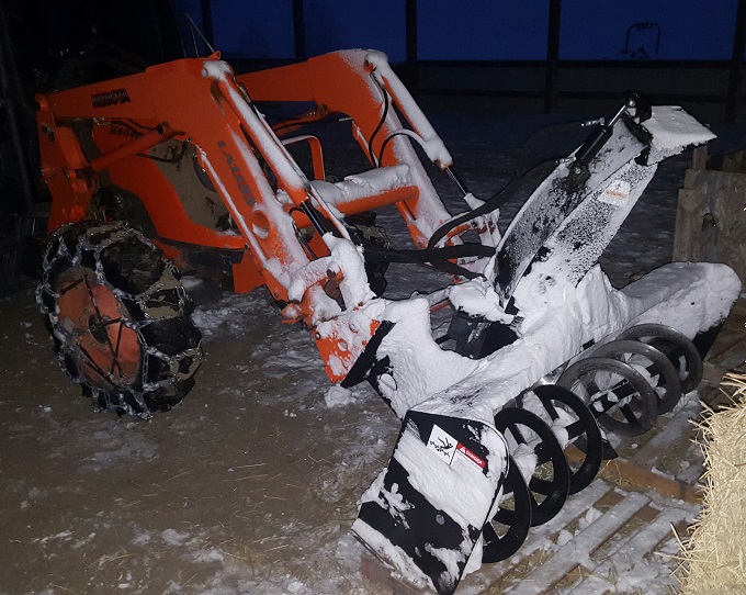

lungdoc - good suggestions! In my insomnia I didn't even think of the specs or pics. Here are the blower specs:
Model 2010 79
Part Number 900964
Stage 2
Width of Cut 79
Cutting Height 29
Cutting Edge 5/8 x 6 bolt-on
Auger Diameter 16 open flight
Fan Diameter 20 4-blade
Chute Rotation Hydraulic 270ー
Pressure Relief Fan/Auger
Casting Distance Up to 30
Shipping Weight 859 lb.
Mounting Plate Universal
Hoses Included
Hydraulic Flow?? 11-25 GPM
Operating Pressure 2500-3500 PSI

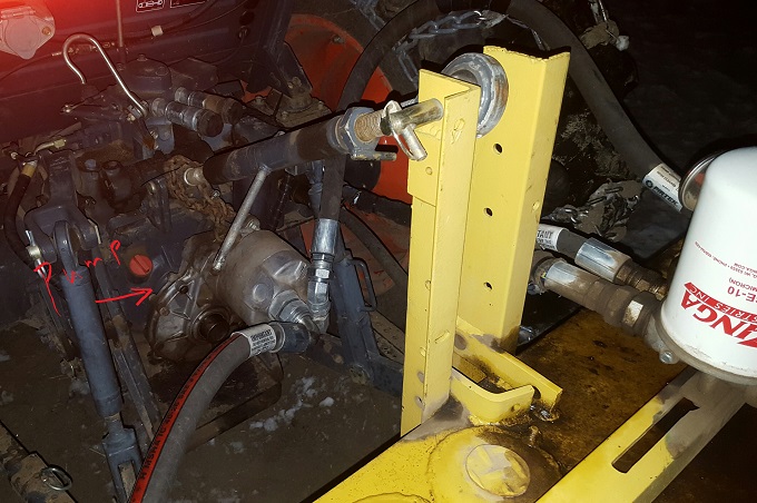

   / Questions on hydraulic blower on FEL
Pictures at last (unfortunately the wait didn't help the quality.

You have discovered the sad truth that hydraulic drive systems are far less efficient that mechanical PTO systems. Mechanical probably 95% of the input power is available for work while on hydraulic drives from 60 - 90 % depending on the quality of the components. 90% is a very good closed loop hydrostatic system with minimal pressure drop in the lines.
What pressure is required to run the blower under no load? You state the pressure jumps from 1000 PSI to 2500 PSI. Is the 1000 PSI with little or no snow going through the unit? If yes that is over a 1/3 of your power being used to just turn the blower.
Not trying to poo-poo hydraulic drives but some consideration needs to be given in hose sizes, quick disconnects (typically very high pressure drop items) fittings, motor style (some require 500 + PSI just to turn under no load) etc. Pressure drop is wasted power so the lower this is the more power you can use in the blower.
If you want this blower to perform at it's best I would suggest taking a few pressure readings at different points to where your losses are. I.e. at the pump outlet, at the inlet and outlet of the motor. These will give you an idea f what the losses are in the different parts of the system.
