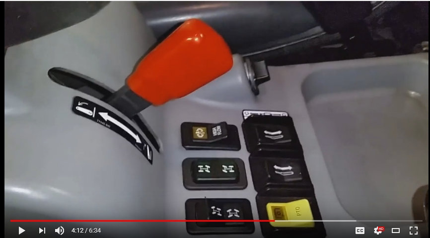

Hi I was wondering if you guys would be able to help figure out if my toolcat has hi flow or not. I have a 2010 toolcat 5600 d series. Doesnt say hi flow on the ram up front buy i believe the previous owner re painted it at one point. How am i able to determine if its hi flow or not.

The Operator Manual will show the location of the switch.
On my 5610 F series it was on the center console.

On my 2009 D series the switch in on the center console near the 4WS switch (in back)

Are you able to post a picture of the actual switch. Like are you talking about on the dash or near the switches near where your arm rests. Thanks.

Aft of the armrest.

Found a YouTobe video of a 2006 with High Flow, that showed the rocker switches behind the armrest:

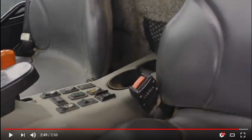

Found a YouTube video of a 2010 5610 with High Flow, that showed the rocker switches behind the armrest, High Flow is clearly labeled:
