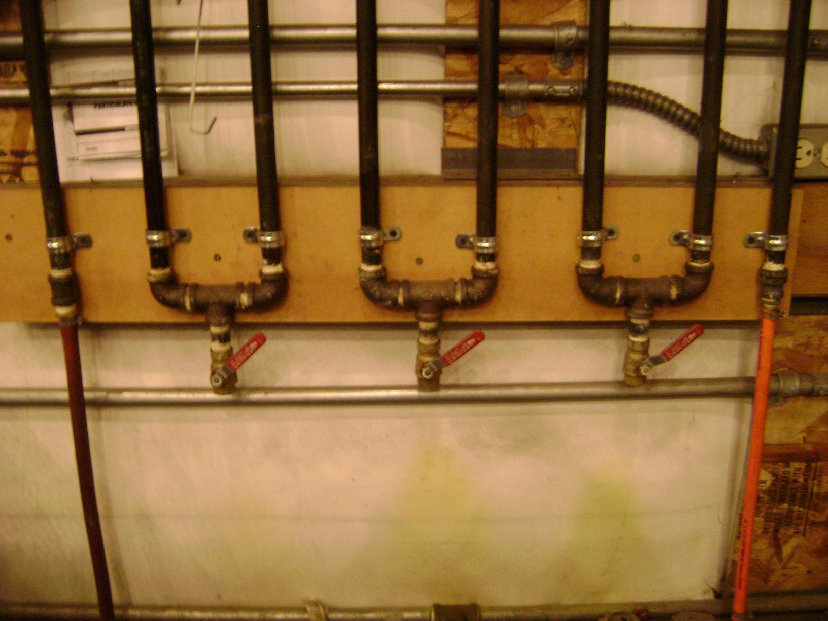

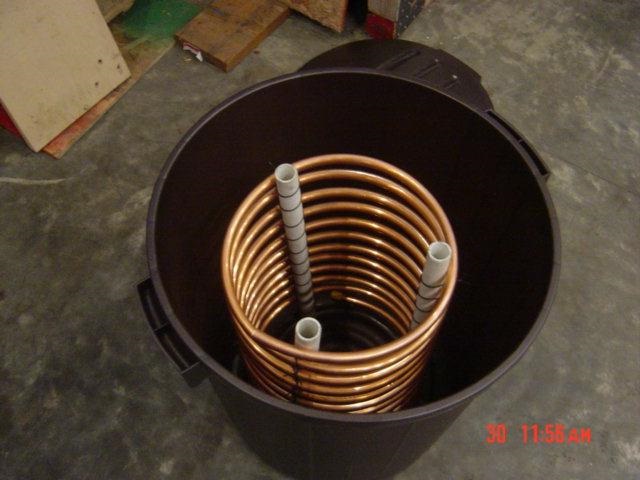

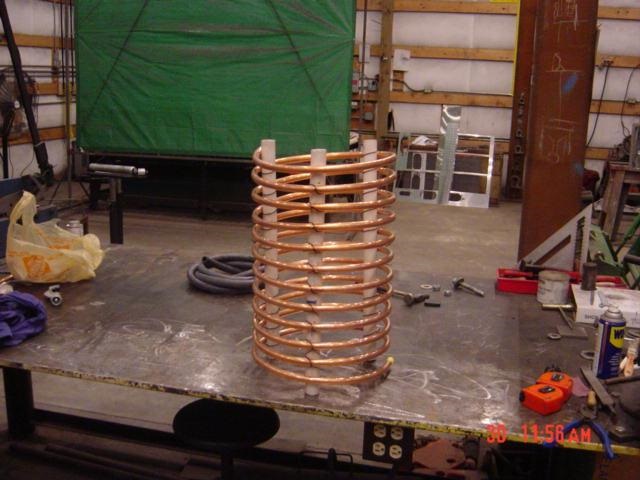

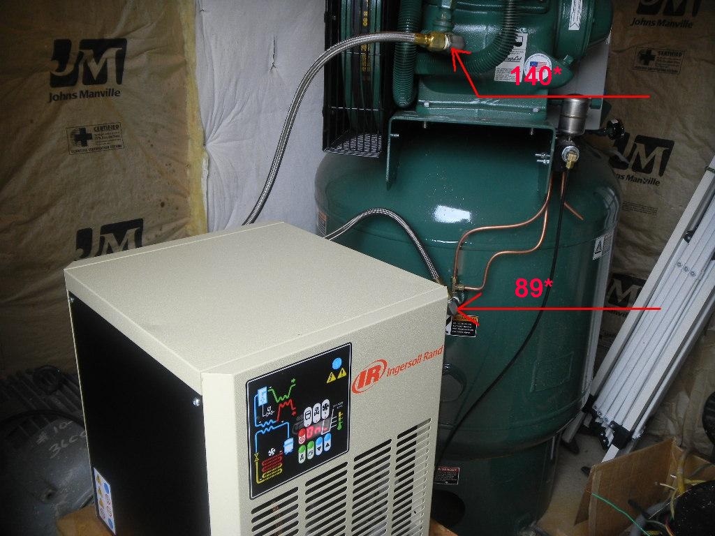

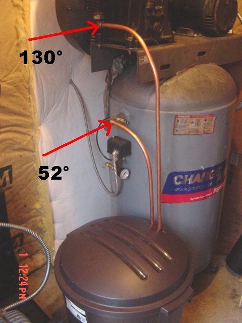

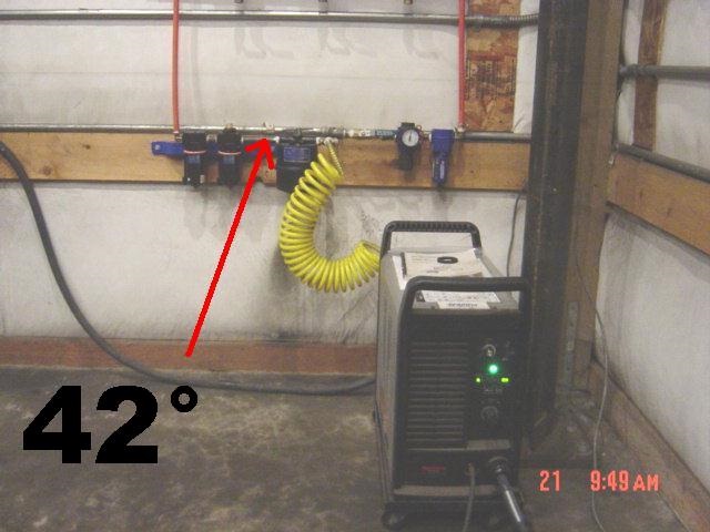

John if you're going to do a lot of cutting, and or painting. Think about building an intercooler, and after cooler. I took 50-feet of copper tubing, placed it in a plastic garbage can, filled the can with water. Then plumbed it to my compressor. Inside the shop I used pipe to build the after cooler. You can see how it drops the temperature of the air. That way it is dryer and saves on tips.
That's excellent! I'm definitely doing this!

I bought an Ingersoll Rand air dryer. Believe it or not the garbage can full of water works better! :confused:

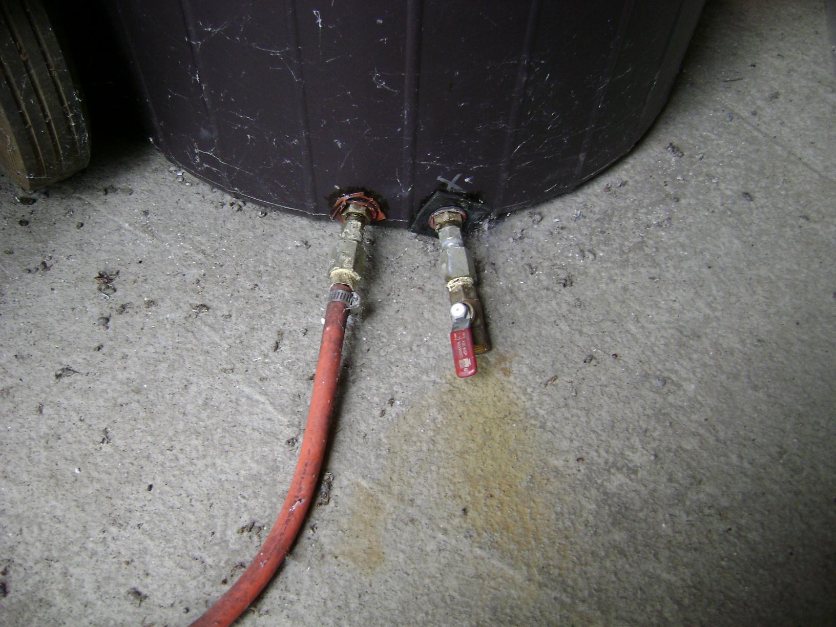

At the bottom of the after cooler you need to install ball valves, so you can drain the water out of the pipes. Also a drain at the bottom of the copper coils, to drain the water out.
