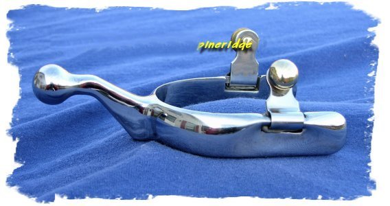

I am hoping to draw on the collective TBN knowledge for this problem. I seem to have a lot of problems taking pictures, especially those like the spur pictured with a reflective finish inside using artificial lighting. I usually use two halogen floodlights spaced 170 degrees apart and bounced off white umbrellas to eliminate glare. Both lights are connected to independent dimmers so that I can add or subtract brightness as needed. Most of my shots seem to come out much better inside if I do not use flash at all. but a blue background actually comes out as a brown so it seems like the camera is not actually picking up true colors.
I really have no complaints for shots taken outside the home. The attached picture was shot outside with natural lighting and the blue background color is correct and there is not a noticeable reflection of light within the chrome of the spur. Can anyone recommend to me some decent lighting strategies for indoor use that will still crank out some decent pictures? Winter is almost here and a trip outside to take shots is no longer practical (I hate long underwear). /forums/images/graemlins/grin.gif

Simply using umbrellas won't diffuse the light enough to eliminate glare on reflective objects (like chrome). You're going to have to either use diffusers or a photo tent (basically a box with thin white cloth/material on all sides, with only a small opening for the camera to shoot through).
But beyond the diffusion of light, your main problem is other reflections appearing on your object, and also having outside light affect the photo. You have some blown highlights and major reflection of what looks like a house! /forums/images/graemlins/smirk.gif
The purpose of the photo tent is to fix all of these problems, as it blocks out all outside objects that can reflect (like a house). Here's one from B&H for about $55.
You place your lights on the outside of the tent (top, sides, back) and shoot through an opening. For the opening you can either remove an entire panel (as shown) or use a panel that has a zipper hole for objects which would reflect the image of the camera onto them. If you need a variety of angles, removing an entire panel is best, but you can't apply light from the front unless it's diffused by some means.
For best results I shoot in a completely white room with all lights off except for constant photo floods. I've found that two 250W 4800k floods aimed at the sides of the tent give plenty of light, but I do need some exposure compensation at that.
I just got some 500W 3200k bulbs that I'll use when more light is needed. 3200k will be ok because my camera has excellent white balance control, but if your camera has a hard time adjusting to the slightly yellow tinge, you might have to do more post-processing and color correction than you would with 4800-5100k bulbs. So, 500W 4800ks would be great.
Hope this helps...

Although they appear like they put out white light, halogens actually have a terriible color spectrum. Go to a photo shop and get the photobulbs recommended by Muhammad - even better, take your camera in and try some of their lights with your camera

The 4800K (Kelvin) is a rating of color temperature. A blue sky with full sun is rated around 6000 degrees K. Ideally you would want a light source as close to 6000K to replicate sunshine. Typically 4800K is about as close as you can get. There is another option and that is Florescent lights rated for daylight photography. These are very specialized lights and can only be bought from a lighting distributor. They aren't cheap, but they are very nice for shooting small objects as they don't have the "hot spots" that tungsten or halogens have. Using the flourescents with a light tent will give very nice results.
A light tent can be very easily made with white sheets, or white window shades, or even white translucent Plexiglass. As with most things, there are many ways to achieve your goal, but the best way is plenty of practice shots. See what looks best to you.
