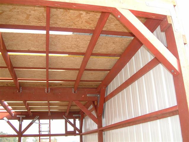

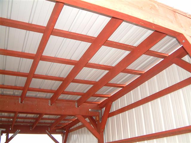

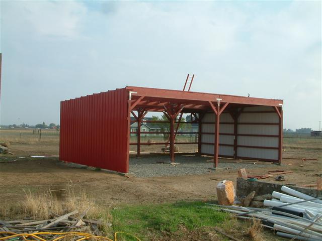

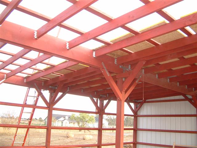

I used 2x4 purlins across the rafters on my 20x28 shed. It's the correct way to install a metal roof.

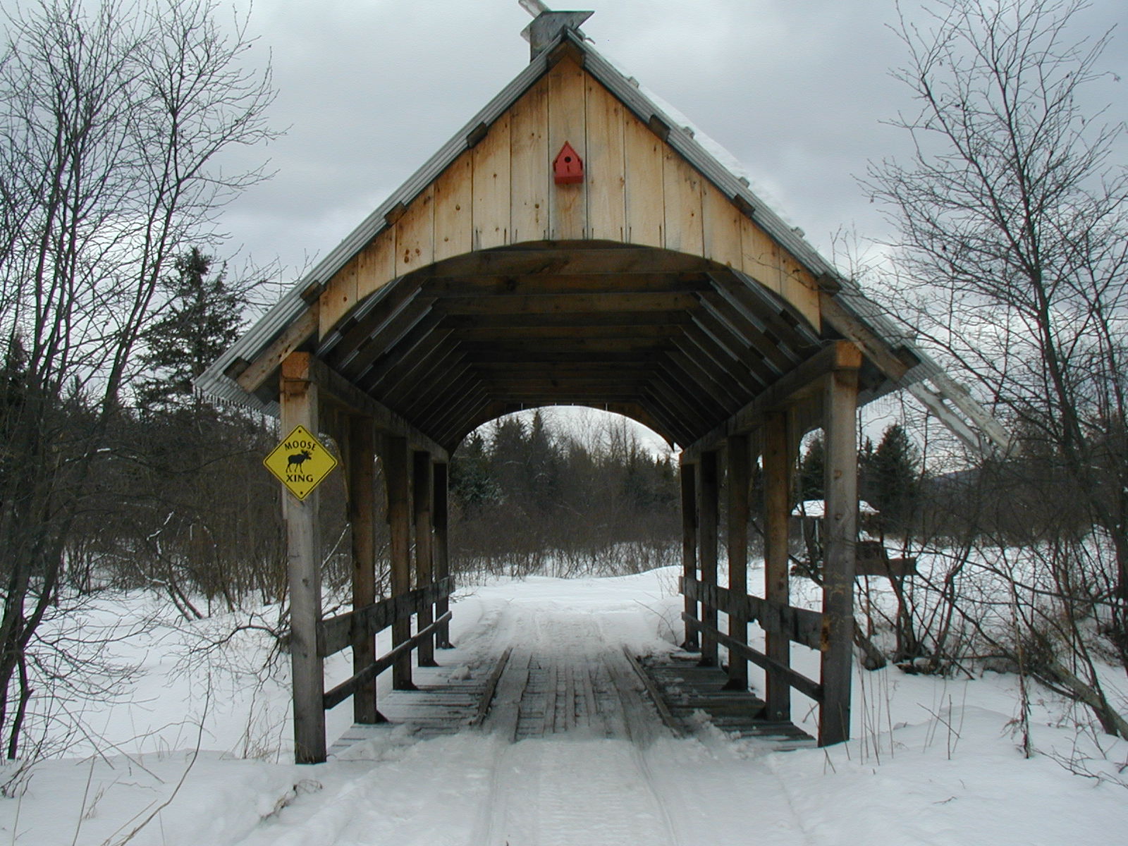

Don't underestimate the snow in your area. It doesn't cost a lot the build a good shed. Build your own trusses with 2x4s -24" OC, 6" or 8" pitch. Whether a cheap building falls on snowmobiles or woodpile it will be a total loss. The size of the purlins depends on span & spacing. Excess span a/o excess spacing will result in sagging/buckling ultimately reducing longevity. Money saved by spreading the purlins can be wasted if you have to walk on the roof & it gets damaged. Especialy important when ice/snow falls from one roof to another, ie from a main roof onto a leanto. My barn has 50' trusses spaced at 40" with 2x4 purlins spaced 24", 5/12 pitch. It will & does hold 2' of dry snow. My bridge has 2x4 rafters 24" oc 12/12 pitch &1x5 purlins 24"oc & no snow accumulates on it. In all cases the metal roofing is attached with gasketed screws.
Tallyho, With all due respect - your carport wouldn't last past the first lake effect snowstorm in the OP's area. Take a look at their snowfall numbers & compare to LA. NWS Buffalo Climate Information - Buffalo Monthly Snowfall (2000s) MikeD74T
