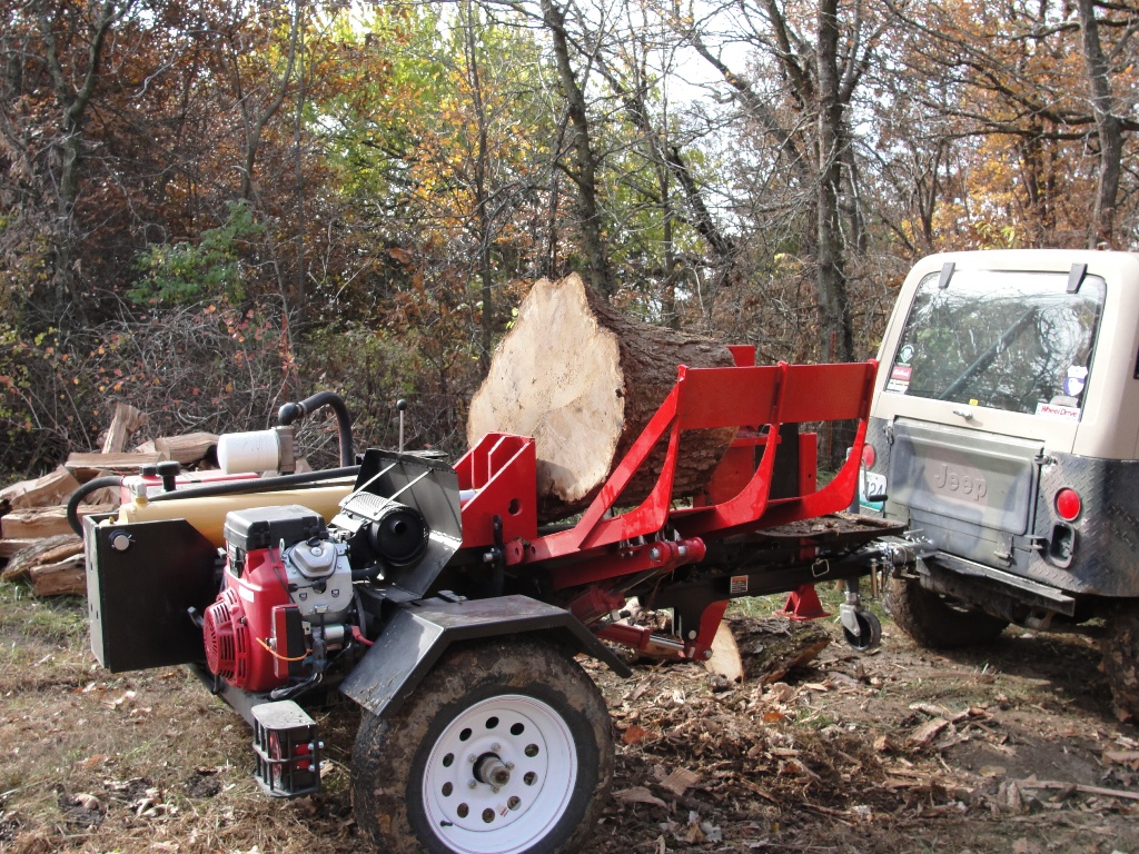

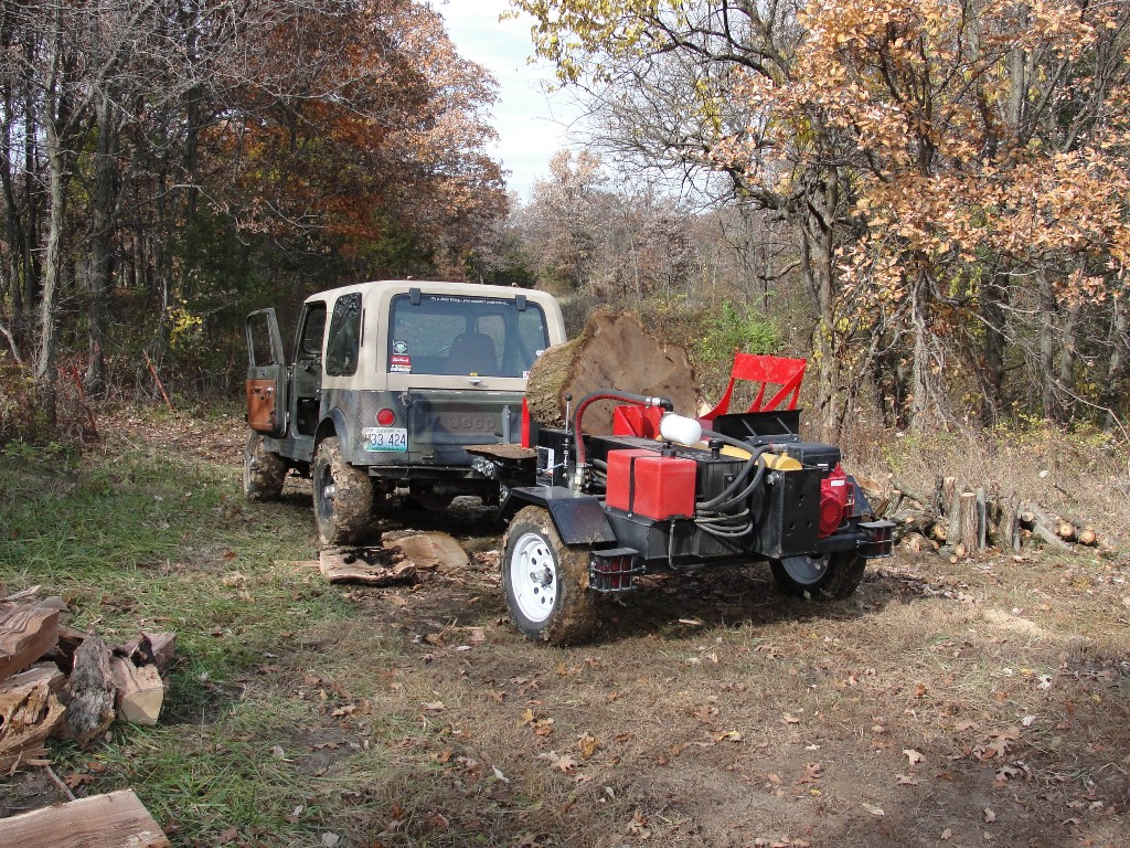

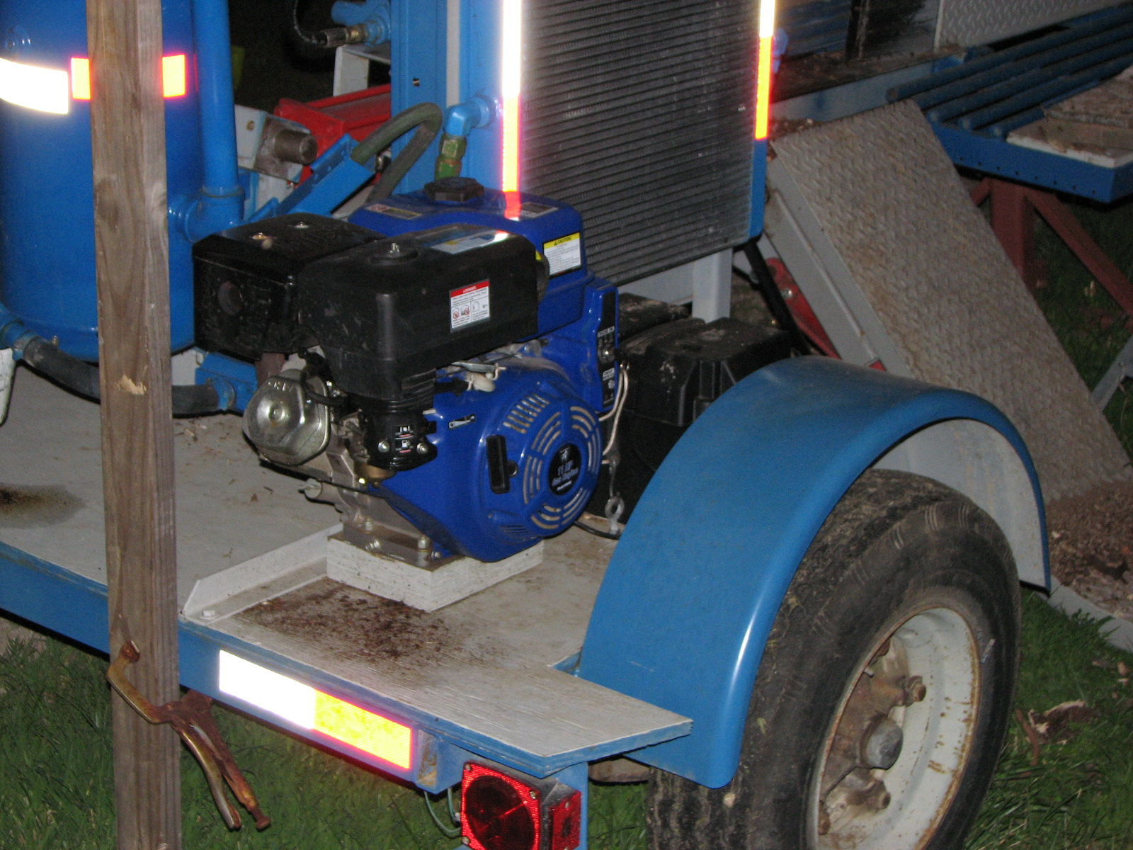

Hi Jim, This reply may come to late, if so I would be interested in hearing what you did and seeing pictures. This is what I used in building mine:
- 11 hp Greyhound electric start engine from Harbor Freight, works well, starts with 1 pull manually (even my daughter can start it), run it at a fast idle
- 4" x 24" cylinder with a 1.75" rod 2500 psi for splitting
- 3" x 10" cylinder for log lift
- Haldex 16 gpm 2 stage pump
- Oil cooler off an old rotary air compressor (Has 3/4" inlet/outlets)
- 8 gal reservoir with 3/4" return lines
- 4 Energy hydraulic valves in series (Have a 20 gpm flow and the main bodies are milled the same. This allows you to change the configuration of the valve without re-plumbing/removing. This was very handy when I found out I could not place 2 of the C-908 "Wood Splitting" valves in series. on the maiden voyage, when the 2nd stage of the pump kicked in, the log lift started to raise. I found out when I call the company - NO Holding! Yes!!!, that the C-908 wood splitting valve could not have another valve following it. I was able to take the end cap and spool out of the main body and replace it with a double spring return valve in less than 5 minutes. I did consider the Prince auto return valve, but did not feel with the configuration I have, it would be worth the money. The 1st valve splits, 2nd valve lifts logs, 3rd valve will run drive wheel, 4th valve will raise and lower drive wheel which will double as a jack stand. I may add a 5th valve later to allow for a steering cylinder. I am still thinking on it.
- Added a log lift instead of a Davit/winch setup. I can load the lift with wood to split and turn the engine off during re-load periods, cuts my fuel use in half. If I had went with a larger cylinder which would have allowed for a multi-split wedge, I would have added a davit/winch to allow for lowering the log for multi passes.
- Most of the wood I split is 3' or smaller. I have a wide variety of species to include elm I use. I did not attempt to build a 4 way as most of the wood I split is full of knots and I would not have had enough tonnage to handle one.
- I have tables for the out feed which will fold up for transport. Once the wood is loaded on the log lift, it doesn't hit the ground unless I am puposely building a windrow. The drive wheel will allow me to back away from the pile as I go.
- I purposely built a wider wheel base - 5' between fenders to allow for better stability when lifting large logs and pulling a 12' trailer behind it. I have had no problems with this set up.
- I used a mobile home axle I had around. I have several trailers I have built over the years with mobile home axles and have never had a problem with them. However new laws prevent building new trailers with them.

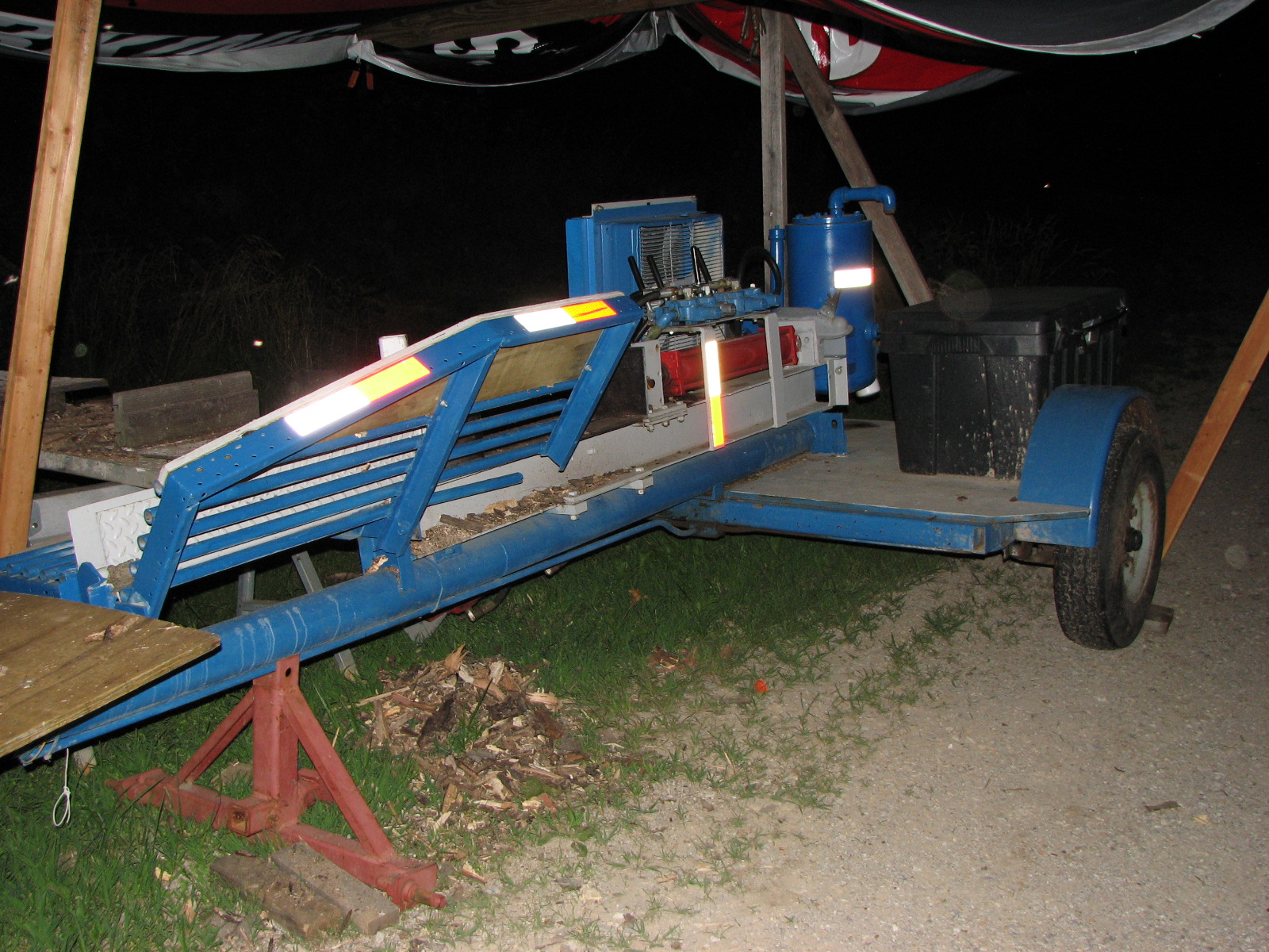

Jim, Here are some pictures of my splitter. I took them at night to send to my son at the Air Force Academy so please forgive the quality. For some reason, I was not allowed to attach them to my last post.

Hey in photo 4 just behind the ram there looks to be a trailer coupler,is it just sitting in the pic or does it have a purpose.
I have been trying to work out what it does cheers
   / Questions about log splitter build - size of parts... #8
Good eyes, that is the coupler for the splitter. I designed it so I can screw (1.5" bolt) a 2" coupler or an eye bolt into the tongue so it can be pulled with a pintle hitch as well. An added benefit is I can put the coupler in the cab and decrease the risk of someone driving off with it.

Now that I've had a splitter for 5 years now what I can tell you is this. I would rather have the wedge on the saddle than the push plate. I often split logs more than once to get some smaller pieces. The push plate pushes the wood off of the back requiring you to pick it up at least two more times (each split piece). Secondly if you split for any length of time the pile of split wood gets big. If it's just falling off of the back of the splitter you'll need to stop and move the splitter often.
With a wedge on the saddle once they split you can toss them where you want or resplit them much easier. Secondly although I can stand up my splitter to split large logs I use the front end loader to hold several large logs and place it so I can just roll them right onto the splitter.
I can't agree with these statements. The fix for you problems are shown in Oliver's pictures. A catch table is a must on a splitter regardless of who built it. Also moves the wood away from the operator where a second set of hands can pile/load the split wood without getting dangerously in the way.
I first built a PTO ran winch and now use a trailer mounted/gas powered. Each have an advantage.
I never considered the tach hours on the tractor. I'm sure the tractor engine has a tremendously longer lifespan than the little gas powered engine, that's a no brainer to me.

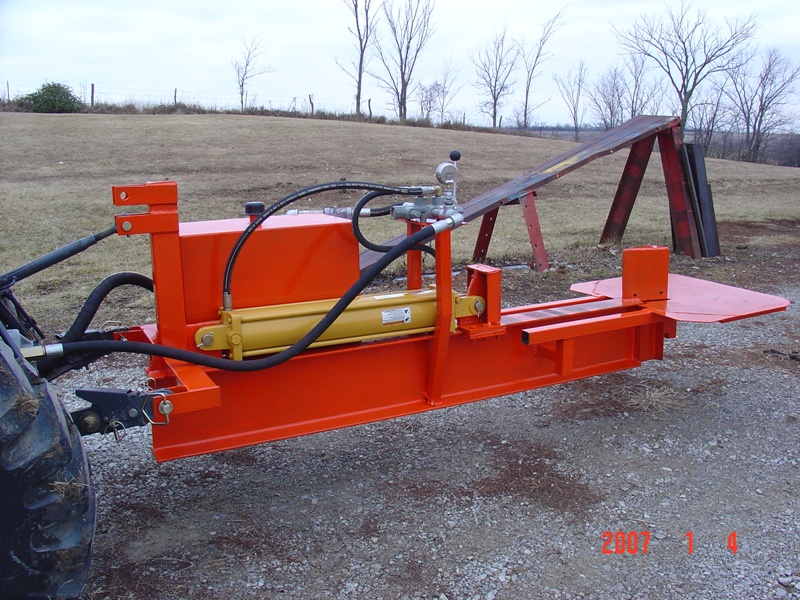

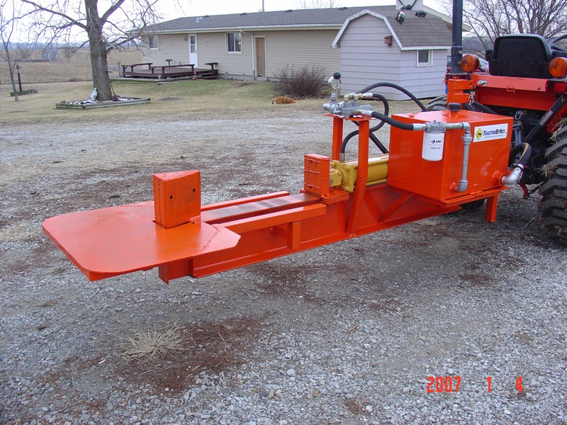

Here's some pics of my two splitters.
