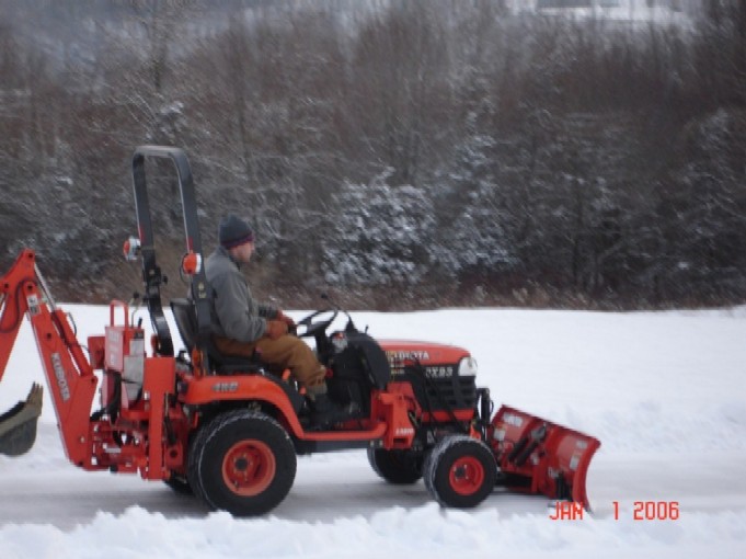

Zick:
This is my blade in action. Enjoy yours, it is an awesome tool.
Alan

Sweet!
Those are turf tires right, any problems with traction without chains?

Zick:
Yes, I had turfs on my BX23, traction was never a big issue. I could generally push just as much as I wanted, even up hill. Certainly with those rainy slushy icy events it slipped around some but it got the job done without too much trouble. What I found was that the rears lost traction much less than the front of the machine got pushed around with the blade angled, sometimes I used the blade to steer the tractor.
I have a 13% slope with a hair pin turn on one part of the driveway, because my house is above the road the first pass was always a full blade right down the middle. Then I angled the blade max to one side and went up and down.
Occasionally coming back up I would get sliding pretty good and would just take less of a bite and come back down taking more.
Good luck, we've had no rain here this year, let's hope we get some snow.
Alan

1*I left my BH on for ballast and never had serious traction problems.
AMR
