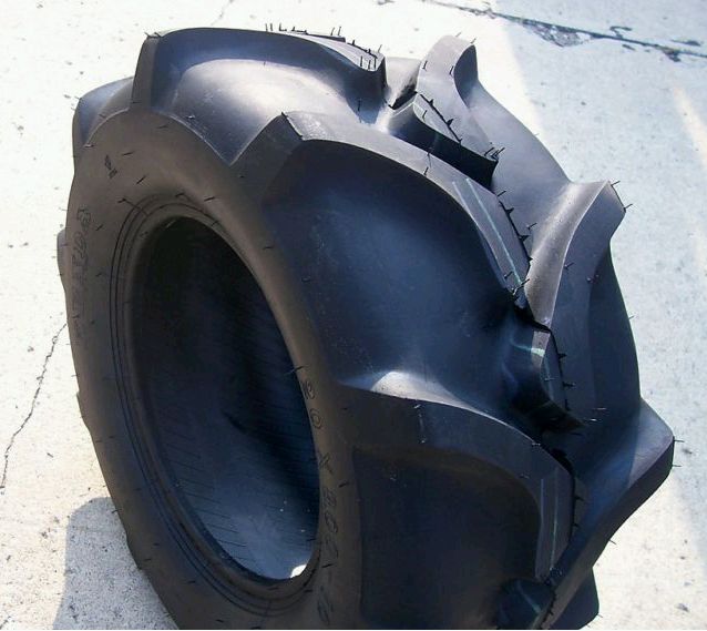

A neighbor (no computer/internet) is interested in having a second set of wheels/tires for an older model Kubota B series, one turf tread the other ag treads.
He has found a set of new Kubota rims that are two piece bolt together but they are only 5" wide. The ag tires he is considering are recommended to be mounted on 6" rims.
Is it feasable to use washers or another type of spacer to expand the rims to 6"? He understands that these rims will require tubes. Another question is if the above is feasable what if anything could or should be used to "lap the gap" in the center of the rims? He suggested duct taping a piece of old inner tube.

I understand but it is much easier to switch out wheels/tires than it is to remount tires and there is a huge difference in the treads. Also the turf saver tires will wear out very quiclky on gravel surfaces and the ag tires will tear up the yard.
The turf tires are typical Carlisle "Ture Saver" however the AG tires are something else:
