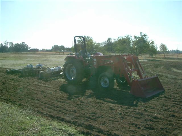

Disc it and then drag a log, steel pipe or something heavy to bust up the clod.
Here's the setup I use on my 6-acre hayfield.
It's an old 6.5 ft wide Towner offset disc with a bunch of tires the function as the drag. Got the disc free from a neighbor--replaced about 10 of the discs (called pans), lubed it and it's works like a charm.
