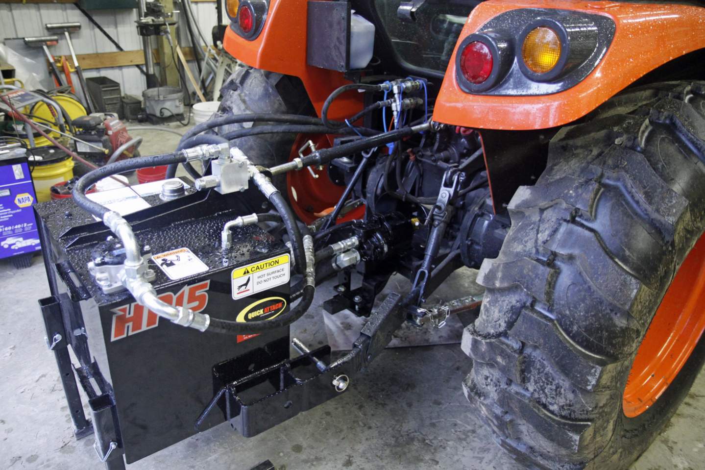

my pto pump has a 25 gallon reservoir tank. I didnt need a cooling fan as i use it in winter time only. for summer use you may need a cooler unit. The fluids get hot. Not cheap by any means. heres mine powerpack 1.jpg. i got mine from Hydraulic Power Unit : Quick Attach Attachments, Inc.
good luck
