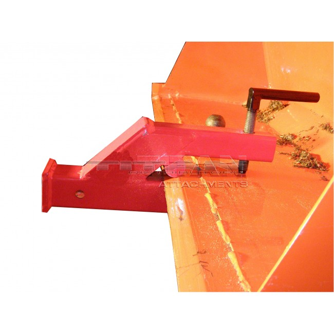

I just use one of these when I need to move my trailer. I did cut a couple of 2x4's to wedge on each side to keep it from swiveling if I make a tight turn.
   / Question On FEL Step Bumper Trailer Hitch #16
A clamp on is my backup plan. Great idea on the 2x4. The pivot/swivel issue seems to be the biggest complaint on TBN.
Anyone use a clamp on with a Pirhana Tooth Bar? That stays on the loader most of the warmer months.
