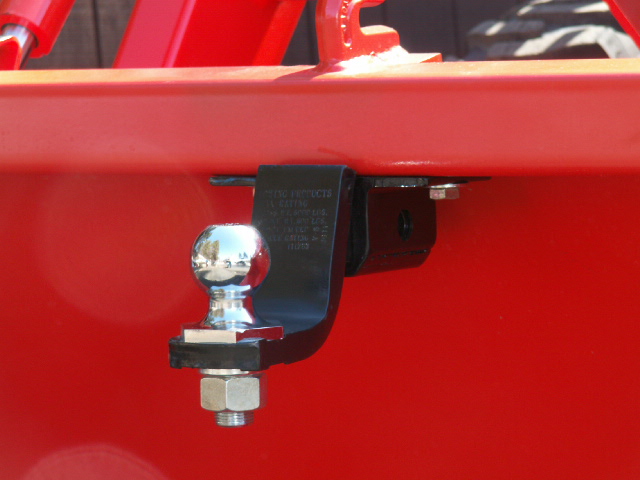

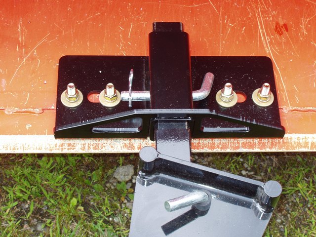

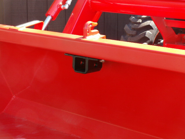

I bolted mine 3/8 steel plate top of bucket for support, when done w/hitch remove place cover plate...works great.

bottom of the bucket, with an extra plate below for strength.
