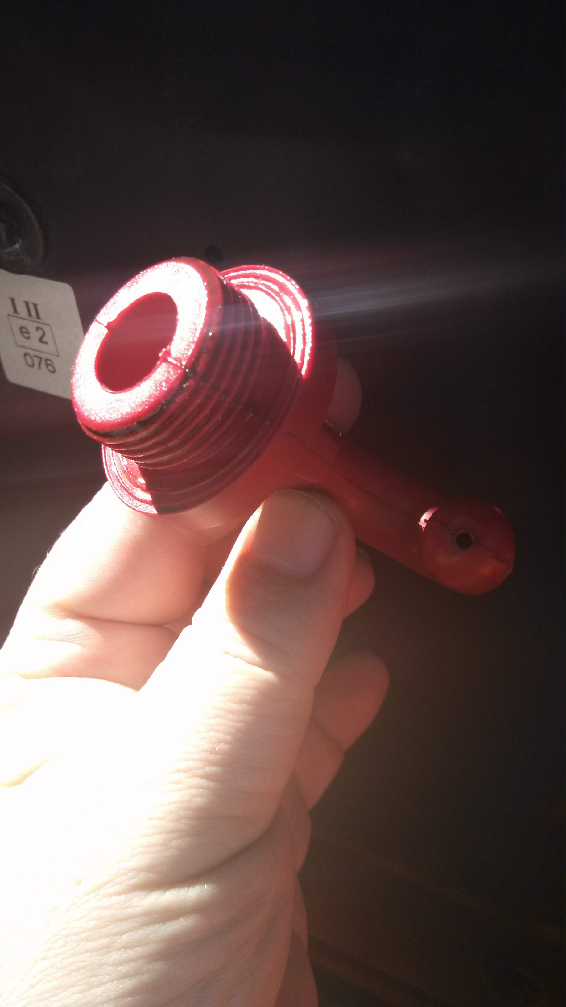

I did the whole banana at 50 hours, and as others have stated many don't change their hydraulic fluid until 400 hours. There is a conflict between the owners and service manuals is one reason for the two different approaches to this. I would disregard the dealers advice on not changing the front axle fluid. I would change it at the 50 hours, and did just that. Don't forget that sometimes manufactures do not clean out the machining swarf out of castings all that well, and there is NO filtration in the front axle at all, so any particle in there are just bouncing around in the fluid. Be prepared for difficulty getting that stinking hydraulic filter off. That's the one by the right rear tire. I recommend a chain wrench. I had a heck of a time getting it off the first time as does everyone. They have a special gorilla tighten that one up. I didn't have any problems with the engine oil or hydrostatic filters.
If you change your main sump hydraulic fluid be sure to get the two drains by the rear tires to drain the final drives also as well as the large 32mm main drain plug.
Of course you will not need to worry about how to prevent fluid loss when you change the filters if you choose this option. BUT if you choose to not drain the main sump and just change the filters, you will need a strategy to not lose fluid while changing the hydraulic filter. You know, the one the gorilla put on by the right rear tire. There are 3 strategy's, I will outline here.
1: the vacuum cleaner to the fill port. This sucks air in when you loosen the hydraulic filter and helps prevent oil loss out the filter ports as air is going in the filter ports so oil cannot get out.
2: My own idea, which worked perfectly at the last filter only change of screwing a no. 8 machine screw into the filler/vent crook hole. this prevents air from entering the top of the "tank" and if air cannot get in to the top of the tank, then oil cannot escape out the bottom of the filter ports, or very little oil can get out. I lost about 2 ounces of oil. DO NOT forget to remove this screw, if you don't it will blow the dipstick out of its hole when you lower the lift cylinders. Don't ask how I know this.
3: Just be darn quick in getting the old filter off and getting the new filter screwed on.. This is what most mechanics use, because they don't care that it loses about a gallon of fluid, they just top it off and charge you for the fluid.
Good luck in whatever you decide.
   / Question on DK45SE HST 50-hour Service #7
Here is a picture of the fill port stopper/ crooked air vent plug that I stopped up with a no. 8 machine screw. It is on the back of the tractor .
   / Question on DK45SE HST 50-hour Service #8
That James is always "screwing" with something! :laughing:
   / Question on DK45SE HST 50-hour Service #9
   / Question on DK45SE HST 50-hour Service #10
Always searching for a better way to "skin the cat":)
This method of blocking off the air vent beats the heck out of just trying to change the filter really quick, and the one time I tried the vacuum cleaner trick, it worked but when the air bubbles come up thru the tank and burst, you get the oil spray sucked up into the vacuum cleaner, which yuk's it up.
